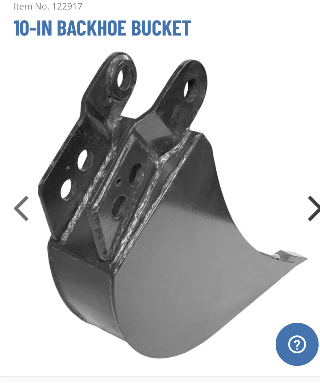

Need a bucket to dig trenches and my 18” bucket was a little wide for that. Couldn’t find any trenching buckets for my Woods backhoe so I

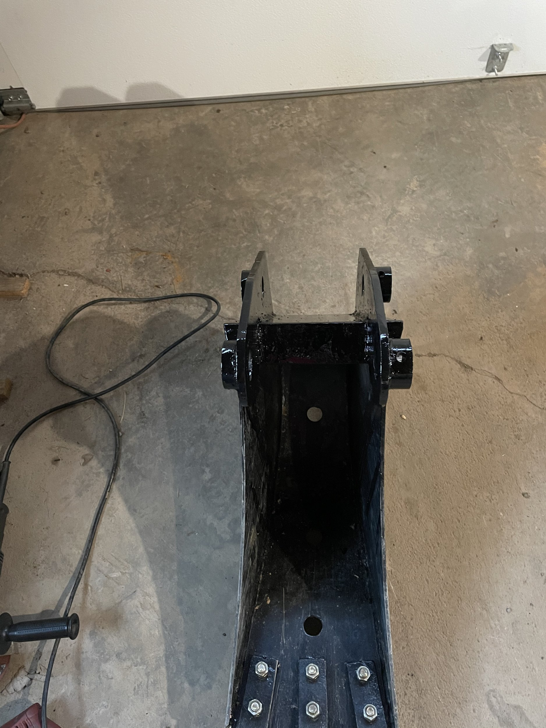

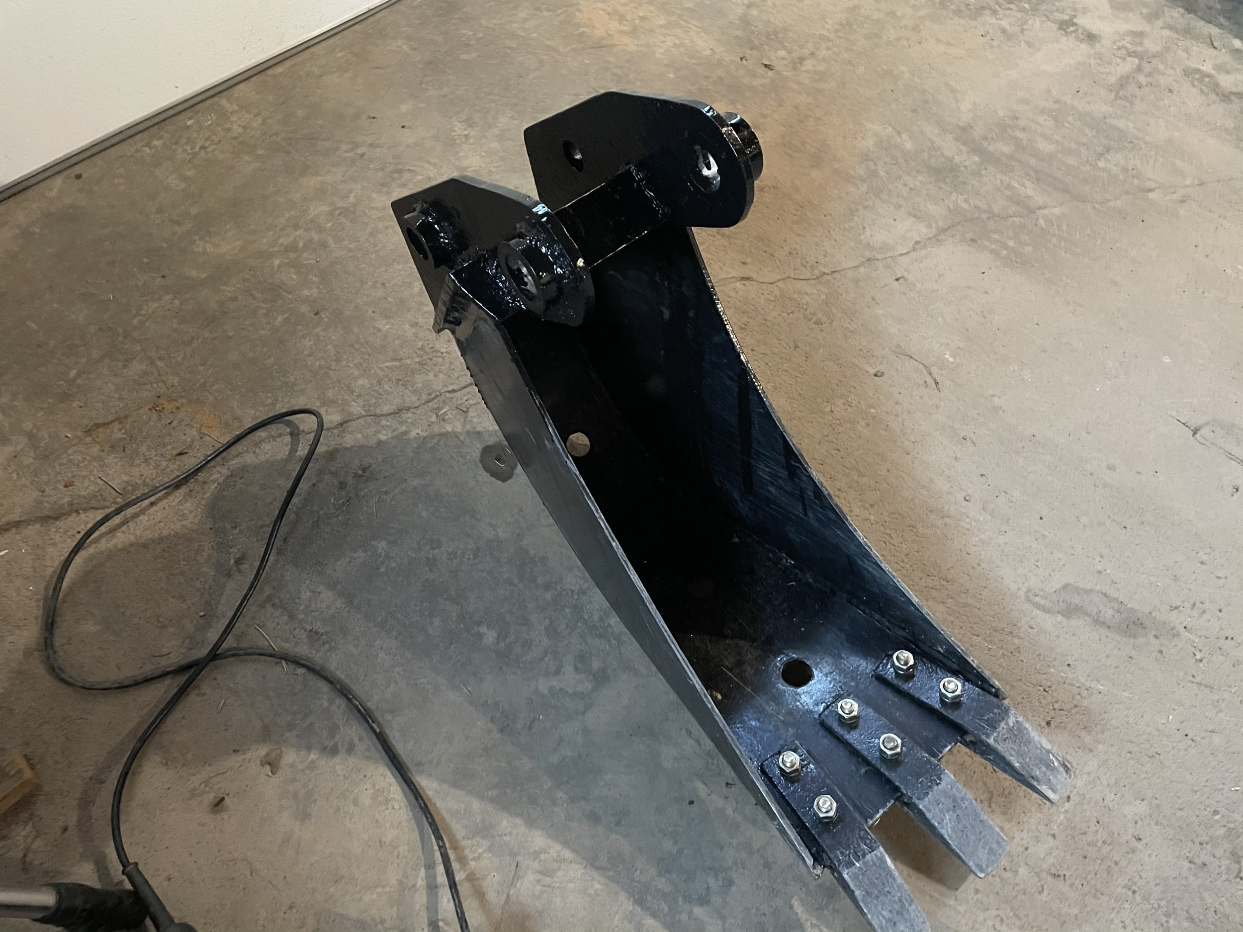

bought a Titan 10” bucket on sale for $200. Cut the ears off and cut out new ears to fit my backhoe.
Man do I suck at welding but it did the job.
Tested it out today and to worked pretty good.

/ 10” backhoe bucket
The guy using our MiniX on a project emailed me to see if I could get him an 8" bucket. Came up dry a couple places, and finally one of the parts guys said "Good luck finding an 8" bucket. The dipper stick won't fit in an 8" trench".
Looks like you may run into some bushings rubbing the trench walls.
the bucket is actually tapered. It’s 10” by the teeth and about 8” where the ears are mounted.
