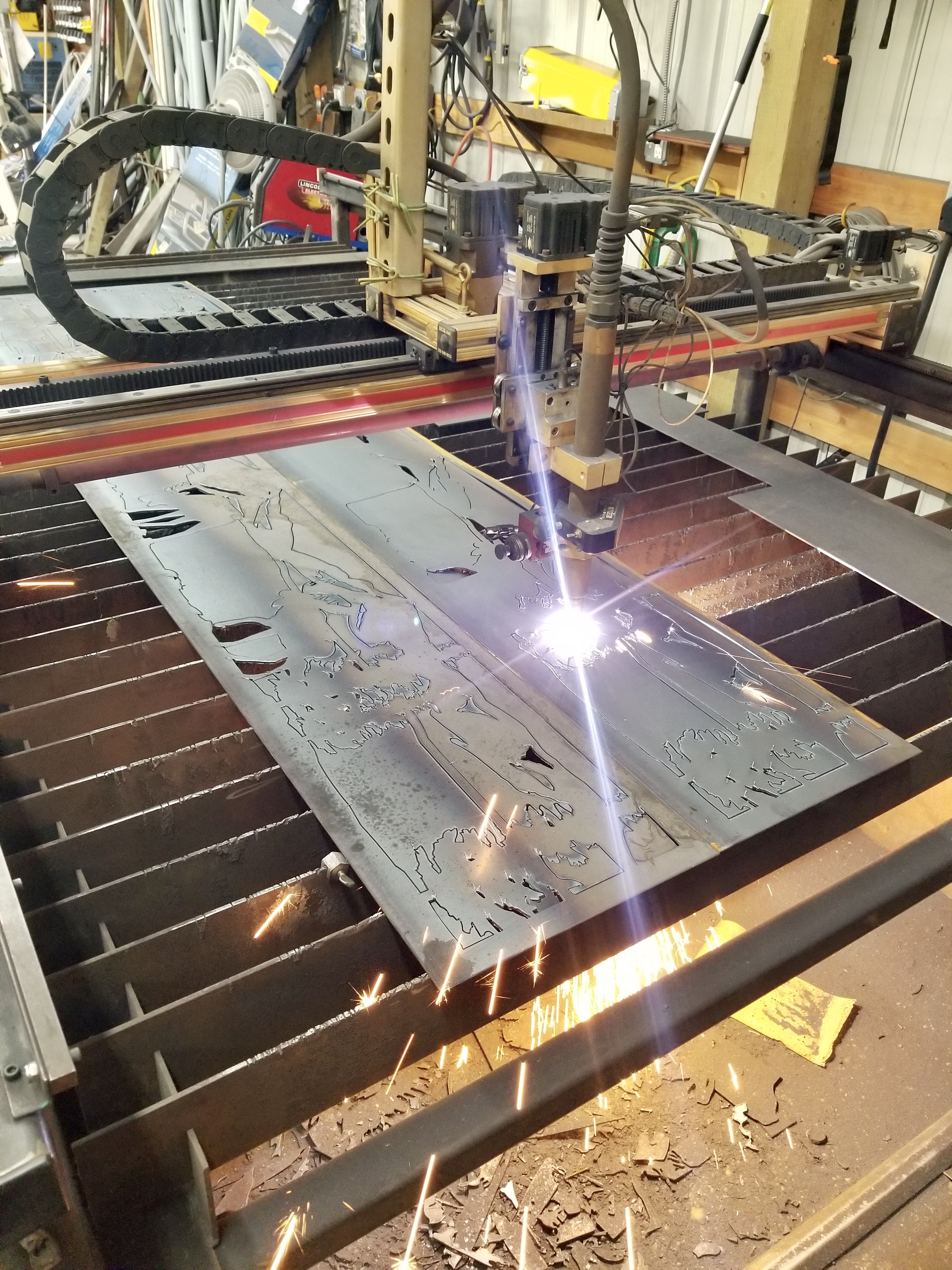

Got to love plasma tables. My problem is im not using mine much any more due to cost of steel. People arn’t doing projects like they used to.
I was floored at the cost of a 4’x8’ sheet of 12g last month. Was 2.5x the cost from the previous year.
I've been mostly using leftover and drop materials lately. Need to order a sheet of 1/4" po to have on hand, can't wait to see the price of that.

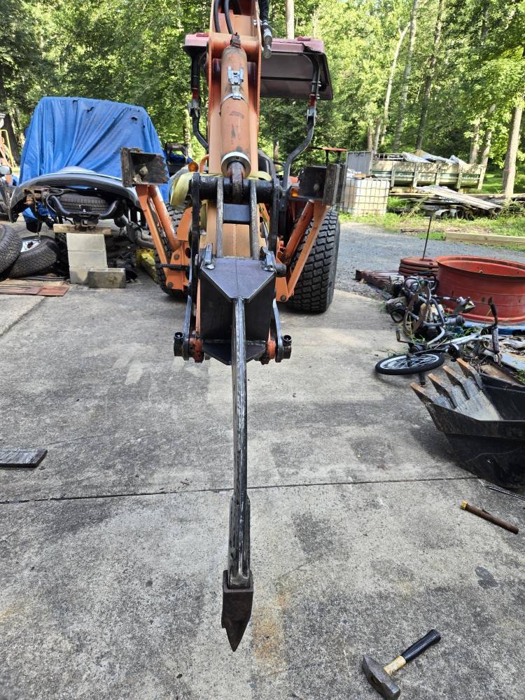

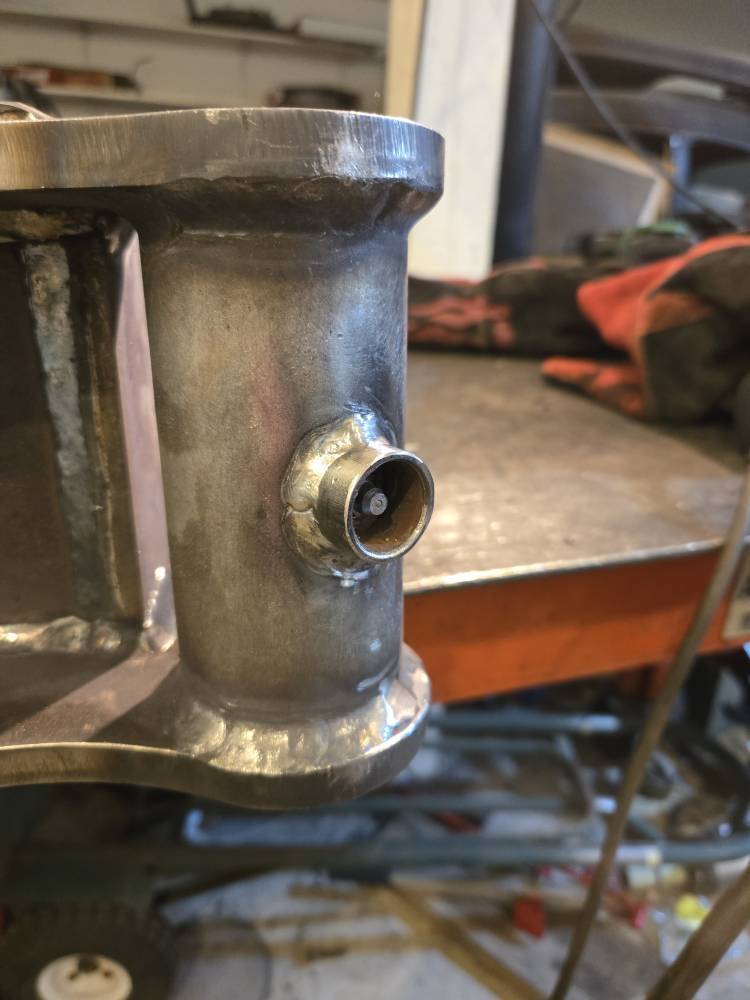

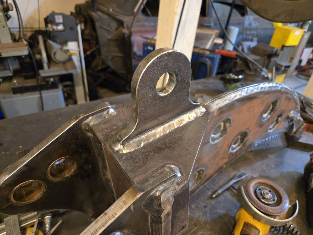

I've been working on getting everything ready for paint, finished the grease fitting protection.
Then, I had the idea to put a shackle mount on the back of the ripper, figured it could come in handy for lifting or pulling. View attachment 3828898
Very nice well thought out and executed work. Have you considered how to remount the root ripper? Smokeydog and I both encountered the same problem when remounting a root ripper using our QA equipped M59s. The ripper wants to roll to one side so Smokeydog added ears to keep ripper from rolling. See link
/ Backhoe Ripper
#27
It lays flat, I don't have a qa so if I lay it face down I can line up pivot pin.
I have thought about making a stand for it.

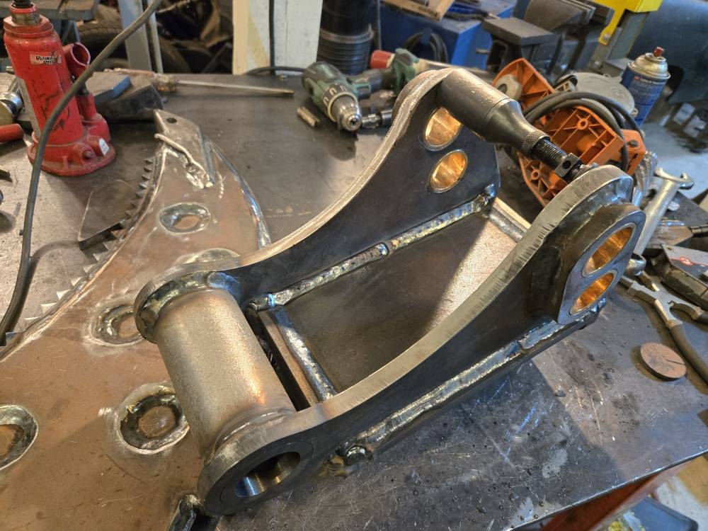

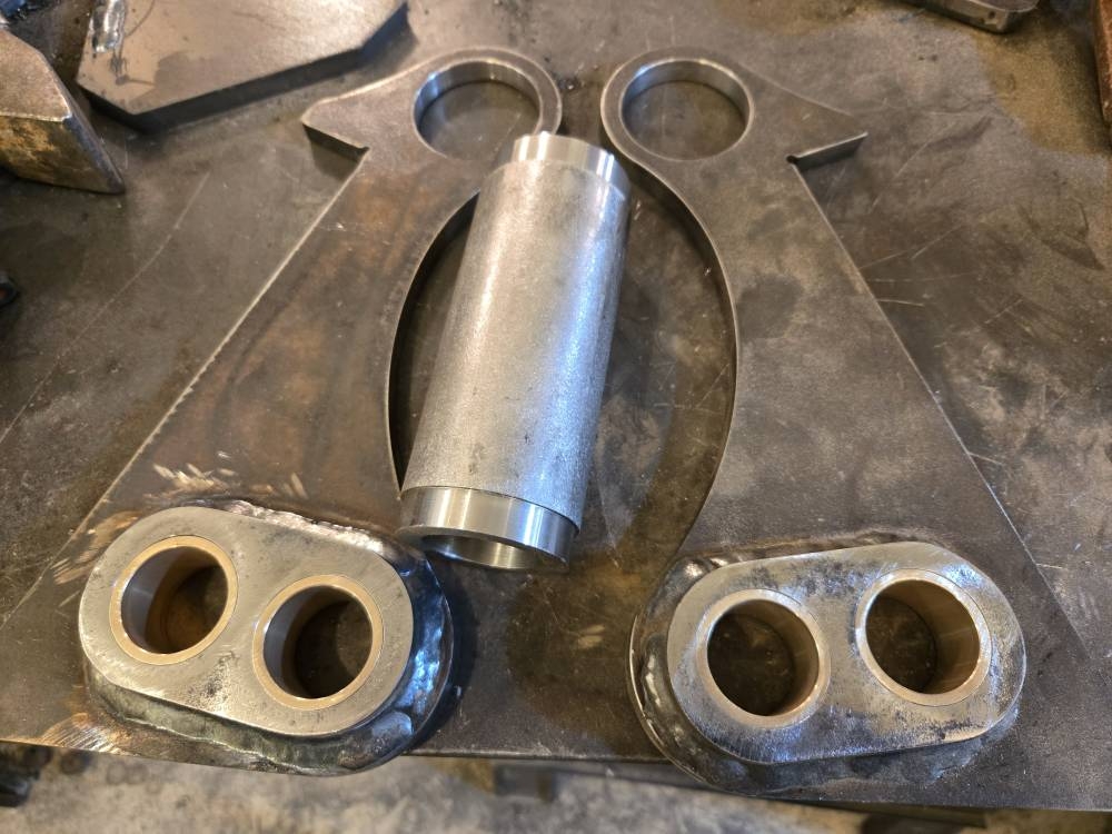

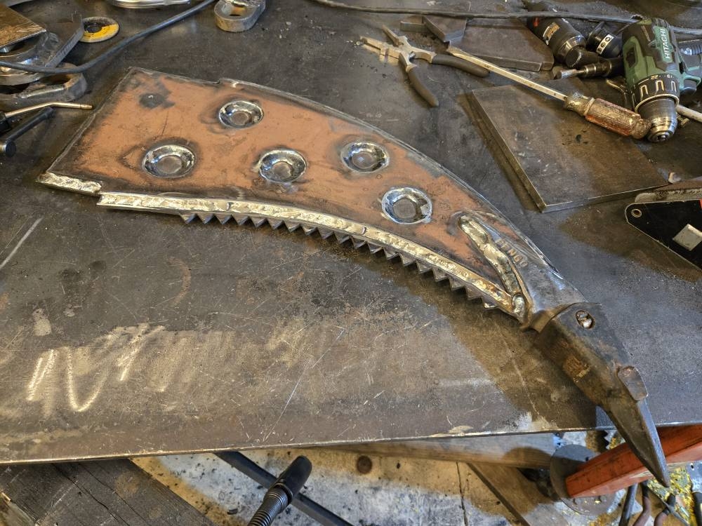

Was able to get a little shop time in today, welded up the shank and mount. Had a little trouble getting the welder dialed in for the 1/4" Hardox, sometimes it can become magnatized when cutting and causes some weird issues.
Next I'll be welding the shank to the mount and reaming the bushings to size.View attachment 3774392View attachment 3774393
Nice work. What material did you use to tube in the bottom picture to connect the pin holders? Did you use a bushings in that tube? If so which one?
/ Backhoe Ripper
#32
It was some oddball shaft material I had, 2 7/16, that was drilled out and machined for 1 5/8od x 2" bronze bushing.

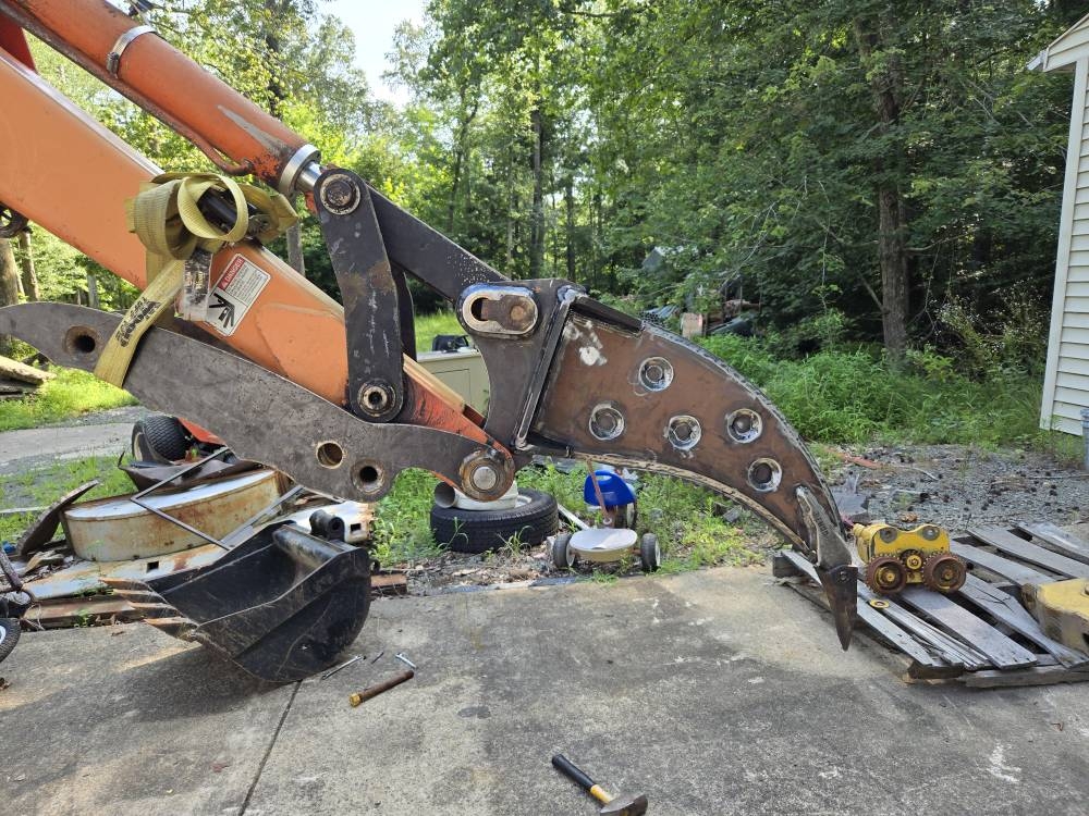

The ripper and thumb are mounted, can't wait to try them out!
Of course, as soon as I went to use it, the right stabilizer cylinder started pouring fluid. Went to the local hyd shop today and matched up some seals, bought double as I'm sure the left cylinder won't be far behind.
/ Backhoe Ripper
#34

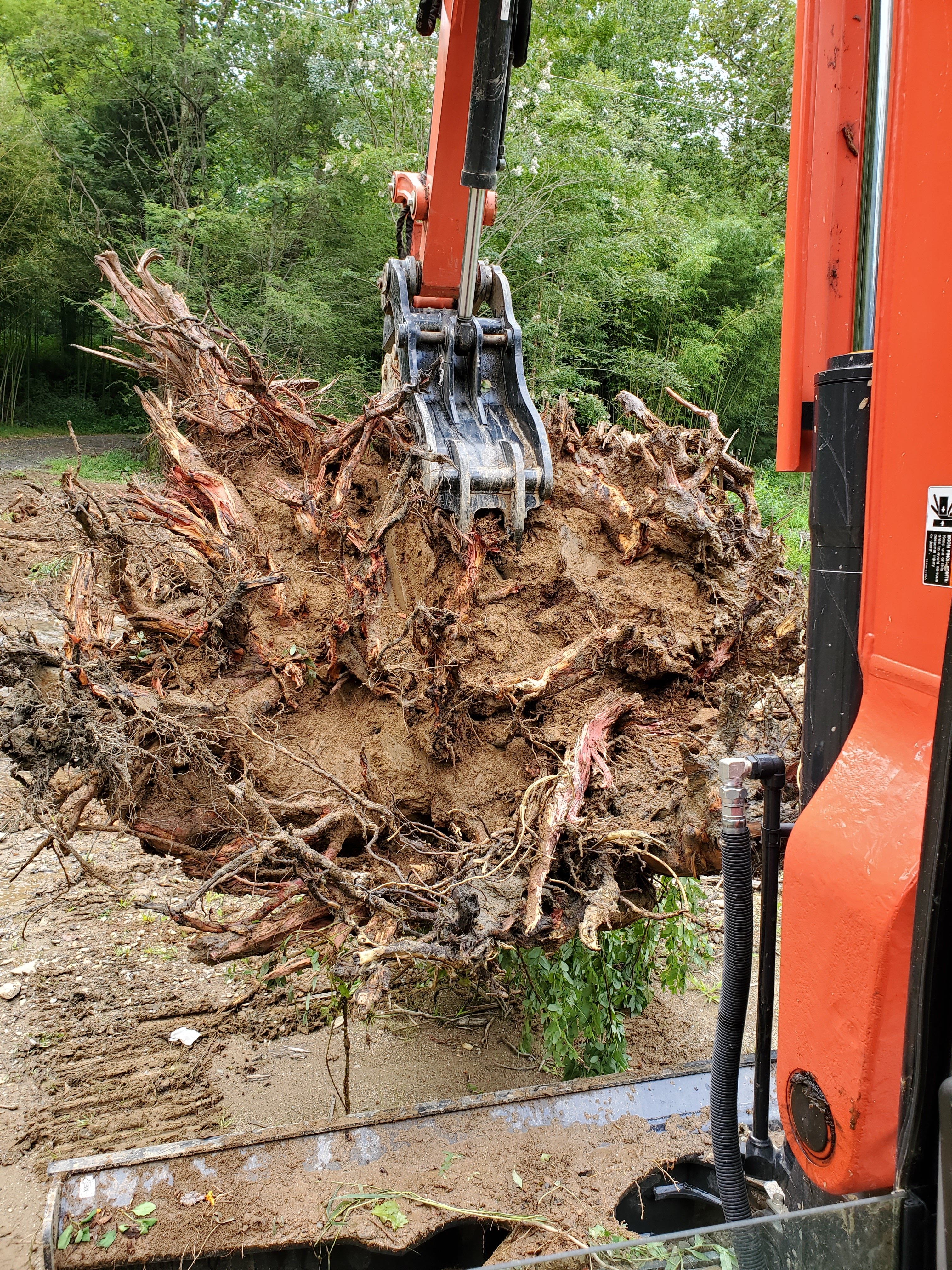

Got to test it out on an old poplar stump this evening, very happy with the rippers performance.
Was even able to test the thumb with it.
The disturbed area is way less than with a bucket, which is why I wanted the ripper.
The stump was a bit old and starting to rot so I'm curious to see how it does on a live tree. Hopefully I'll get the go ahead soon to start on my new shop, which will give me plenty of testing time!

Stumping with a root ripper is great fun.

Way better/faster than digging them out with a bucket!
The only thing that would make it better would be a stronger hoe. The 611 is no slouch, but it seems you could always use a little more power when you hit that big root.
Which reminds me, I need to check the pressures on it.

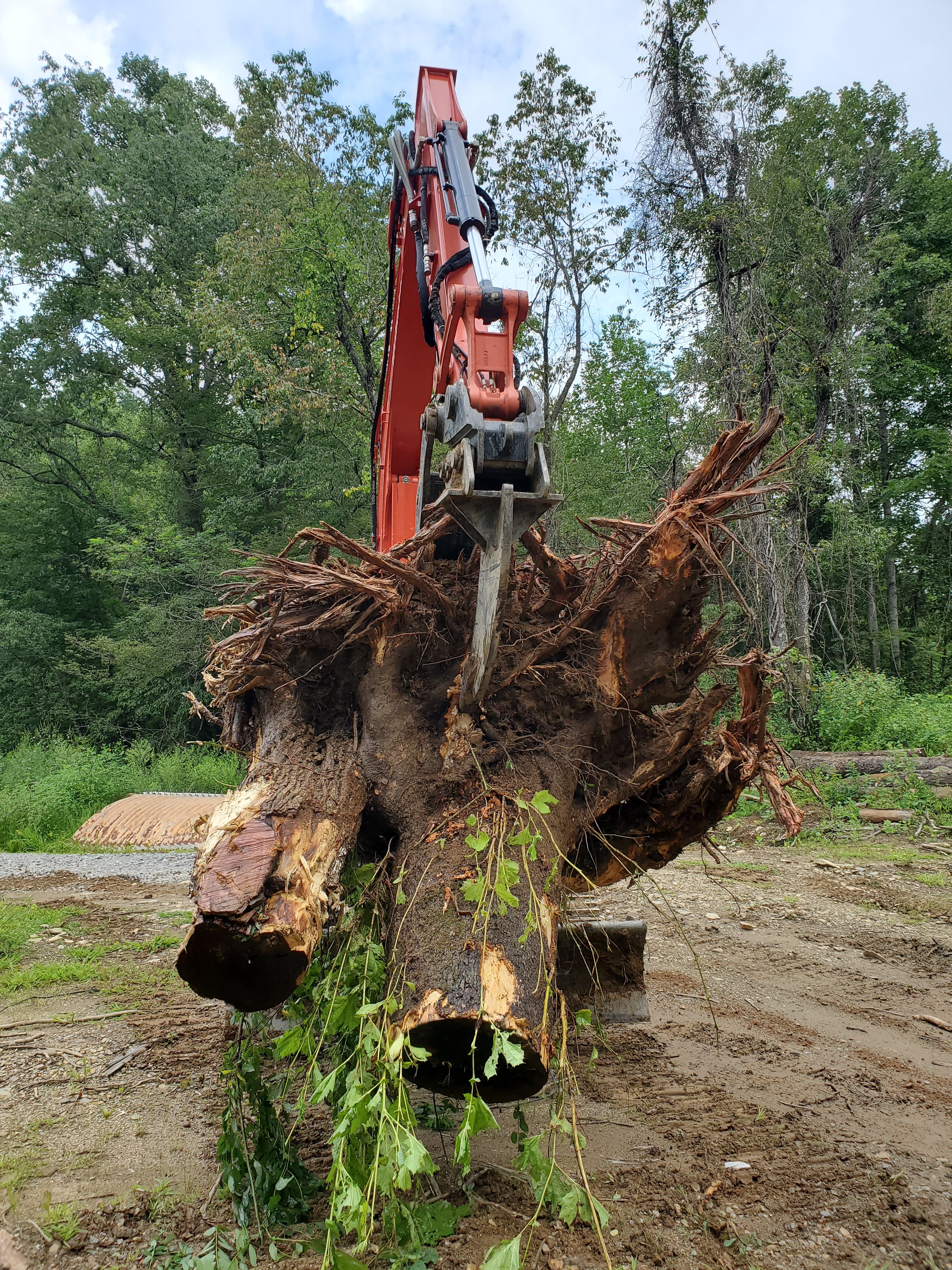

Update on the ripper.
I am clearing for a new shop and have a number of trees to take down and some old stumps to remove, it has been working great ripping the roots out so i can push the trees over.
I have about 8 trees left, one is a large red oak that'll probably put up a fight.
Notes on it so far:
I'm really glad I used Hardox for the shank, it's taking a beating and only shows minimal wear so far. I'm really glad I went with a replaceable point, the amount of wear on it already makes me think it was a good idea.
Overall I'm very happy with its performance and don't think there is anything on the design I would change after using it for about 12hrs.

nice work. to bad the paint is worn off. must not have waited the 6 weeks :unsure: I dug out a couple stumps with a 24 inch bucket on a rented kubota KX057 and I wish It had a ripper.
/ Backhoe Ripper
#39
I definitely did not wait 6 weeks!
Although I doubt the paint would have lasted too long either way, its getting drug through everything from clay to sandy soil and rocks. Not living an easy life for sure.
