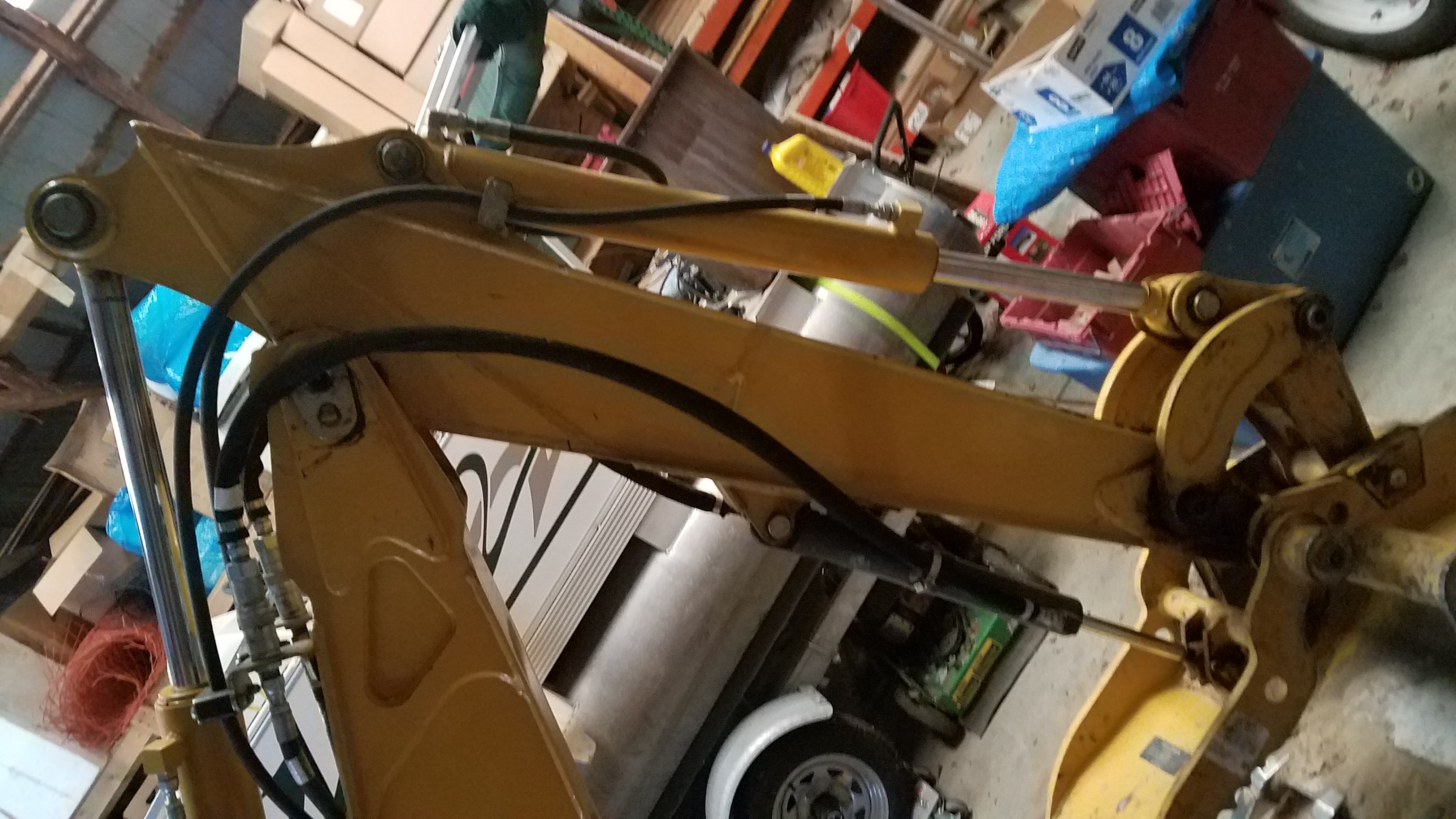

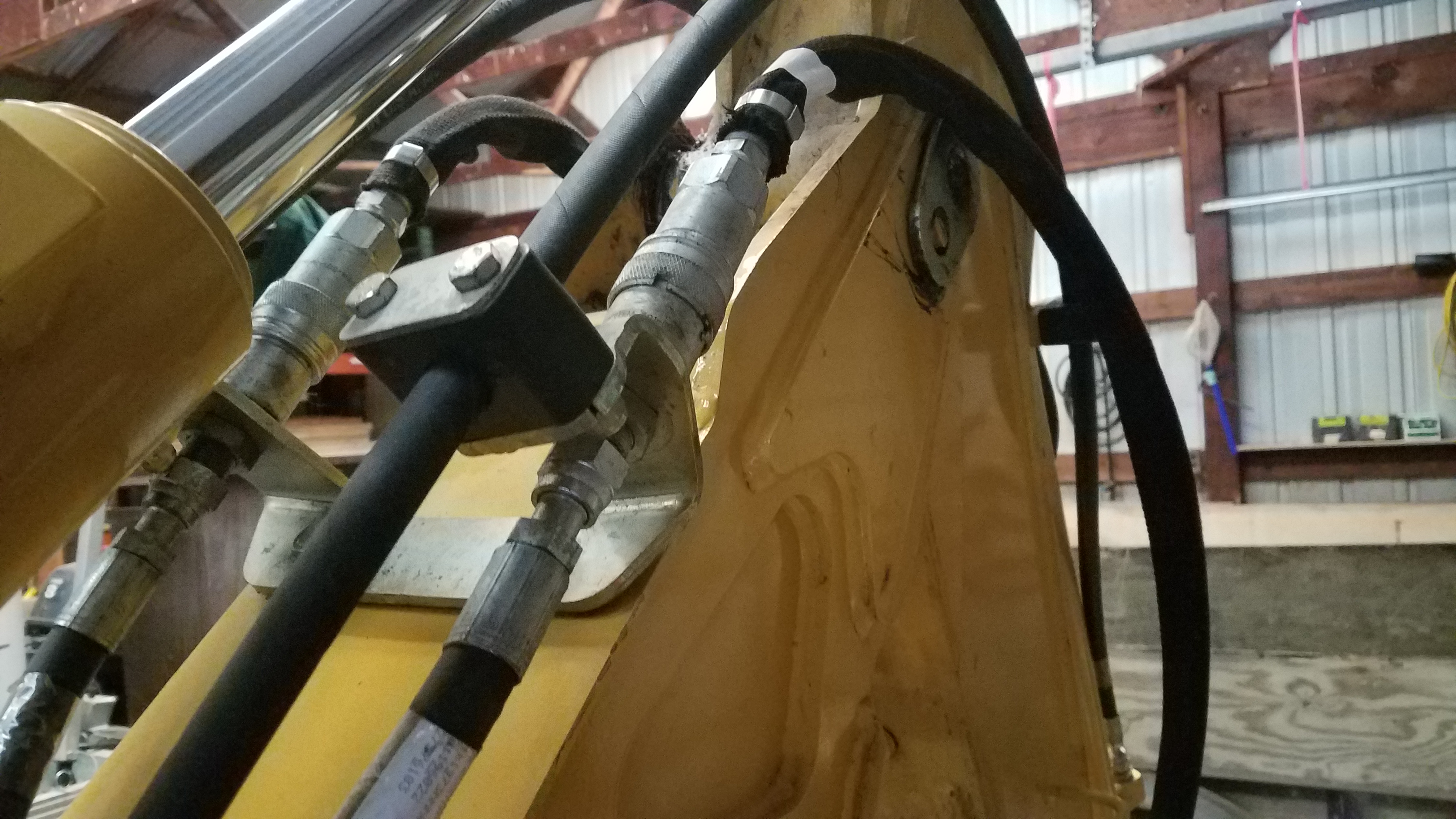

I bought my machine used equipped with extra valve and thumb. I expect factory or dealer installed on thumb. Upon looking through Deere illustrations to order new hoses for bucket cylinder, I stumbled upon illustration and parts for hose mounting. Upon receipt years ago, I had the default clamps for the bucket cylinder hoses. The auxiliary hoses were simply wire tied to them. So, I bought the parts for the factory double clamp arrangement. It appears the mount boss on the dipper stick is common. For auxiliaries, there is a second clamp added diagonally. To accommodate this, there is a four hole piggy back bracket added, two of the holes mount to the original bosses on the dipper stick.
I'm seeking images from anyone who has this arrangement factory installed.

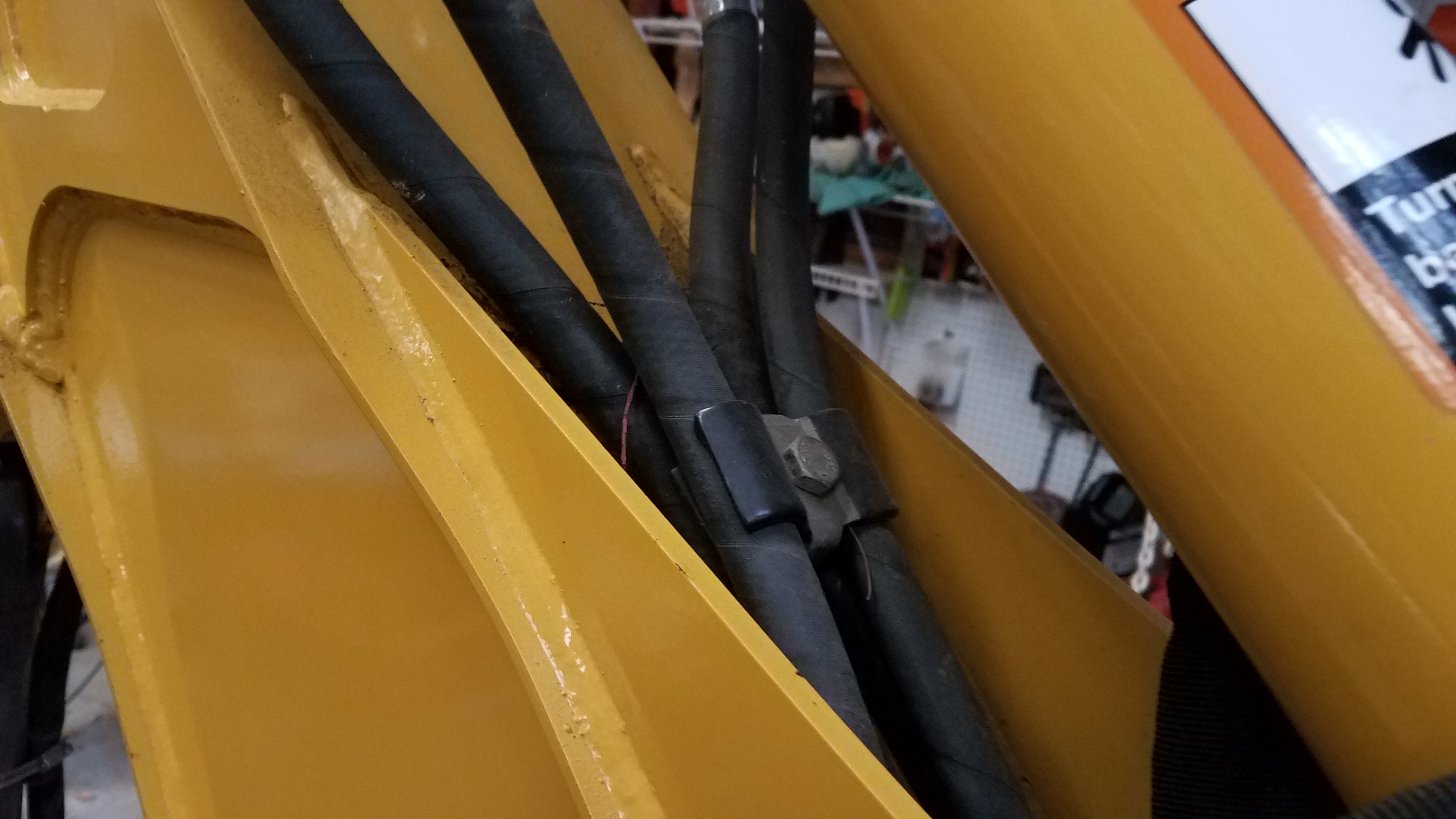

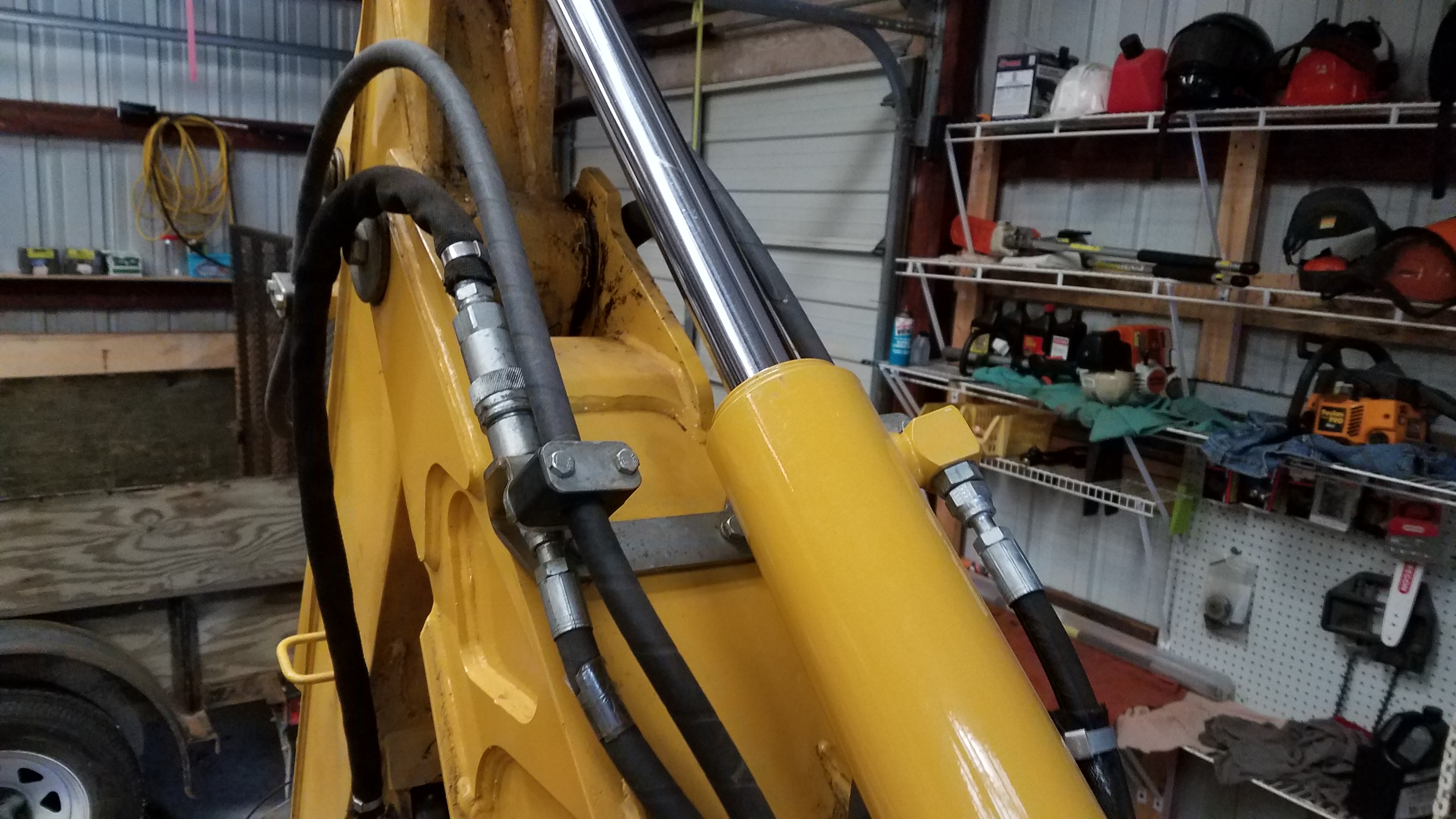

Added double piggy back clamps yesterday. The John Deere Parts diagram suggested a different orientation. This arrangement made more sense and worked best for me.
New hoses and anti-chafe sheathing added at the same time.

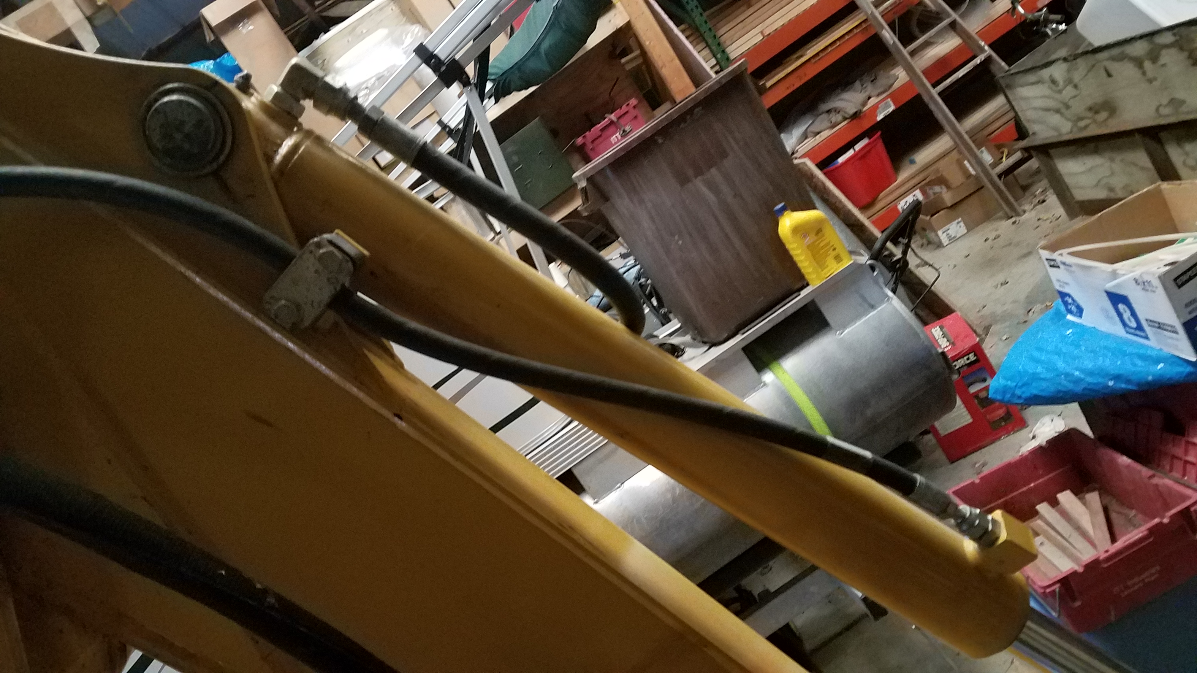

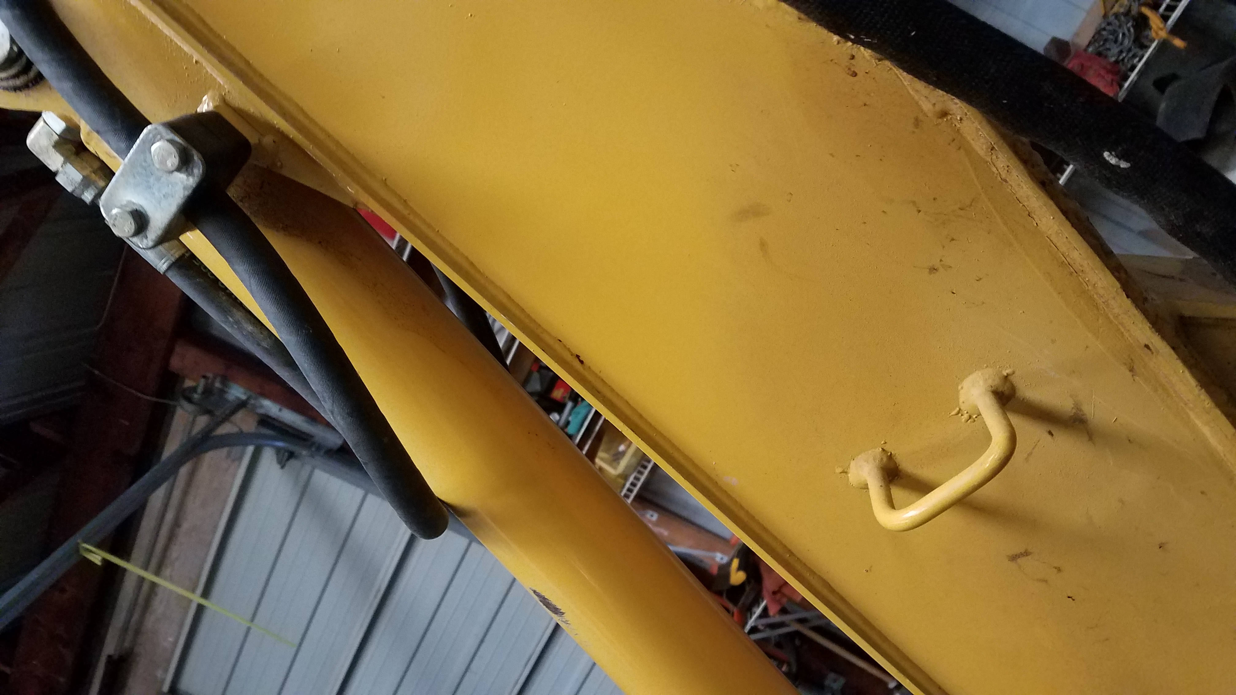

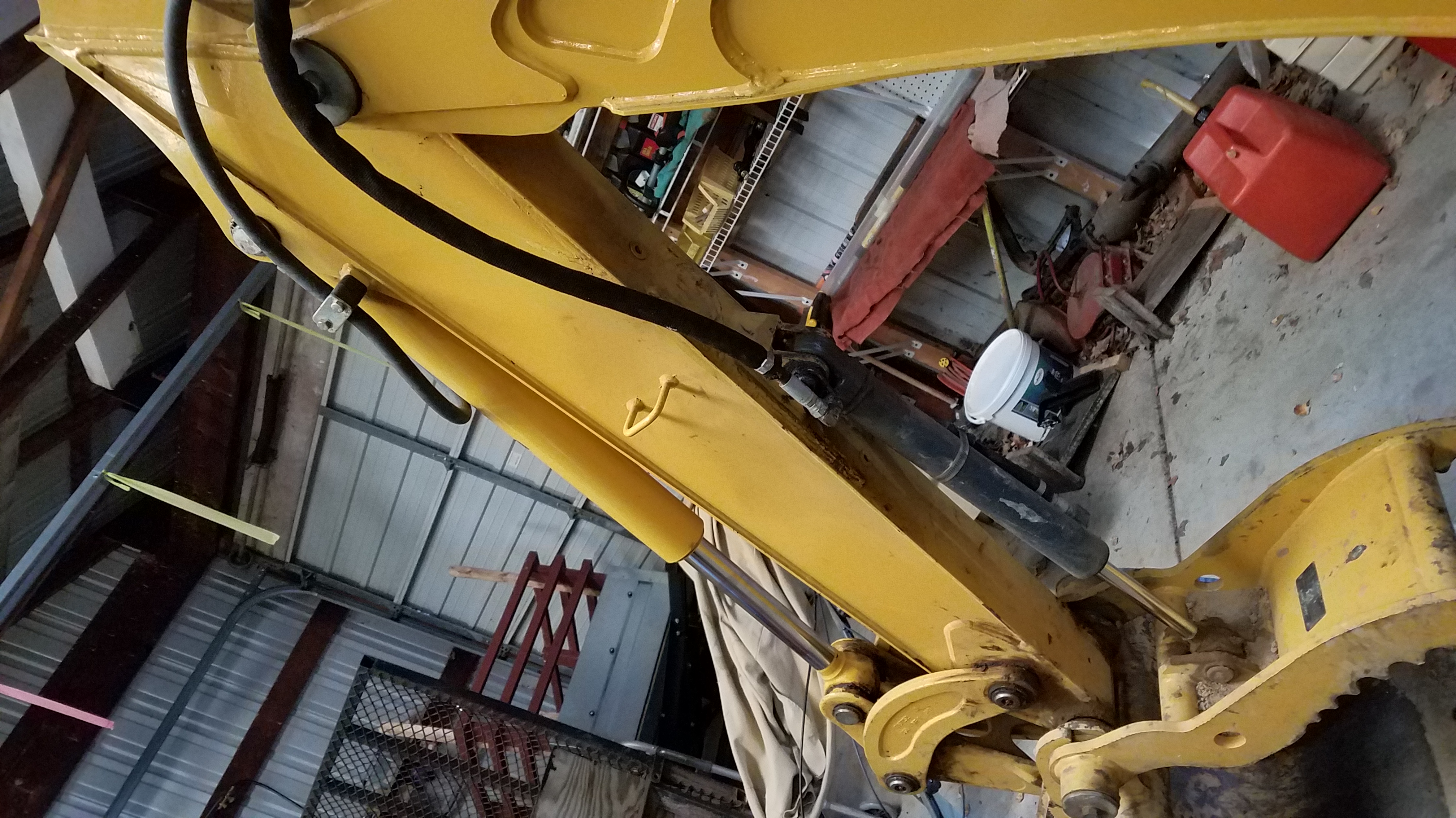

I ran auxiliary hose through prior owner added welded metal hose guide. With dipper stick all the way out, result is a tighter than OEM loop on lower auxiliary hose. I'm undecided whether to leave as is, run hose outside guide or remove it.

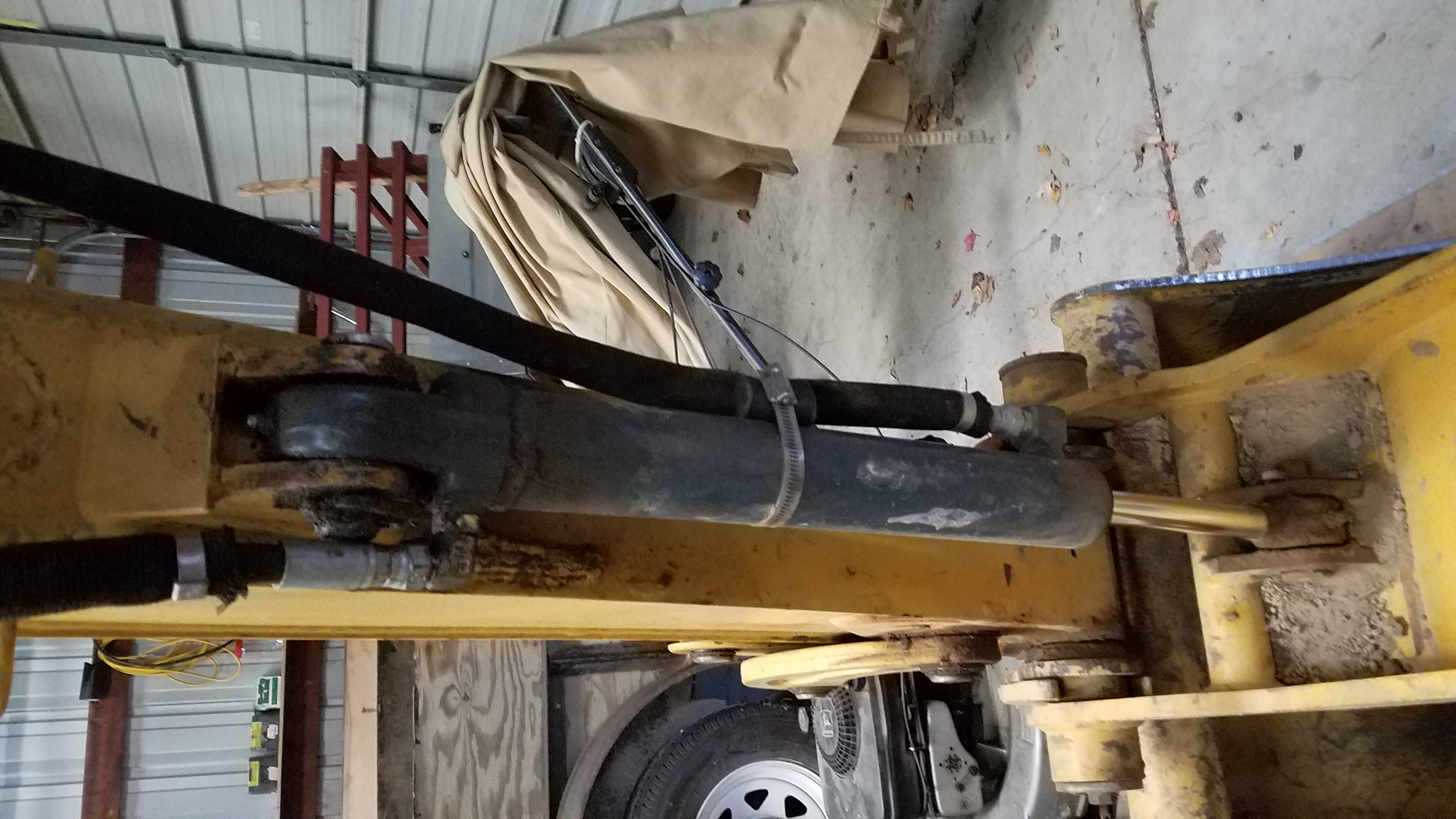

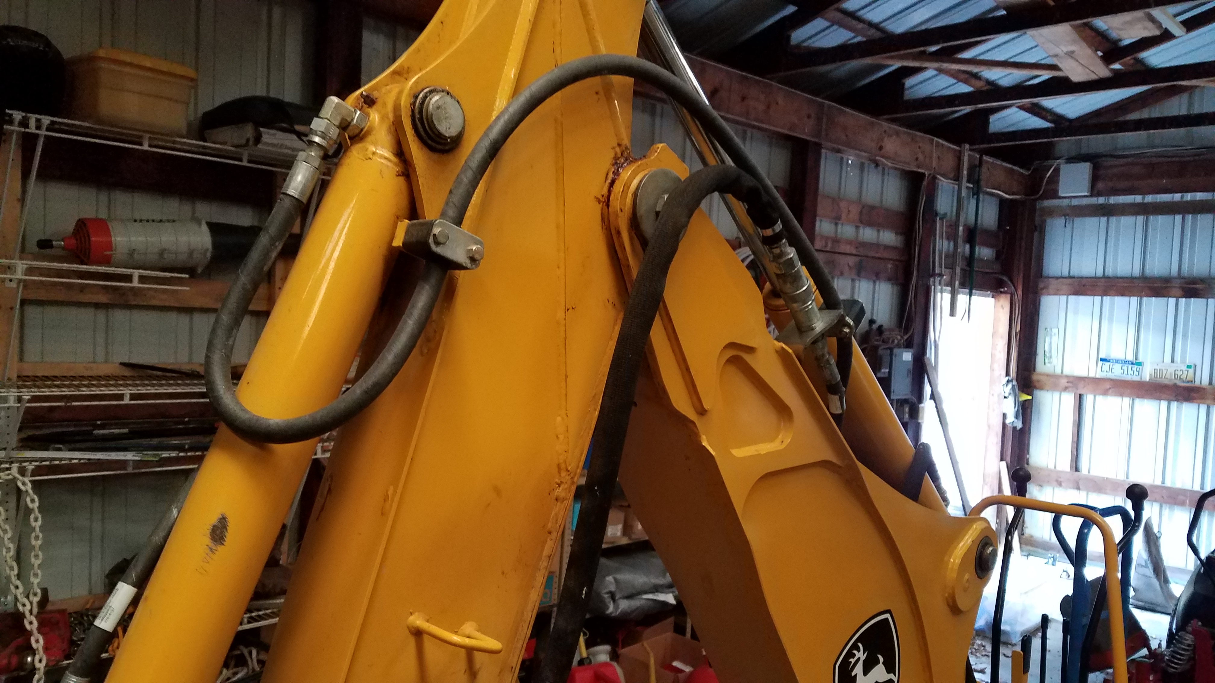

Here's a few pic
