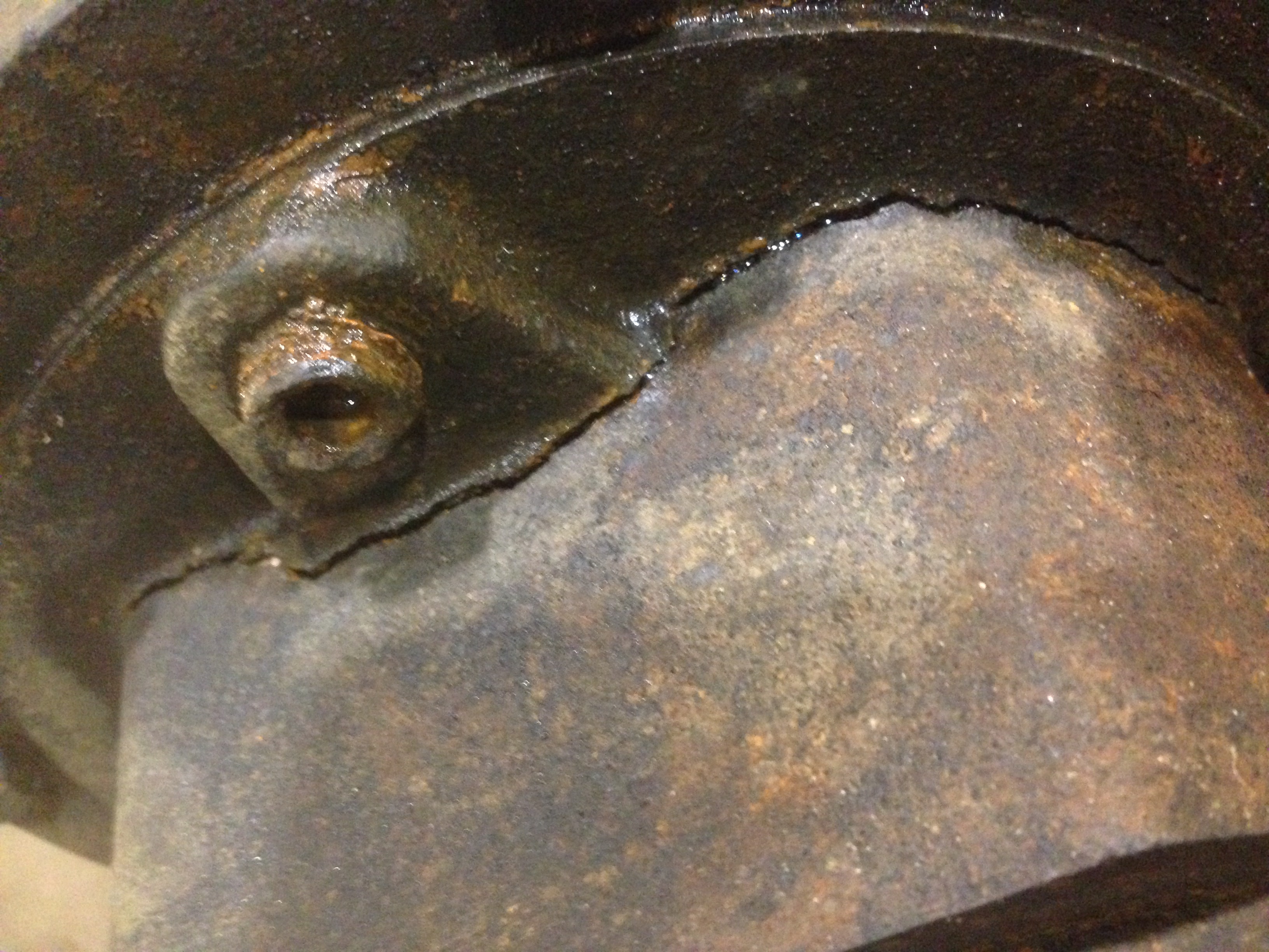

Well this journey took a turn for the worst last night, I decided I was going to disassemble the housing and clean and paint it best I could. To my shock upon removal of the housing the crankcase cover which mounts the hydro motor to the crank case is cracked 180. There was no way to see this however without taking it all apart. So I of course contacted the guy I bought it from who's trying to blame me. I explained that I don't even have an auger for it yet.
So off the JDparts to find a good parts break down. Parts list has no specific number for just the crankcase cover. Email the dealer and he comes back to me with the crankcase cover can't be purchased separately and I'll need the whole crankcase,$2300 for the case. So now I'm waiting to hear what the seller is going to do on this. This was a CL deal but the guy buys and sells used construction equipment and seemed like a decent guy. It's part #10 on the pdf.

You might try to see if you can find a McMillen dealer. That is the mfg for this post hole digger, you could probably get just the parts you need from them. Try to find the McMillen model that matches your unit, order as if that is what you have vs the Deere branded one. Might have better luck.

I've already got an email into Paladin(Mcmillan's parent company). My dealer was also heading that direction as well. I can also weld repair it I'm fairly certain. I'm sorta in limbo until I hear back from the seller. If he's gonna take it back I won't mess with it. I was going to purchase a lightly used PA 30 from a Midwest dealer that was in newer condition but decided to buy local to save shipping. Perhaps I should have purchased from them?

So the reply from McMillan is the crank case cover can't be purchased separately and I'd need the whole case for the price of 2k.😡
So at this point I'm going to try to get the seller to take it back. I can't understand why oems pull this stuff with parts. Deere does his stuff a lot.

Likely is a financial decision and the cost of carrying inventory of parts.
Business will not survive without making a profit. Unlike the governments... where free tax money is available. ;)
Wish you well with the seller... obvious this is an old break.

This unit is in current production so it's not a stocking issue. It's greed, they need to take a page from Woodmizers book on parts.
The entire unit new is in the 3k range, there's no way that the crank case is 80% of the cost. The hydraulic motor is an expensive item and then there's the mount, seals bearing etc.
