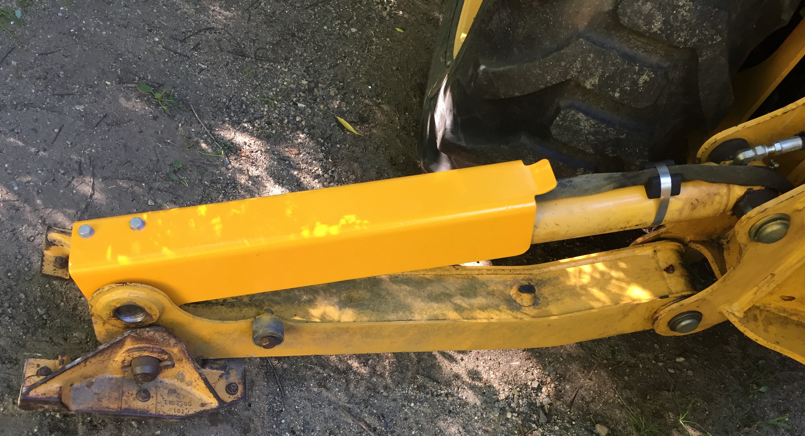

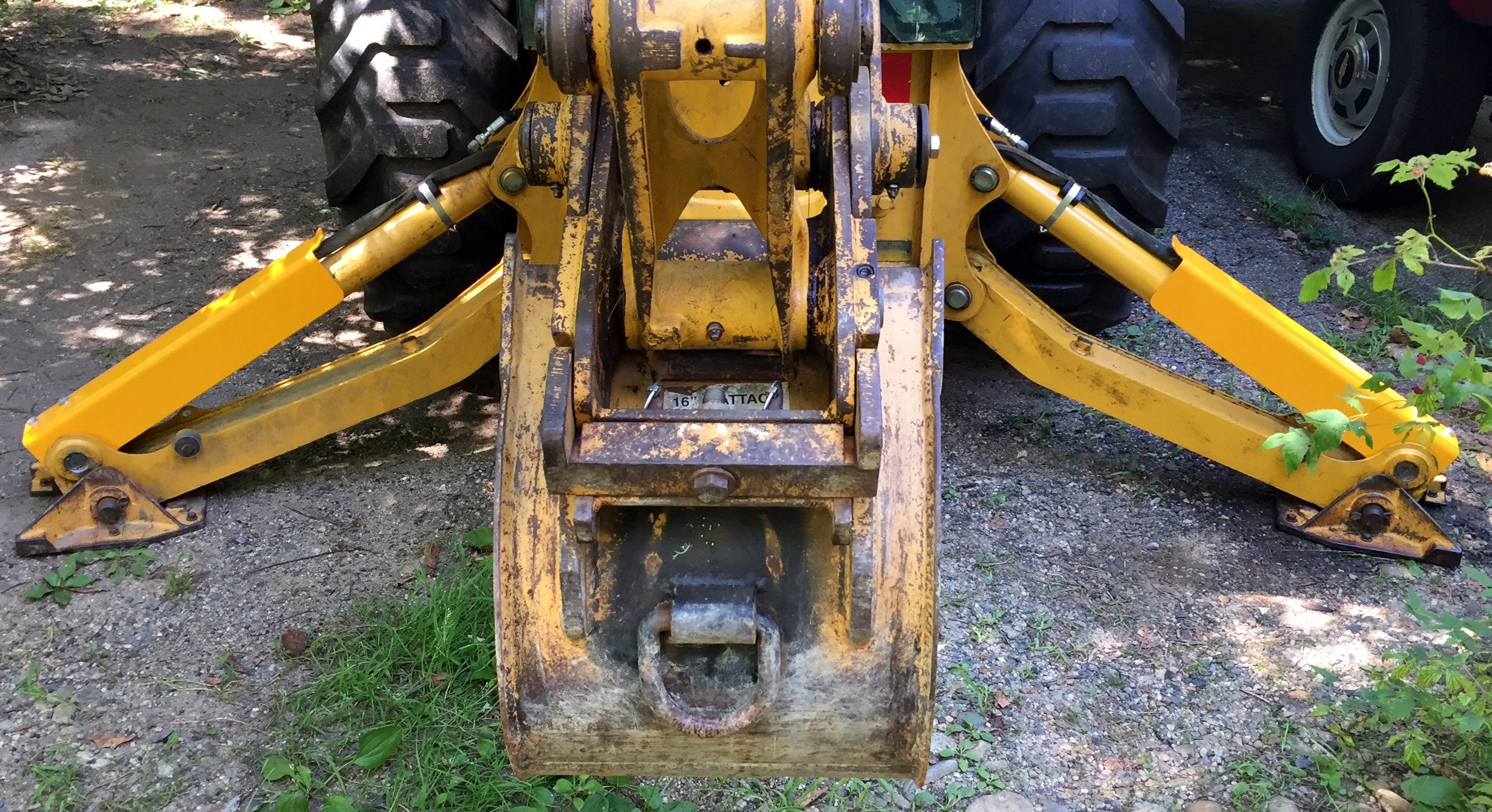

As perhaps stated before, I purchased these used from Wengers as supposedly they were discontinued from GR. They had significant battle scars as in dents, twists, rust and peening. I have perhaps eight hours straightening and refinishing. I installed at the same time I replaced the RH stabilizer cylinder. I have found in my Magic rattle can refinishing that CAT yellow is just slightly darker than Deere yellow but very close. Cub Cadet yellow is notably brighter. Majic takes forever to dry and painting outside leaves you with lots of tiny bugs to pick out.

As perhaps stated before, I purchased these used from Wengers as supposedly they were discontinued from GR. They had significant battle scars as in dents, twists, rust and peening. I have perhaps eight hours straightening and refinishing. I installed at the same time I replaced the RH stabilizer cylinder. I have found in my Magic rattle can refinishing that CAT yellow is just slightly darker than Deere yellow but very close. Cub Cadet yellow is notably brighter. Majic takes forever to dry and painting outside leves you with lots of tiny bugs to pick out.
Nice, they are sure worth it. Really worth every penny and the hassle you spent. They look great now.

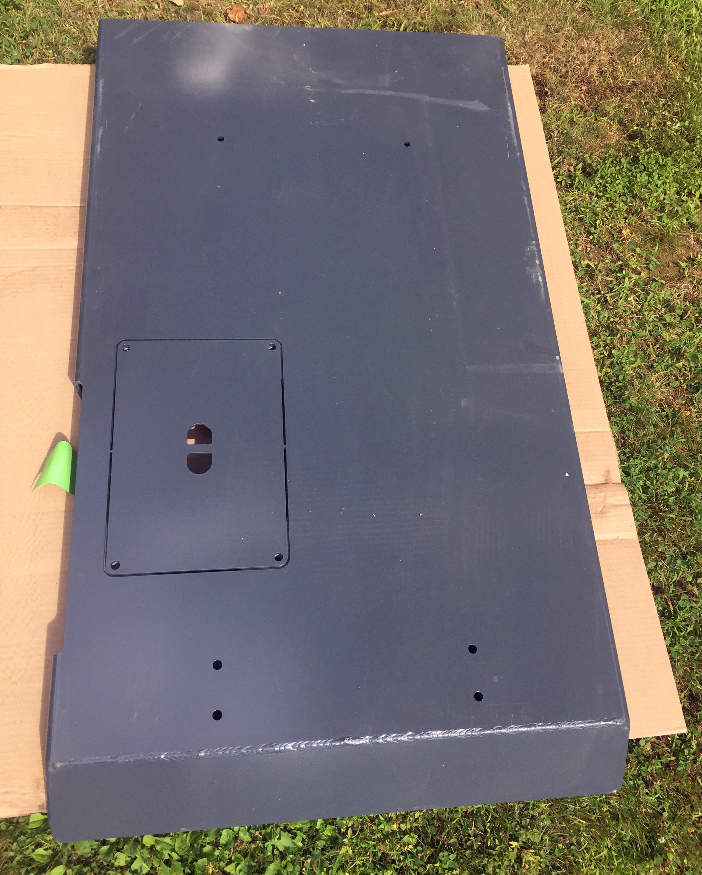

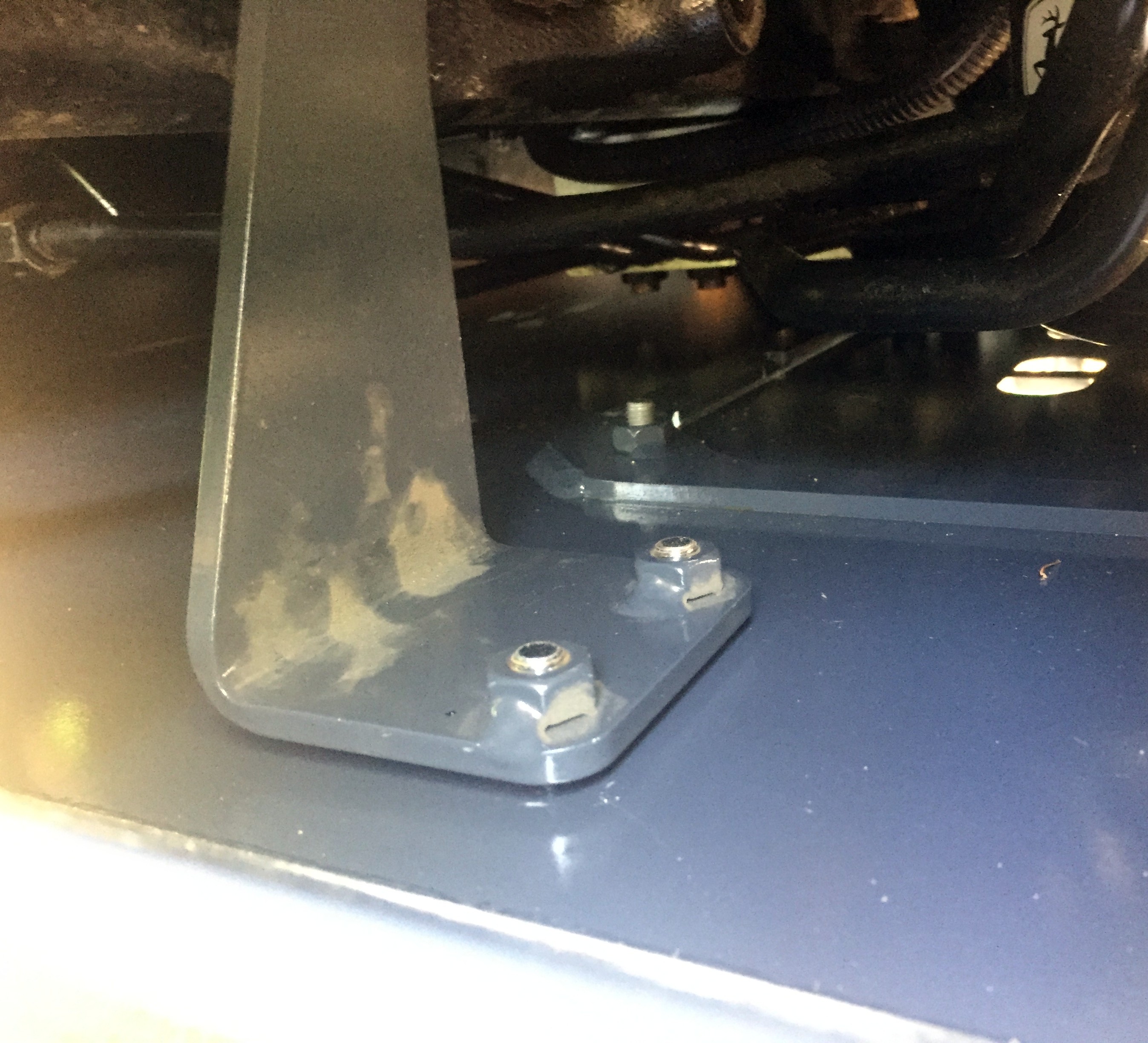

Got in the GR Manufacturing 704745 Belly Pan/Skid Plate. I had to go through a JD dealer to get it. The first dealer I contacted was United Ag and Turf (formerly North Country Tractor) in Dover NH, a bunch of imbeciles! I spoon fed them all the information, GR p/n and phone. They came back with a quote of over $500. After weeks of prodding regarding the quote being all inclusive or with additional freight, they finally replied and fessed up that freight would be an additional $300. I guess if I previously ordered based on quote alone they would have slapped me with a freight charge thereafter, Holy smokes! GR forces you to go through a JD dealer, profitability and zero value added. Interesting, I've applied for a parts department job there twice in ten years. I have a lot more insight and would never have done this to a customer. I ended up ordering through Rosencrantz tractor in Kensington NH, much better deal and service.

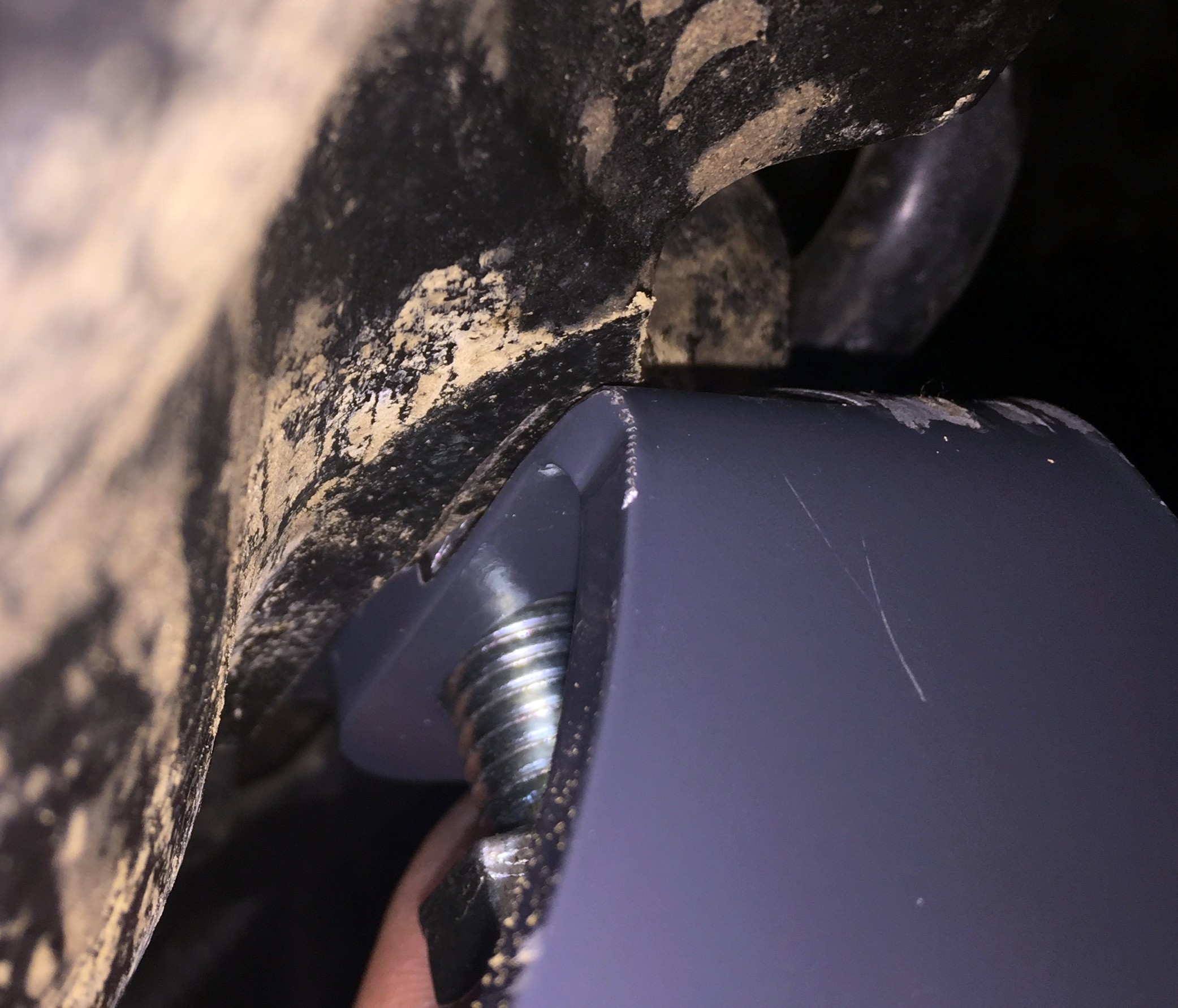

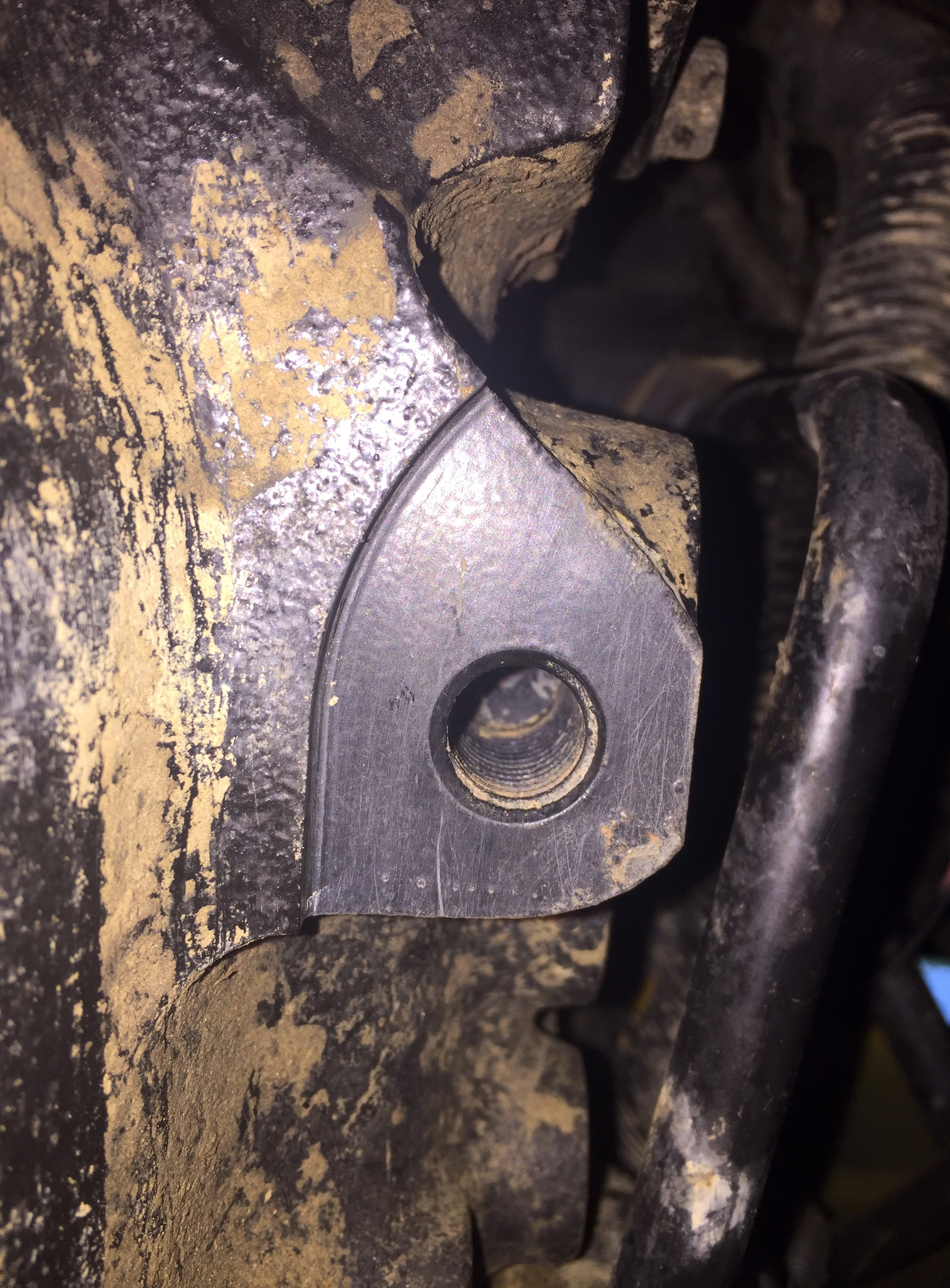

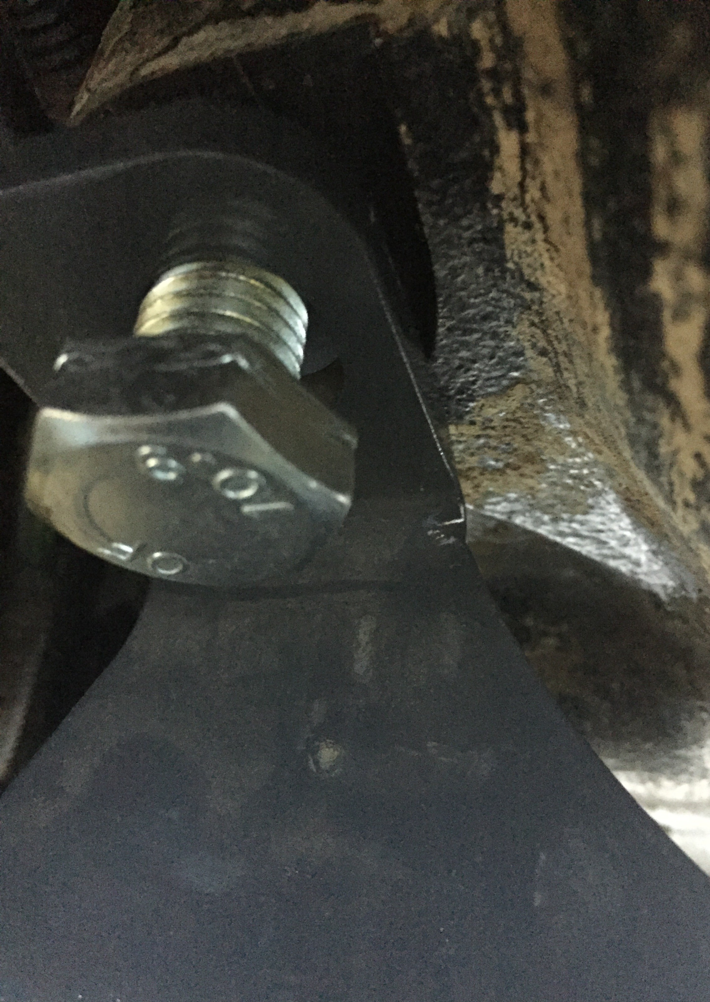

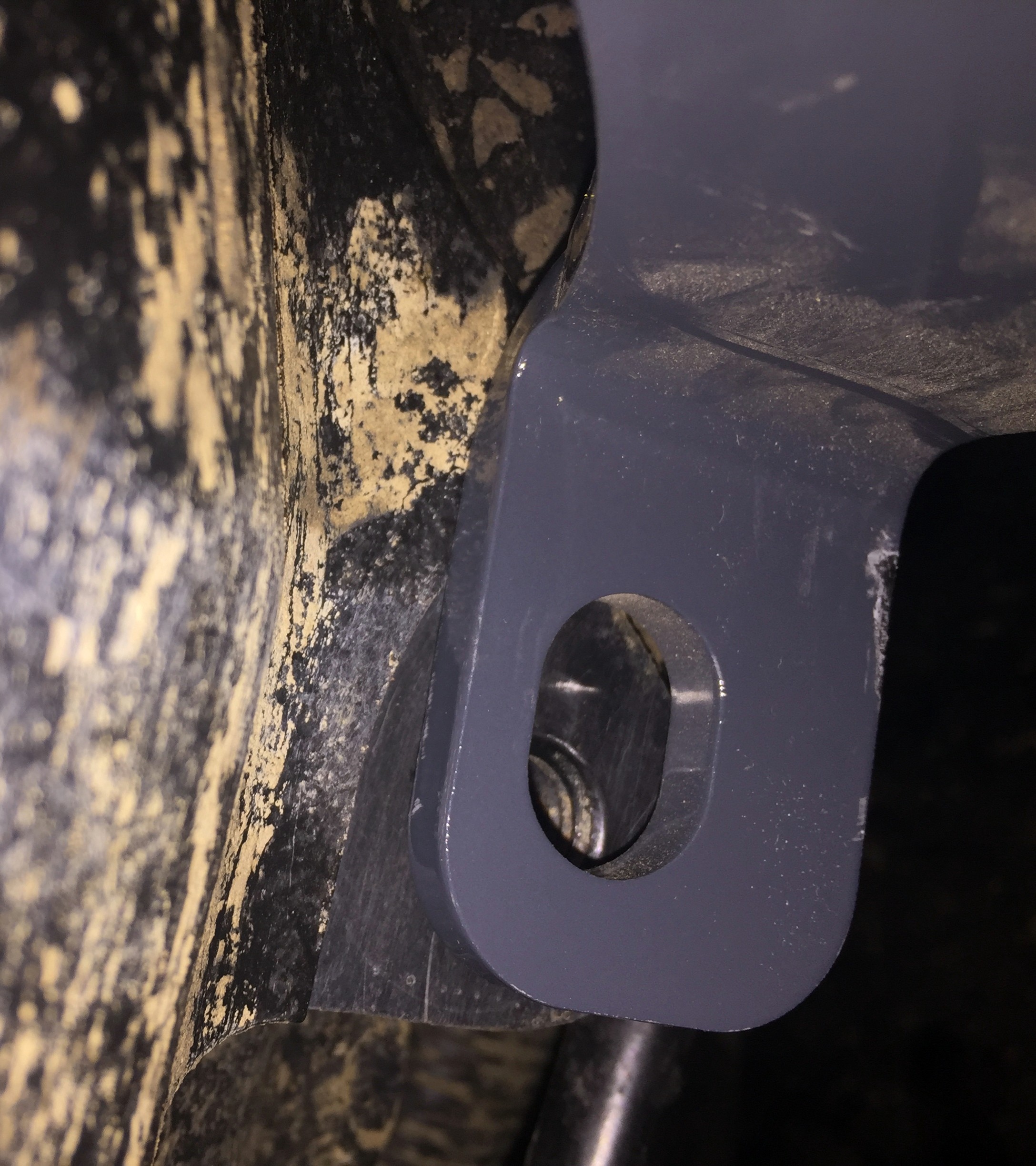

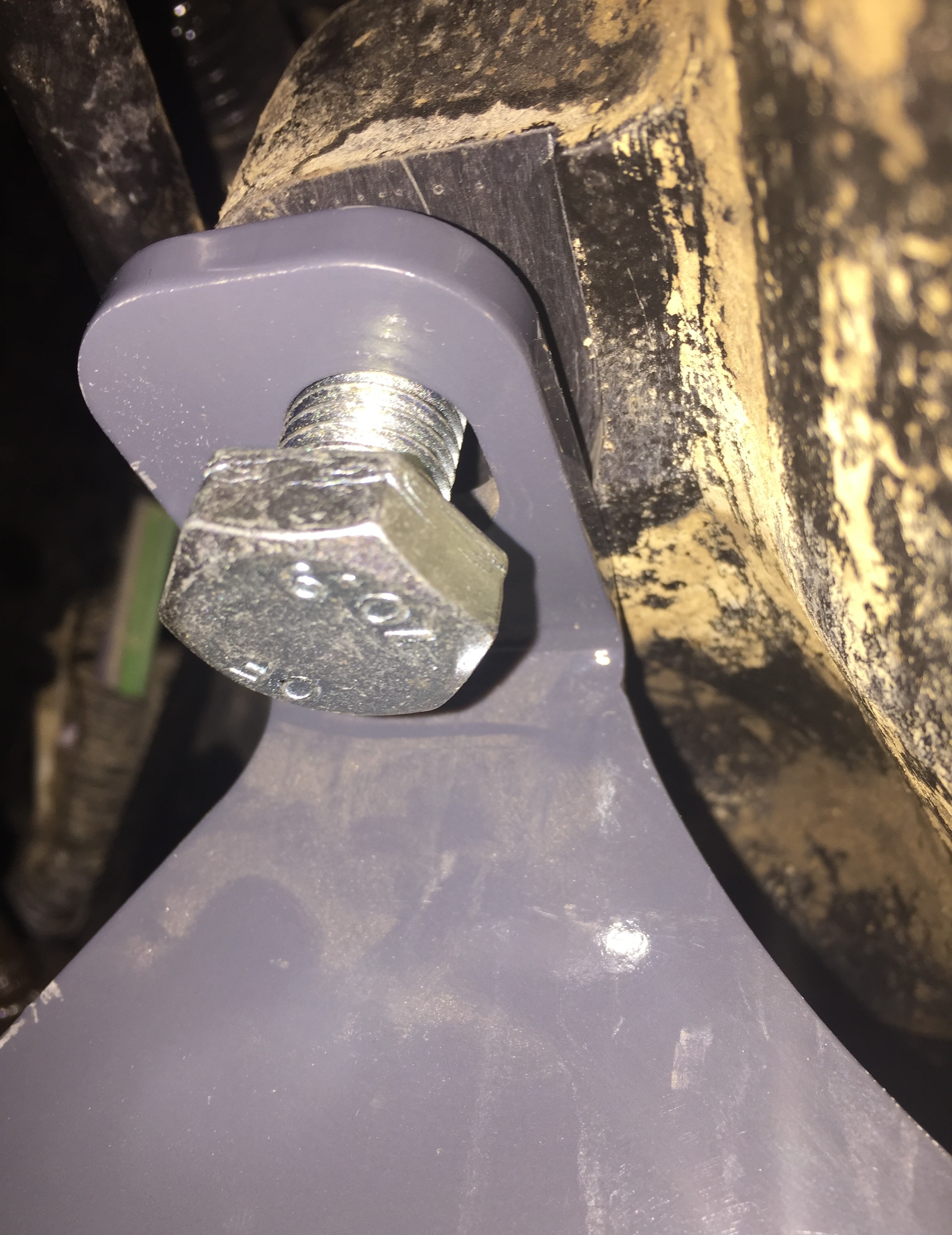

Ran into issue test fitting brackets for the skid plate. Fortunately, the design uses existing unused tapped holes underneath. The flange for the rear support on the RH side on the transaxle has a footprint larger than the machined pad on the transaxle. I had a few options, disregard and bolt up as is, use spacer, grind/enlarge transaxle pad, modify bracket. There were no notes or instructions from GR in regards to this. I called them for technical support. Through imaging and phone text, I opted to notch the bracket. Be aware of this should you purchase!

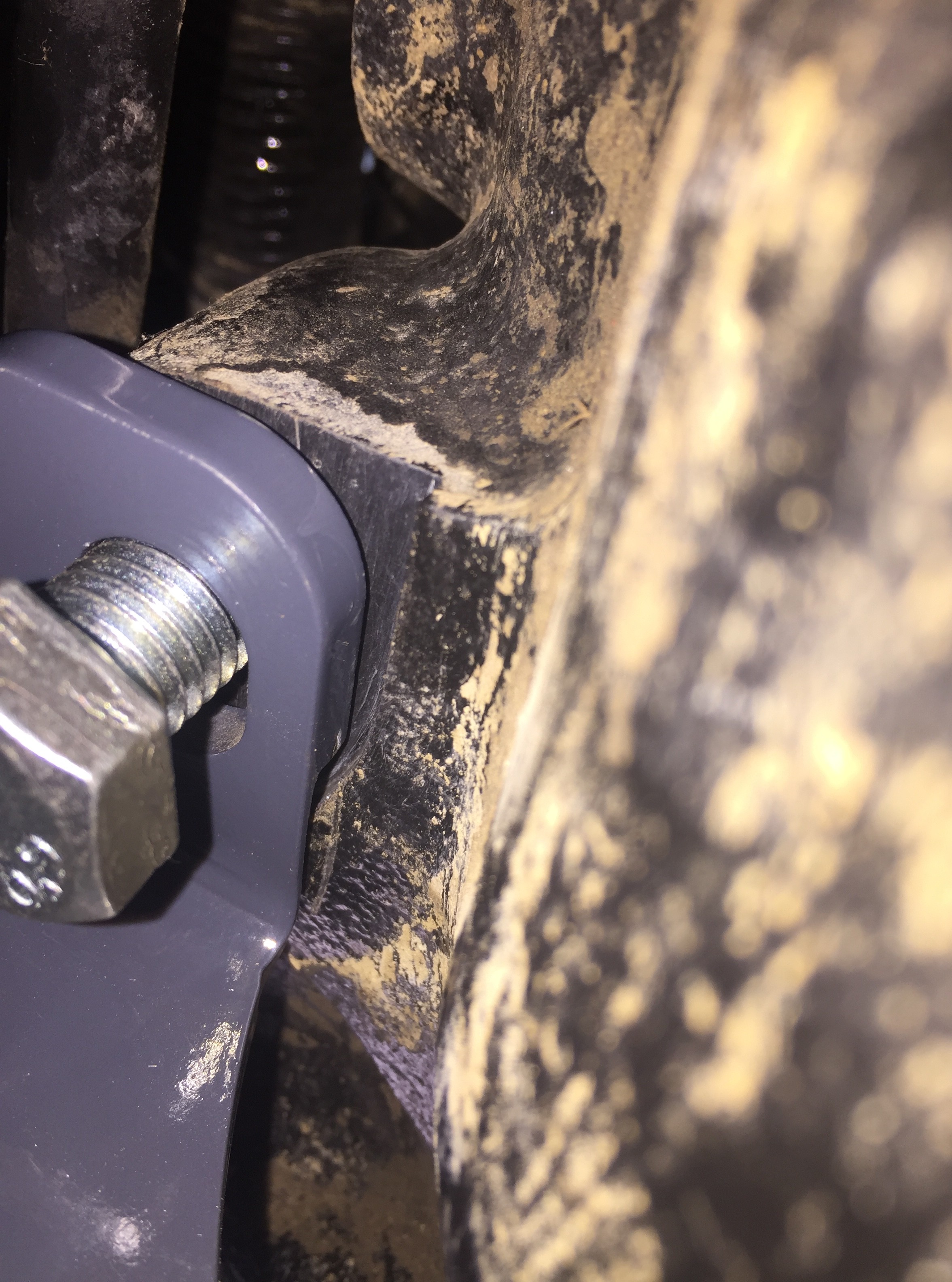

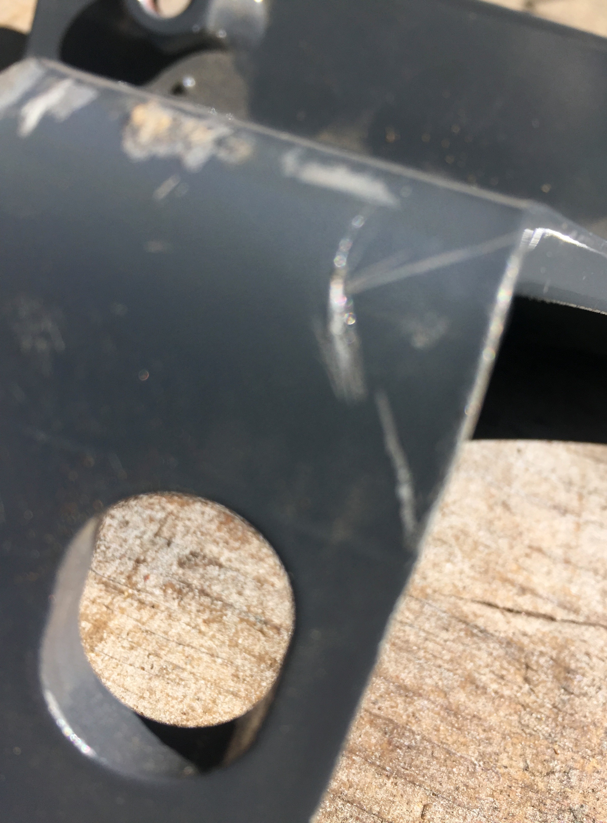

Here is my modification. For the boatload of money I spent, this required modification and my time expenditure was very unfortunate and disappointing. I assume they will warranty and replace bracket should it fail.

Guess you should have visited a local welder and fabricate up your own.
   / 110 TLB Stabilizer Shields #18
I would assume that they would NOT warranty the bracket, since you modified it !
#19
Part would not fit as designed and supplied. Called GR immediately upon problem. Talked to GR tech and sent images of problem, description of modification, images of modified part with okay from GR tech. If part is fails, they will have an unhappy customer and they will supply a part that does fit.
