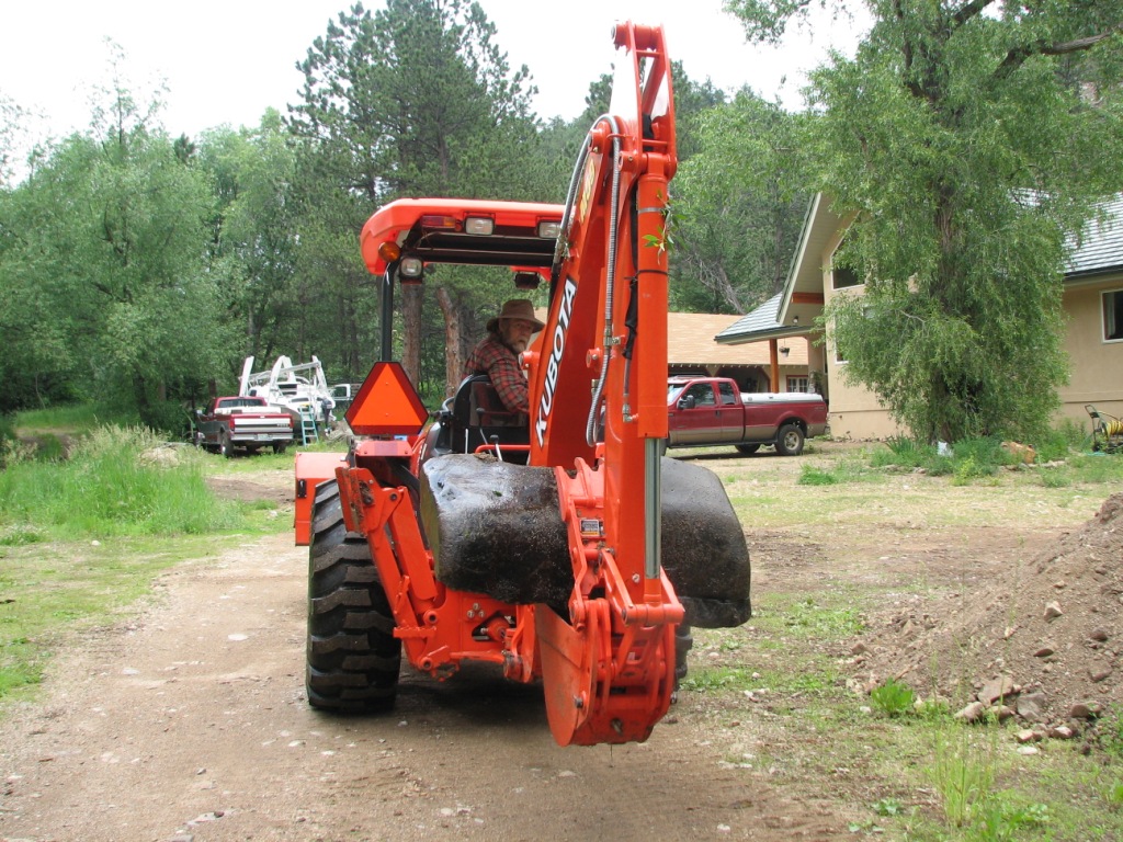

As to why you need one I'll just say that you need to listen more to people who have a thumb on their hoe rather than people who don't. And ask them if they would consider having a hoe without one. It's sort of like changing from gears to a hydrostatic transmission. Us old guys didn't want to change. We had to use one for a year to finally convince ourselves that a clutch and gearbox might work, but basically there was a better way.

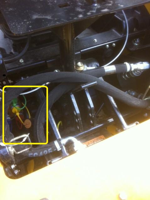

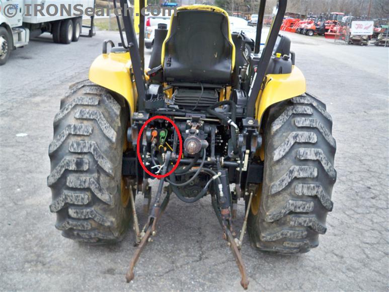

here is a few photos that I saved when I was looking for my 110.
3-optional rear mounted SCV's photos 1 & 2
