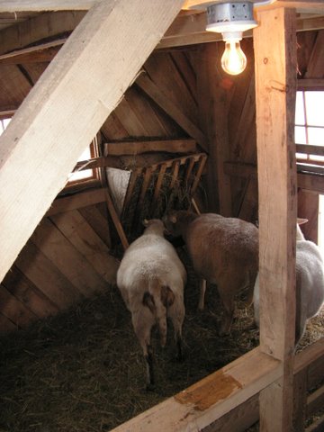

Sorry but now that I found how easy it is to post photos - I took a few of the interior today - finished with a contented "Lucy"
Loren

If you have them I'd like to see close up of how you pegged the joints. How did you cut your mortise and tenons?
Very nice. Your sheep live well.

what book did you use, very nice job, i love the look of a timber frame.

The book I used is "A Timber Framer's Workshop" by Steve Chappell. The actual design is a combination of methods from the book and examples I found online.
To cut the mortise and tenons I used power and hand saw, forstner bit to rough out mortises, and a 1.5", 2" and corner framing chisels. (bought 1 new and 2 on ebay) (It was hours of work but enjoyable work)
I drilled joints when bents were ready to be raised and pegged with hardwood dowels (I cheated-they're supposed to be formed from 1"X1" stock) The remainder of joints were drilled and pegged in place.
I plan to post my first Timber Frame (summer of 2009) with photos that show some of the process a bit better.
Loren
