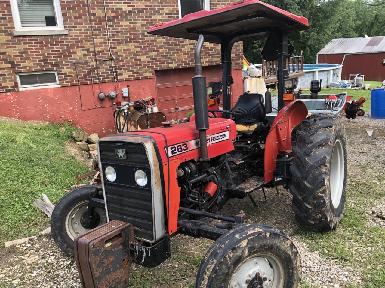

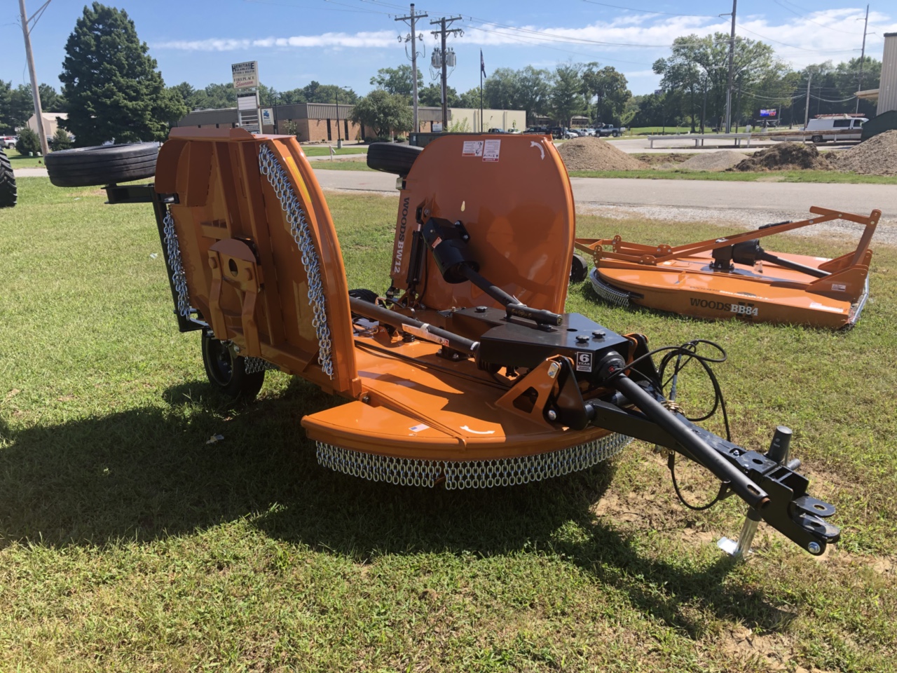

Today I saw a woods BW12 and it really caught my eye. I cut at our house and neighbors, but most os all my family has a lake house on 15 acres. That ground is hilly with flat pastures also. I知 spending a lot of time on the tractor with a 6 rotary. My tractor is a Massey Ferguson 263 (53hp pto) 2 wheel drive, front has suitcase weights, rears are filled, and I have dual outputs. My big hill is pretty steep. Steep enough you better know what your doing and forget about brakes It also grows the toughest to cut. I mow about 4 times a year. Does this tractor have what it takes. It has never thought about bogging with 6 pulling hills and weeds at canopy height.
View attachment 570935View attachment 570936
Your better off buying a used JD 25A,290 or 390 flail mower for that place as it will not be hard to handle or be too much mower for the tractor.
