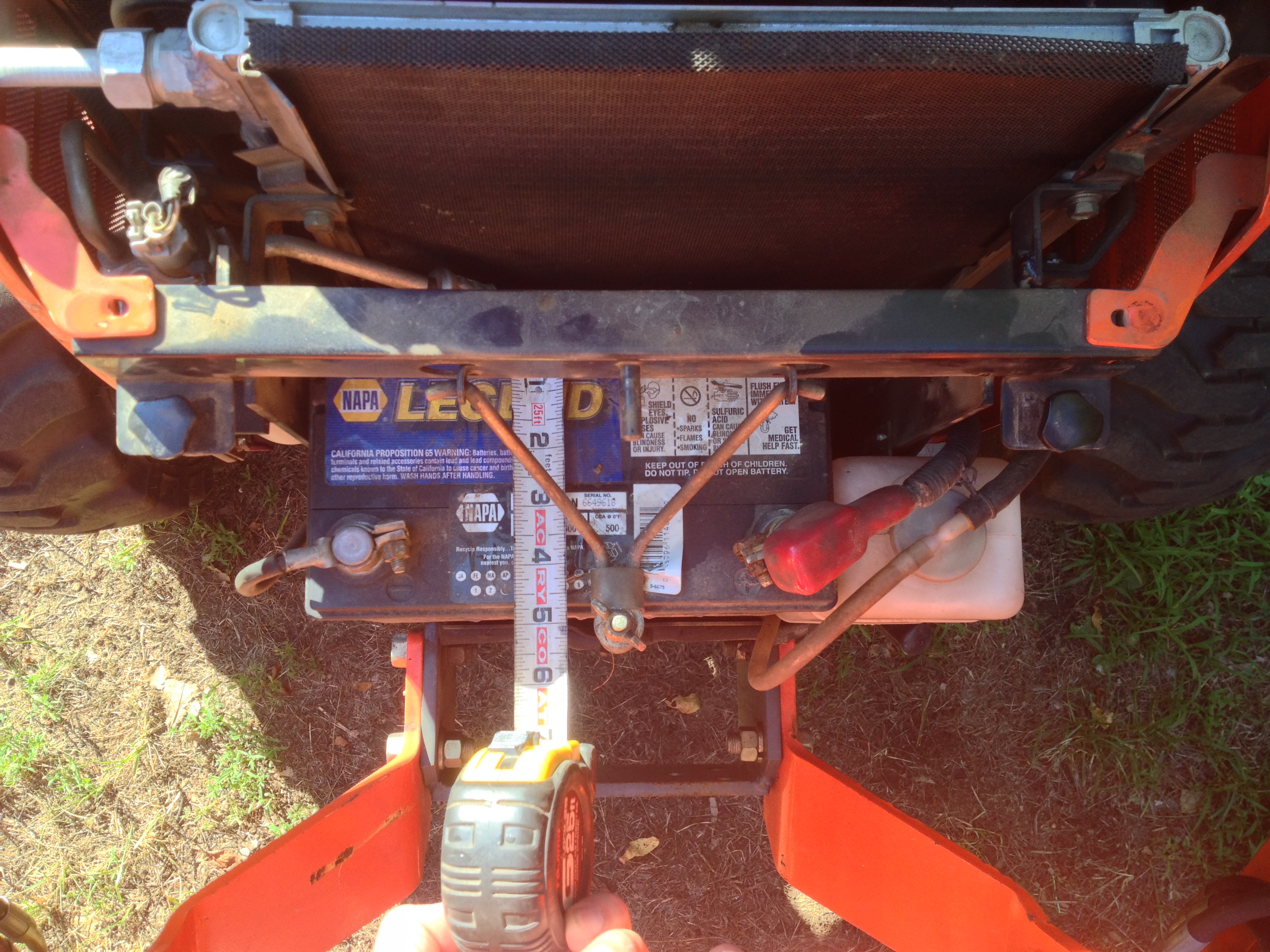

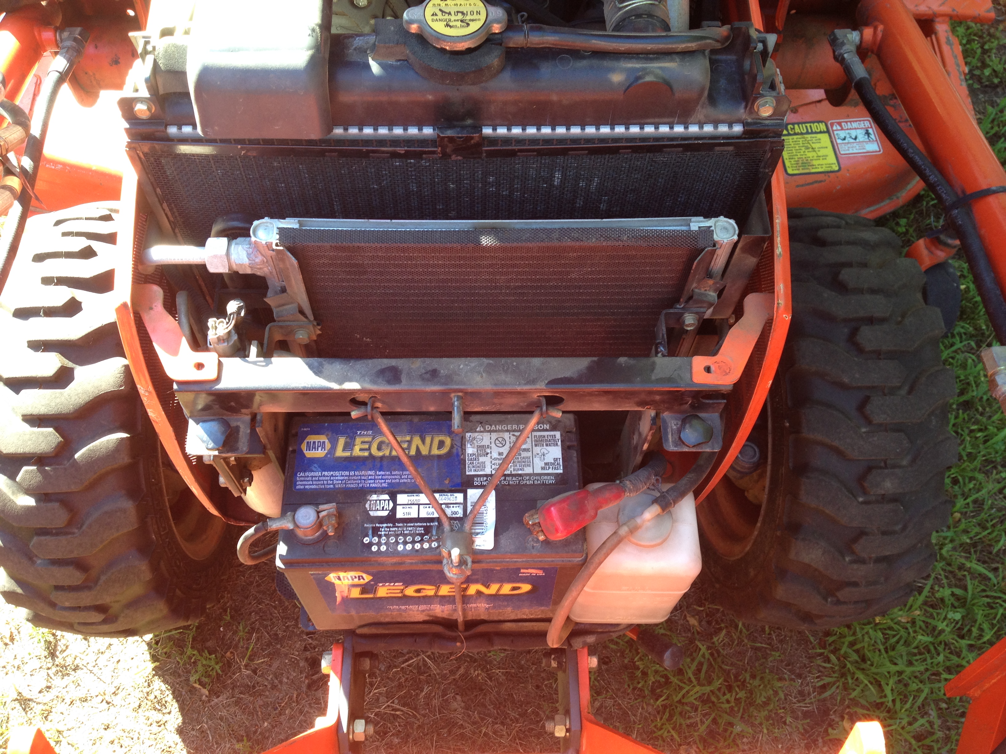

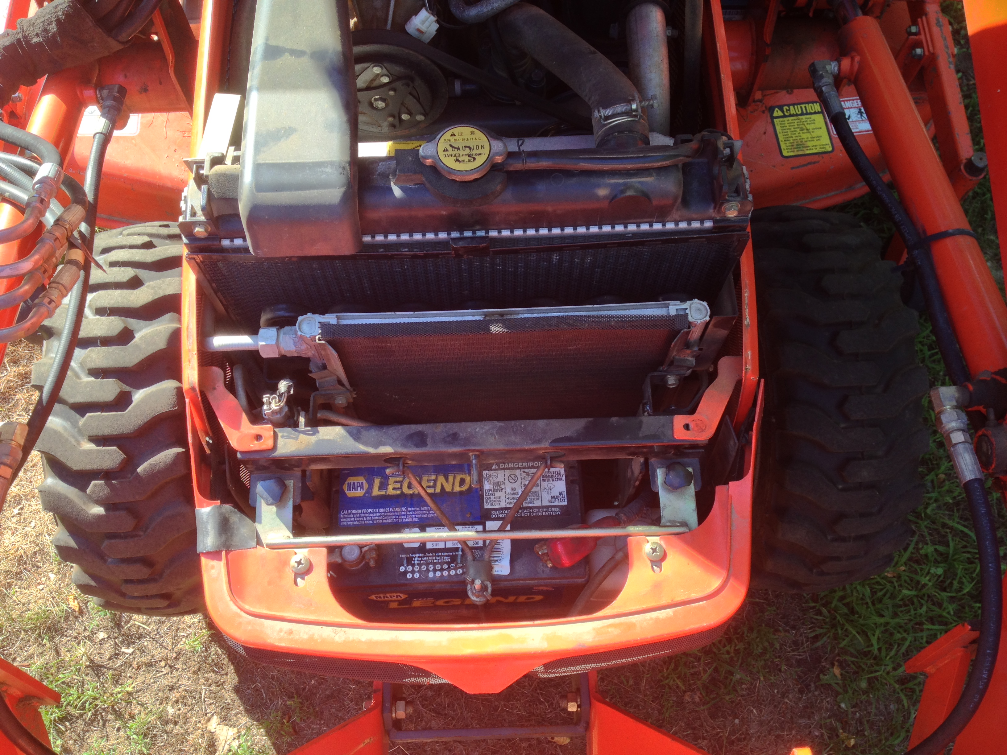

Gents,
I have a 2012 Kubota B3200 series tractor with FEL. The original battery that came with my tractor is not holding a charge and is only 2 years old. The original Kubota battery has a 1 year warranty? There is also no name on the battery, just a product number 55B24LS (51R-430). I am looking for a recommendation on a replacement battery other than Kubota. Your assistance and expertise is much appreciated.
Thanks,
Tobyone
I would worry about a slow drain. 2 years is not much. Did you check into that?

I dragged my dead battery (L4200) down to Sam's Club and matched the size and lug locations just this past fall - I've been running the same battery since 2006 when I got the tractor, so it was 12-13 years old at least. I forget the group size I got, but I picked the highest cranking current battery that would fit - over 1000 cranking amps.
   / 12 Volt Battery Replacement #28
Costco had some good pricing on car batteries but the top posts were all reversed for my tractor and my leads would be too tight to make a different battery fit.
I accidentally killed my 2 year old OEM Kubota battery this fall by leaving the ignition switch in the on position for a week and the cab light was on. I wasn't too impressed when I discovered that the OEM Kubota batteries only had 1 year warranties.
When I shopped around I found that I was going to spend 2 to 3 times more for a non Kubota battery with similar CCA and the other warranties were only 24-60 months. I ended up getting the OEM Kubota battery because it was the cheapest, was a drop in fit, and my lasted one only died after 2 years because of my brain fart moment... I decided to stick with the Kubota. I figured the Kubota batteries can't be too bad considering my 7 year old zero turn is still running on it's original 1 year warranty OEM Kubota battery...
