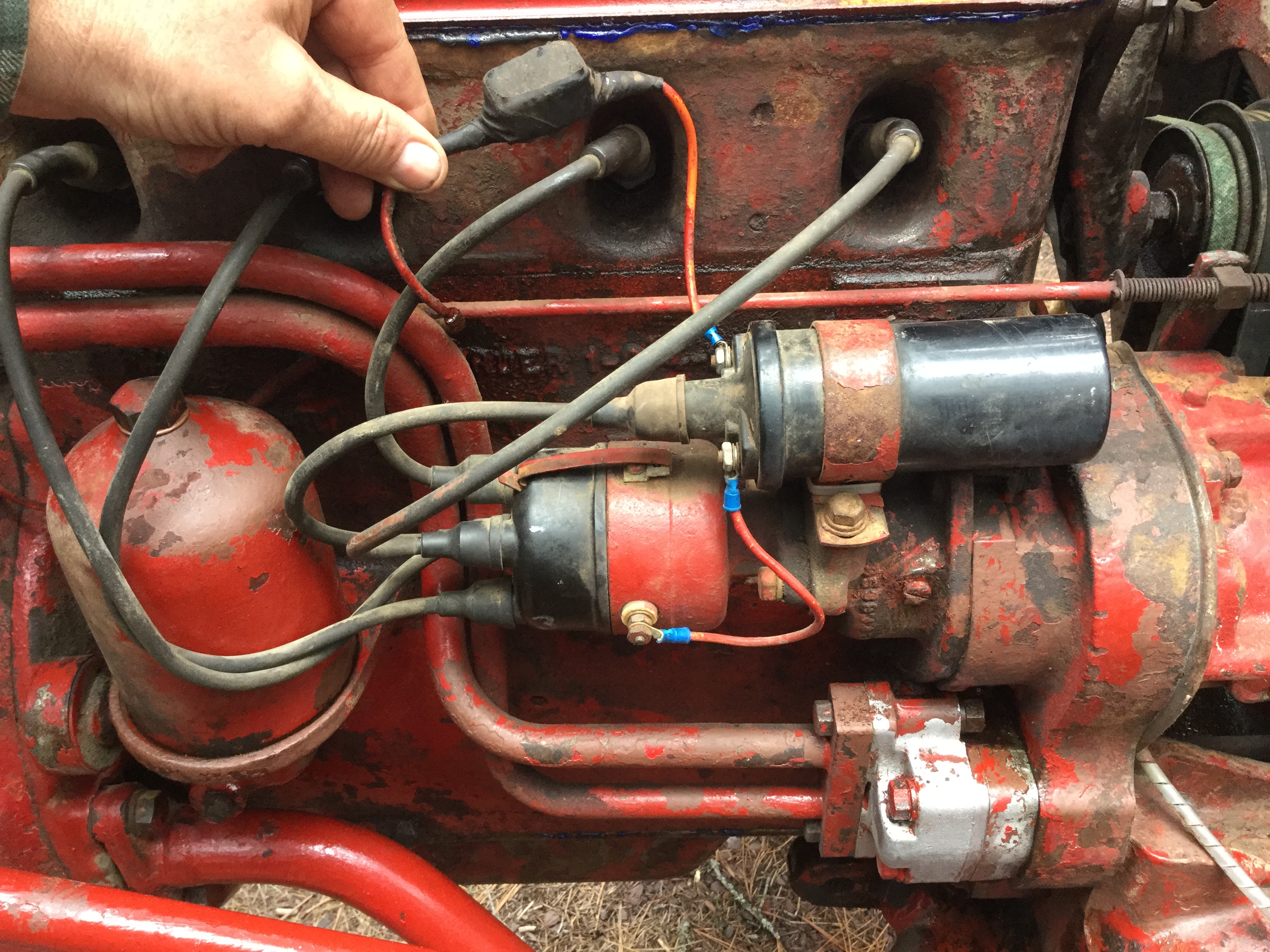

I just discovered that my 1950 Super A does not have a magneto- battery ignition was an option offered by Int. at this time.
Still haven't figured out what I need to do to do a proper 12 volt conversion- appreciate it if someone can give me a rundown on the basics. I'll probably do a rewire too.
Photo shows the dist. and coil, and a mystery box wrapped in tape coming off the coil. What is that little box?

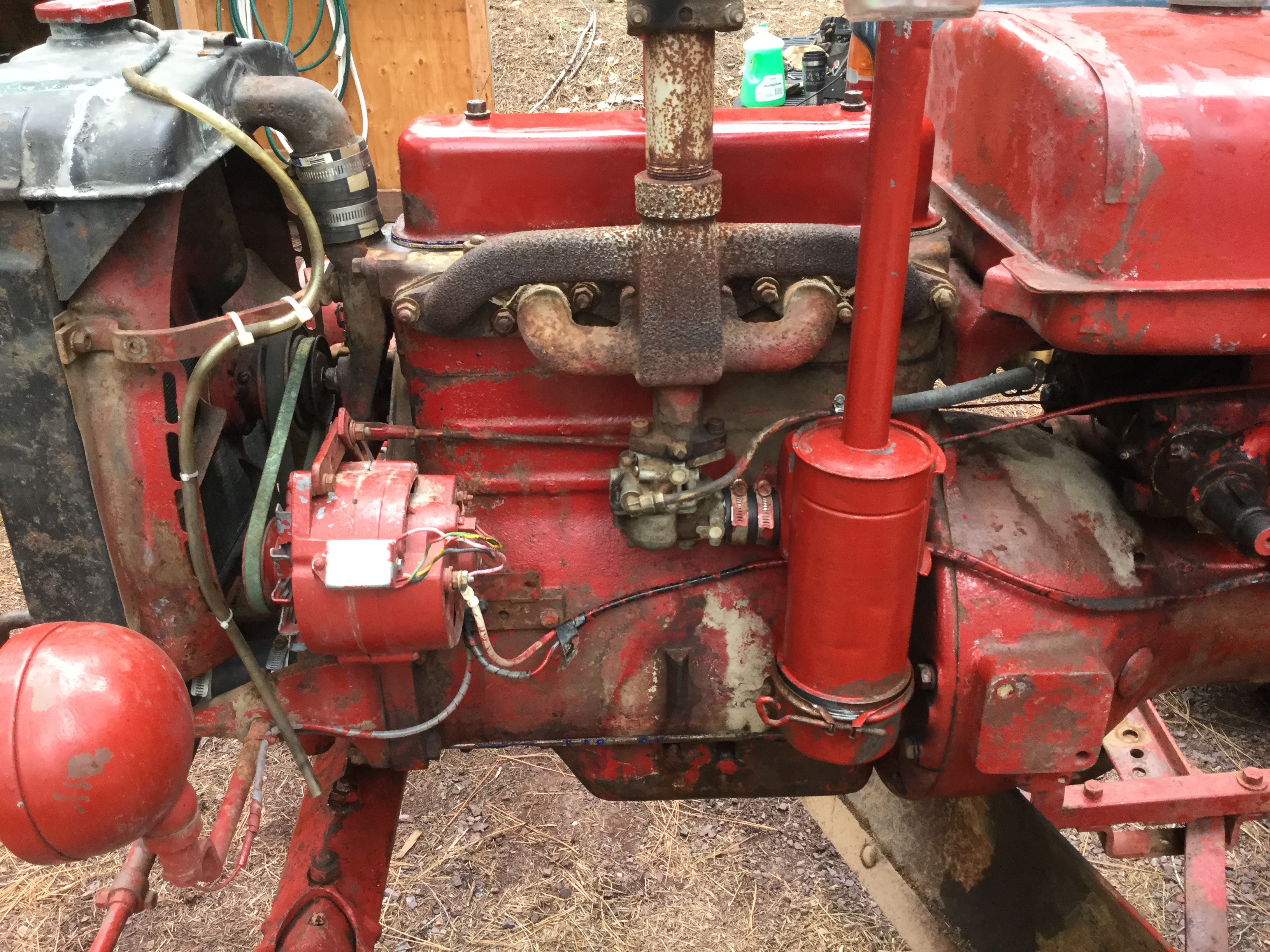

A 6 volt alternator was connected to the unit some time ago.
thanks for your time. I hope all these questions I'm asking are instructive for other Super A owners.
Edit- also- what is that little screw on the distributor mount, 2 inches below the center of the coil? Is this a lube point?

The "flat head" screw is for lubing the came gear shaft/dist. shaft..you take out the screw and replace it with a same thread grease zerk.. (its a large fitting)..you only need to put a few pumps on a grease gun in it per year..you don't want to over do it.. BobG in VA

The little black box looks like it might be a circuit breaker.
When you rewire it, shorten the #3 plug wire so it isn't crossing the #4 wire. (the two wires crossed and touching could set you up with a 'cross fire' situation.
Are you positive that is a 6 volt alternator?
   / 12 volt conversion, with battery ignition #4
I'd say that is still a 12V alternator. I'd guess the box on the alternator, is an external voltage regulator.
The mystery box wired to the coil I'd have to guess is a inline resistor, reducing voltage to 6V.
