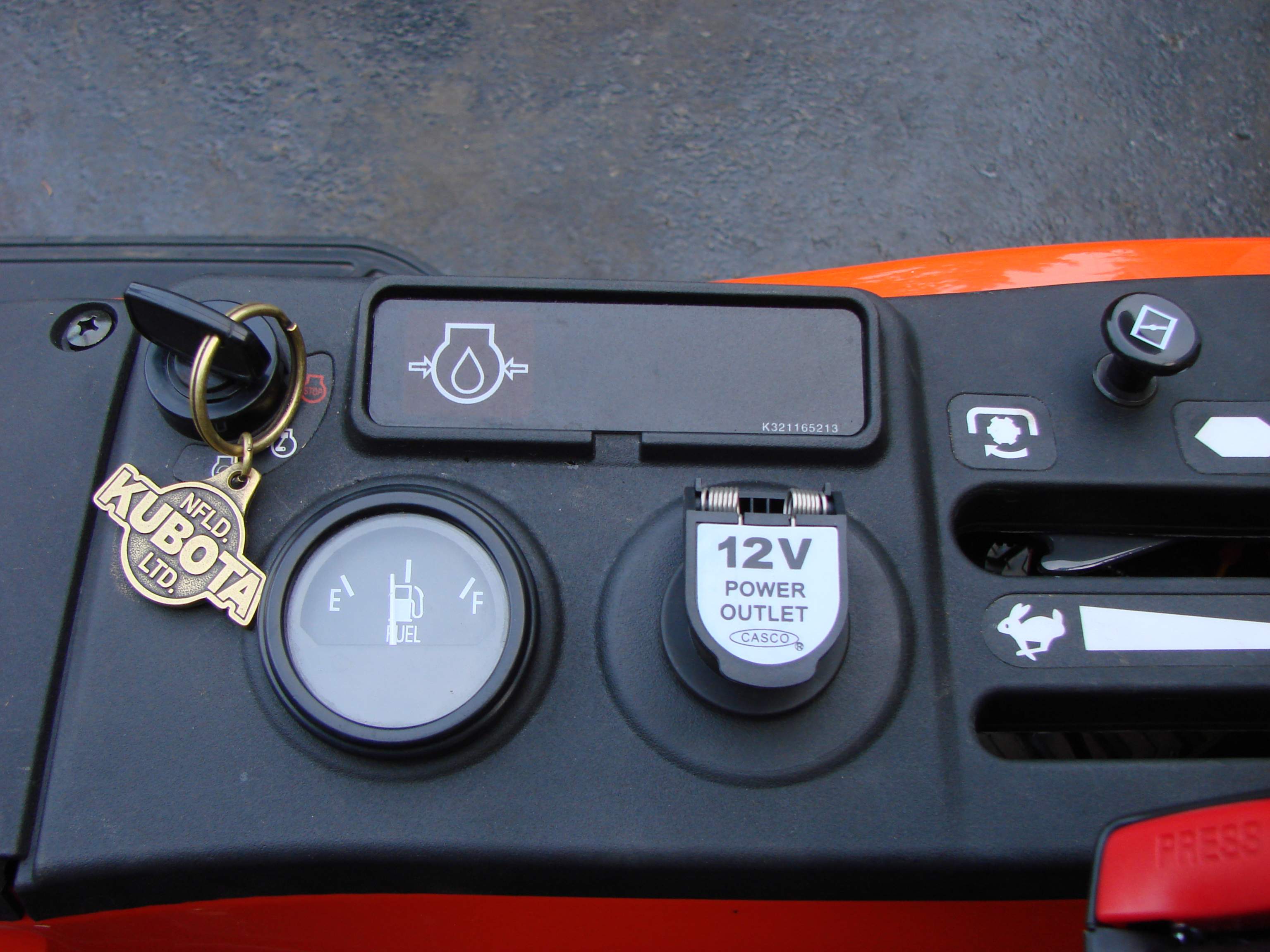

I don't know if this is the type of plug your looking for but I have used this type for years and they have lasted. It's a 12 volt accessory plug made by Casco. PN# 21825C Heavy duty. I just put one on my Mower.
