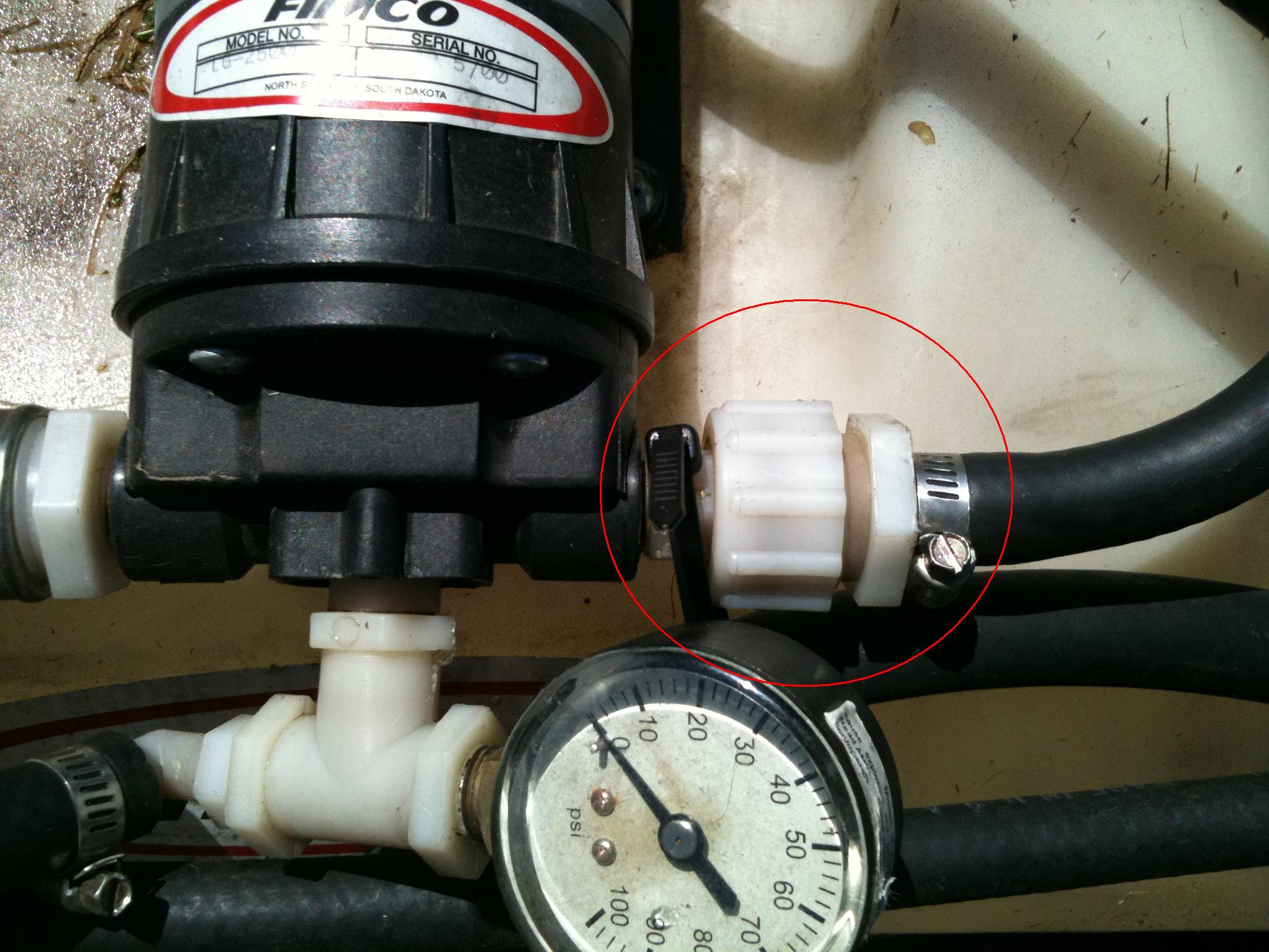

I find myself to be too busy to watch the forums on TBN like I would like to but often refer to this site when a problem crops up since there is much wisdom shared here. I have a 25 gallon Fimco trailer sprayer that I have been using for 7-8 years and I have had to replace the diaphragms once or twice. It was doing a sorry job of building pressure this morning but I wasn't planning to take the time to fix it as there was hardly enough time to do the spraying; the gauge is no good but I was able to judge by the lack of a fine misty spray.
I decided I would see if I could find a deal on a new pump since this one has some age and then when i wanted to spray I could spray. I read through a couple of these threads and reassured myself that I had always been careful to flush the sprayer with clean water. Finally my point. I noted the inline strainer and opened it up to find a real mess. Sprayed it out with the hose and was ready for a test run in 5 minutes. The spray output was restored to like new. My maintenance had been incomplete but thank God for an easy fix. I'm sure you guys all know where the strainer is but in case anyone can benefit from some guidance, here's a picture.

Oh man, that is to easy. Mine is located on the end of the pick-up tube at the far end of the tank. I have to stick most of my arm in the tank to get to it.
