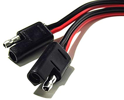

I use the same SAE 2 pin connectors I use for my battery maintainers.
Not sure what your amp draw is, just would need to make sure the connector can handle the load

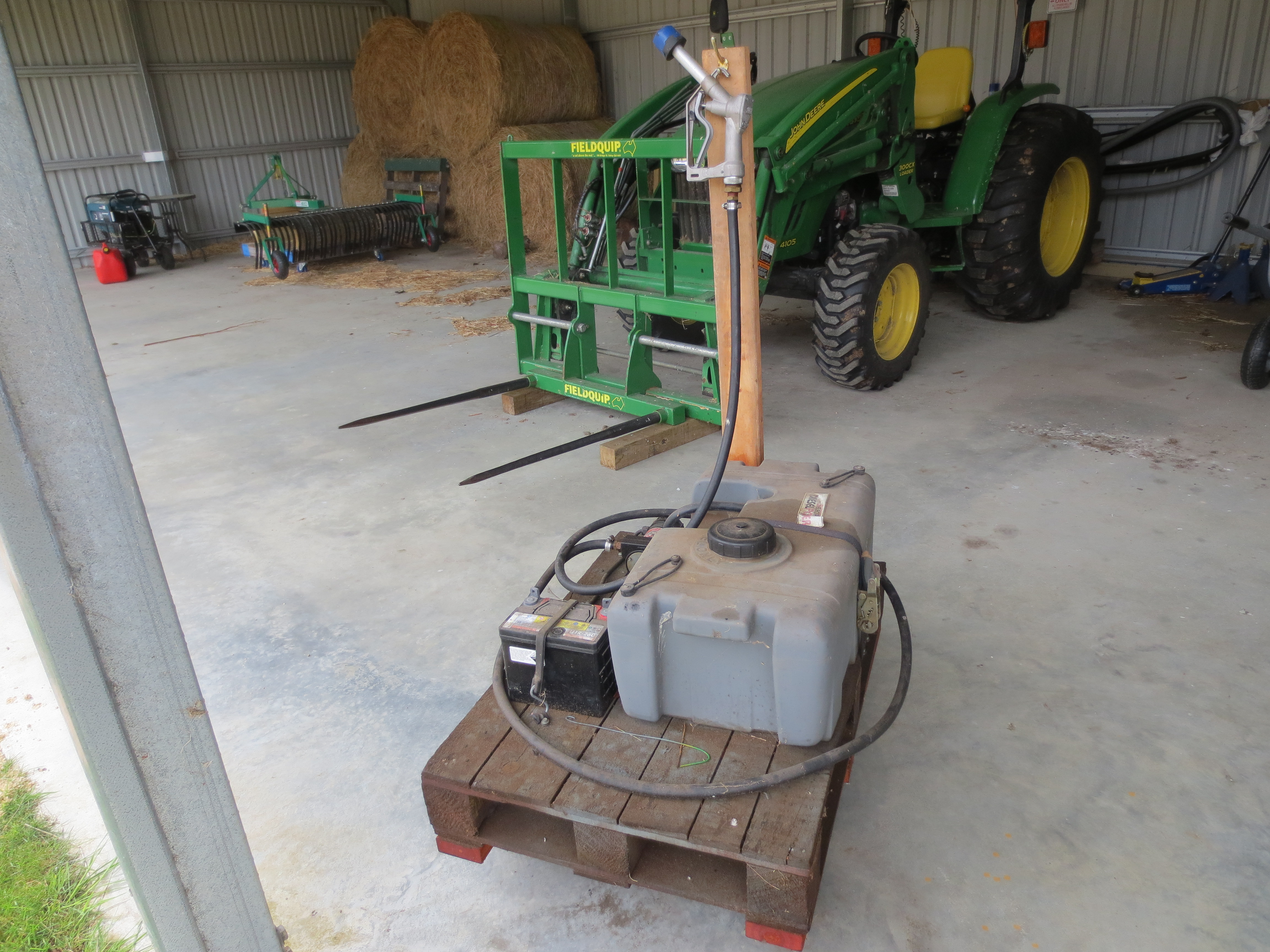

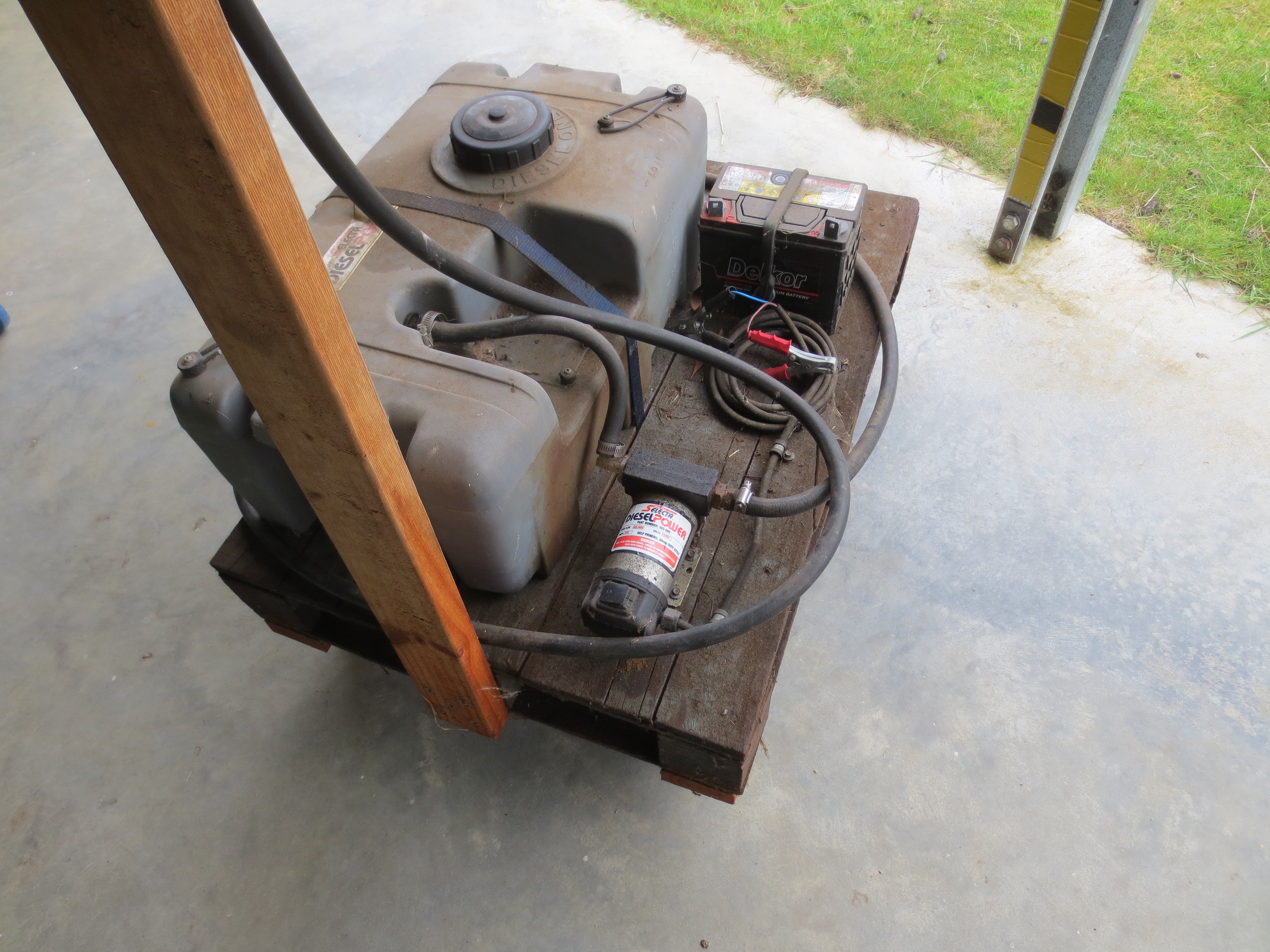

I too, originally, ran my fuel transfer pump from the tractor battery = direct alligator clips to the terminals and, yes, raising the bonnet to access became an embuggerance.
I thought about running an easy-access 'jack', then discounted it as it would limit me to just the one position to attach. The logical solution was to buy/em-place a dedicated 12V battery on the fuel transfer station, keeping the alligator clip hook-up for the pump. When not in use, the clips are removed from the battery. A trickle-charger keeps the battery charged if it indicates that its low.

These are what I referred to, SAE connectors

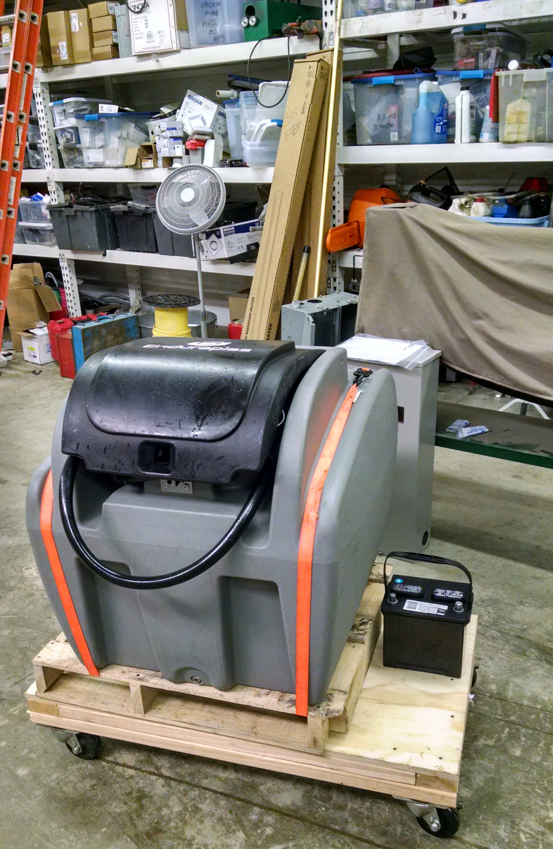

I also keep a spare 12v battery next to my tank. It only needs to be recharged once a year. Very low draw.fuel 1.jpg

I also keep a spare 12v battery next to my tank. It only needs to be recharged once a year. Very low draw.View attachment 605739
Sounds great and an option that I will keep in mind. Thanks
Looks like a good one. Thanks
