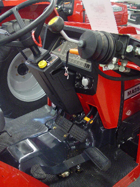

For what it's worth, here is a picture of the MFHydro on a 1440
   / 1200 vs. 1400 Series - Differences ???
#20
Worth? The last time I checked, a picture was worth a thousand words! /forums/images/graemlins/smile.gif
Thanks for the pic!
