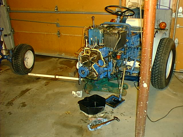

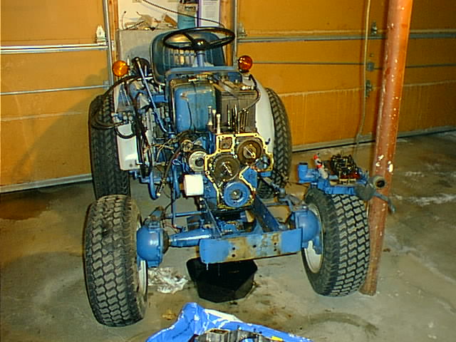

Sounds like there's a lot of good experience out there. The fuel injection timing people are thinking the same way I did on the first partial tear down to check the timing and gears on the front of the engine. The engine oil didn't show any chips to the naked eye but then again that drain plug isn't at the bottom of the pan. On reassembly, it was discovered that one of the injectors didn't squirt fuel; it also contained metal chips. Not good news. After getting that fixed, we're back to the same clang and no power. SteveV

Steve,
Sounds like you may be only running on one cylinder. I had a "B" John Deere once that after it sat awhile the valves would stick in one hole. She would still run but not much power. Did you run a compression test on it?

Steve,
I had a rod bearing go bad in a car engine once. I know this for a fact becuse I took the engine apart and could see the damage. All that was left of the rod bearing were thin slivers of metal. In my case the engine would still run (even at idle), it just sounded awful! I would think that this would apply to tractors too. A bad rod bearing will sound awful, and it needs to be replaced, but the engine should still develop power. After all, the piston is still moving up and down under pressure from combustion.
Now of course you mention metal chips in an injector. I don't know much about diesel injectors, but it seems resonable to me that something in the fuel system broke for these chips to get in. Is there a way to see if the injectors are still squirting fuel? I also like the idea of a compression test. It's easy to do and tells you a lot.

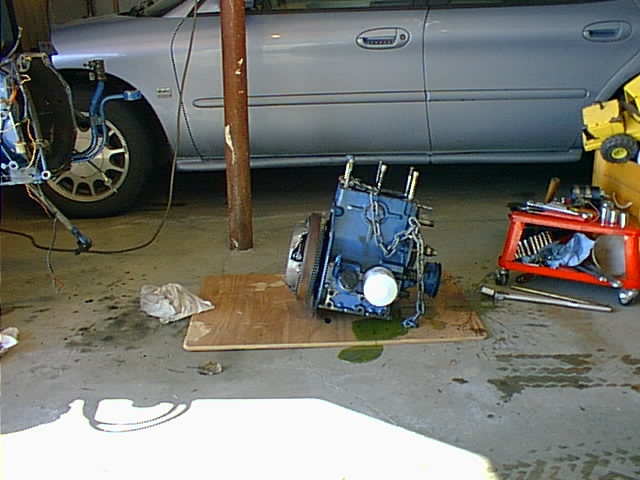

Well, the engine is on the floor in this picture. As removing engines go, this one is pretty straight forward. The project will be slowing a bit, since the flywheel is held on by the metric equivalent of a 2 1/2 inch nut! Nobody paid much attention to the maintenance points on this design, the antifreeze dumps into the framerail, the engine oil dumps on the front driveshaft, and the hydraulic oil runs down the return pipe when the fluids are drained.

Did you notice if the cylinder walls have any damage.
I'm still hopeing its not a connecting rod.
Sure hope you have a work bench for the rest of the tear down.
