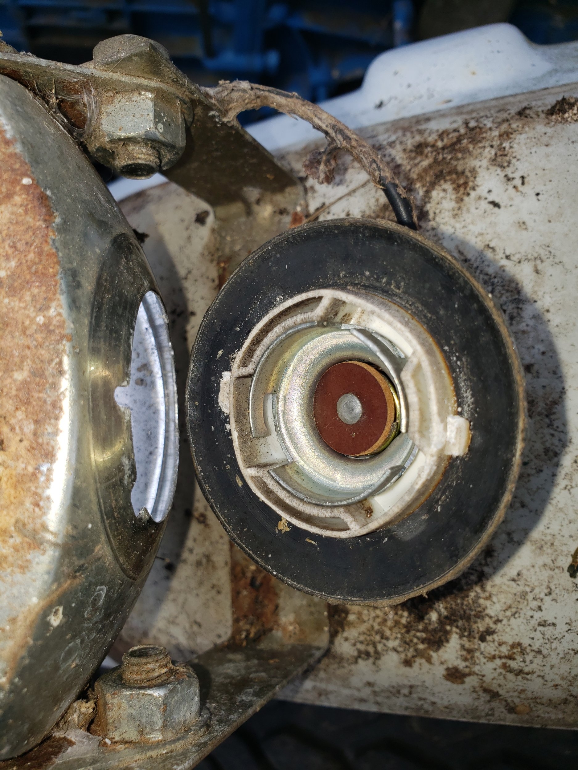

I pulled the light switch out on the little Ford 1210 a couple months ago, driving home from across the street. After a few minutes one of the fender lights went out, and about 10 minutes later the second fender light went out! Today I pulled one of the light assemblies off the fender to get the bulb number. The voltage and wattage are listed on the bulb but (12v 25w) no part number. So I went looking, and found discontinued on dealer sites. I went to Fleabay and found what looks like the correct bulb EXCEPT is has dual elements! Mine only has a single element!
Anyone know where to get the original style bulb?

Have you inspected your socket to see if it in fact has 1 contact or 2? Factory shows it has 2.
Good luck!
/ 1210 Fender lights
Good luck!
It has a single element socket, and the light switch only has one position, so I am thinking it is original.
Thanks for all of y'alls help!
David from jax

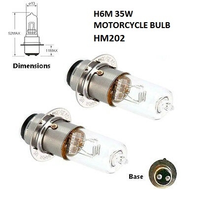

Bummer I didn't see this thread sooner. The Wagner HM202 is the Halogen Version, and at 35W outshines the regular P15D bulb by nearly 2X. This bulb is very common in the Japan made tractors of our era, 70s thru the 90s.
The OE bulb manufacture is Stanley.
This HM202 or H6M with P15D base, basically replaces all of these bulbs. (y)

The issue with your replacement is it is a two element bulb. Mine is a single element bulb. The PS039 doesn't match my bulb. That looks like a Hinomoto bulb? Mine has tabs on the outside of the circle that is soldiered to the base.
They are some interesting bulbs in that picture!
David from jax
