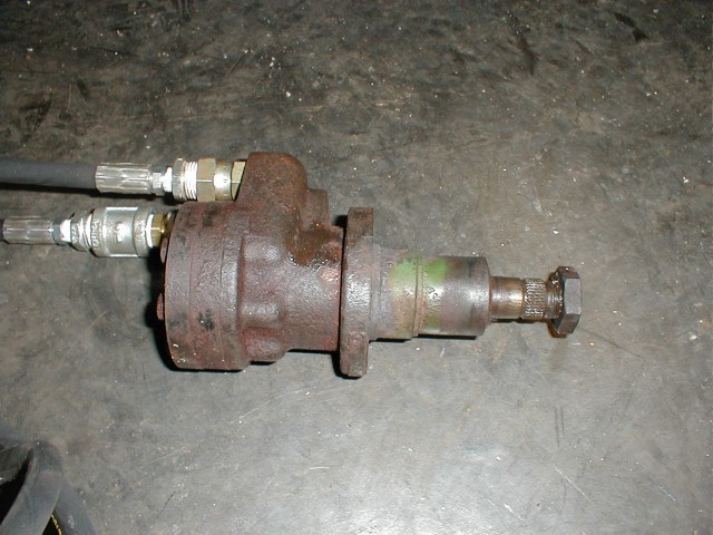

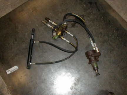

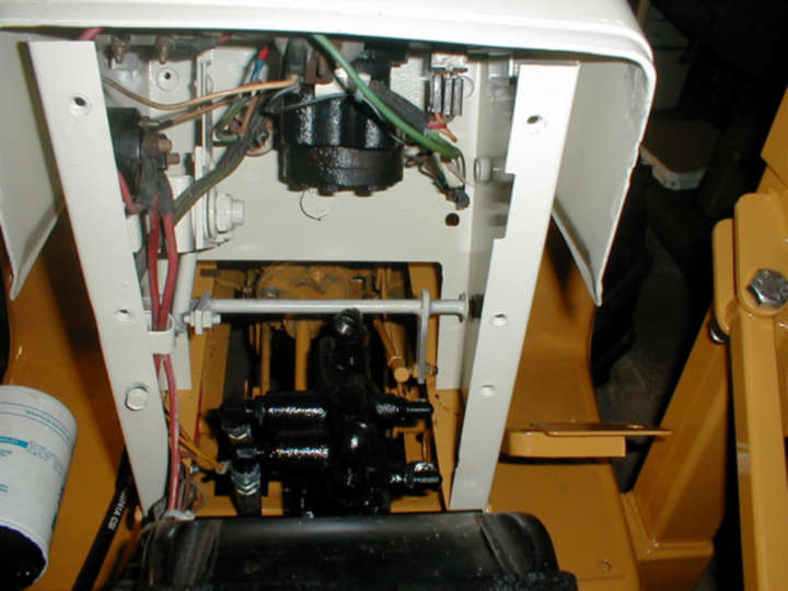

Thanks for the info, I really appreciate it. Your work is extremely nice. I like your hydraulic steering setup. Could you post some more info and pictures of the steering system. I assume it works off of the same pump as the rest of the hydraulics. Did you use a Charlynn valve to control the ram?

The power steering came off of a John Deere combine. I believe that IH is the same. Here are some pictures.
