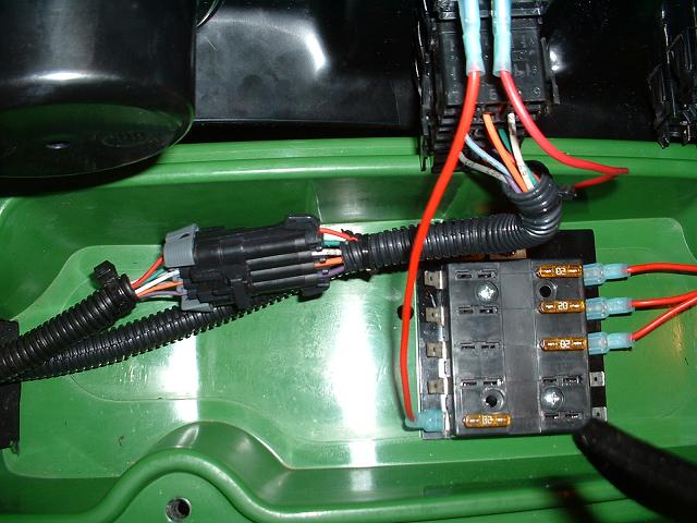

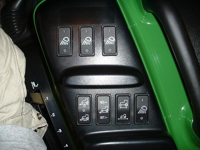

As bloomingtonmike said a Dremel will work just fine I have added 3 power switches to my Jd 3120 and have had no problems with it.I do not have a relay on my tractor but my set up includes a 8 ga. wire from the battery to a fuse panel uder my console.have had not problems with burning up wires.I am running a heavy duty beacon light,3 ROPS mounted work lights,and grill strobes not mention forwarding and daul rear work lights.

It took me a while to remember. I was walking thru Oshman's Sporting Goods in Texas and found the lighter plug-ins. They are held in with screws.
I had to cut the holes in the console but that was very easy. The console comes out in about 5 minutes so that was also easy. It takes a phillips screwdriver and a 10mm socket with a small (3") extension to remove the console. All wires are plugin.
My set up works great but if I had it to do over I would set a fuse block under the console like Matthew3120. There is plenty of room and his looks like a factory installation. I would move his back a small amount to make room for the lighter plug-ins.
