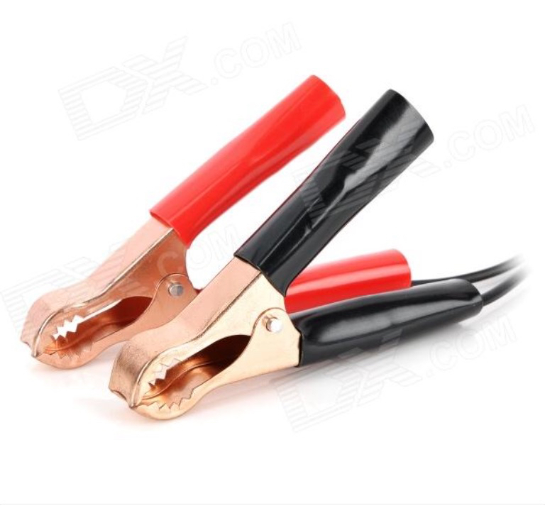

I just did a 15 foot cord with med size clips, just clip the hot to my starter lug were the battery cable connects, the the ground to the frame near it. I use mine on different vehicles and tractors so it's nice to have a universal connection.
