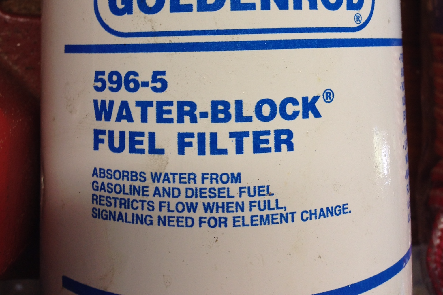

The filter is a GoldenRod 596-5 Brand seems to be "DL". Bought the filter a few years ago at TSC so maybe they have changed suppliers.
My system worked well and shut itself down as designed when I got a water contaminated batch of fuel. Since then I have just been using 5 gallon cans of diesel instead of the 30 gallon tank so don't use it anymore even though I bought a replacement filter. I'd be happy to sell you the whole outfit but doubt shipping would be economical.

I used to know what the micron rating meant (when correctly described). I believe the old spec (still frequently used to make the filter sound better) is called "nominal" which means a 10u filter will catch 50% of 10u particles. I do know that a 3u filter would have to be pretty large to permit reasonable fuel pumping flow. I had a 3u hydraulic filter on my previous tractor that was I believe 3u (b3) that filters 99.9(9?) of the 3u particles at still only 3 gal per min. The thing was larger than a loaf of bread. Anyway.... I probably shouldn't be discussing things I am not sure of.
