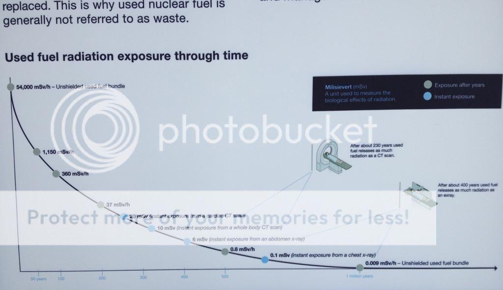

Used fuel at 250yrs gives the same dose as a CAT scan per minute. Not a lethal dose.
The rock formations are stable. The storage flasks are very robust. There is not going to be used fuel bundles laying around for the kids to find and bring home.

I never said nuclear didn't have a place but no one has answered the question as to how long before I can sit beside "used fuel" without thinking about it .... 250 years being the same as a CAT scan tells me (and most other people ) absolutely nothing .... how many years before it becomes the same as the normal background levels ?

Maybe I can help with a few questions (or start arguments). I've worked in nuclear engineering for over 40 years. My degrees are in Mechanical Engineering but I took several post graduate courses in Nuclear Engineering.
There are differences in waste from different types of reactors, but direct exposure to fuel just out of a reactor would kill you in a few minutes. However, high radiation levels go hand in hand with short half lives. In 50 years the radiation is reduced by more than 1000 times. Because we are so conservative in protecting from radiation, we talk about protecting the waste until the radiation level is less than the Uranium ore that was originally mined. This generally takes 1000 to 2000 years. However, it takes a lot less time before it's not a major hazard. Say a few hundred years. You wouldn't want to build your house out of it but you casually be around it. If we encase the spent fuel in a geologic formation that has been stable for millions of years, there isn't much risk.

thank you for a straight forward and honest answer to the question ... 1000-2000 years to revert to "normal levels"
the "not a major hazard" and a few hundred years are ambiguous (but understandable as you specified that there are several types of reactors and therefore several levels of radioactivity)

For those of you terrified of radiation. 5 rem or 50mSv is the legal yearly max dose for a radiation worker. If somebody sat on a 200yr old used fuel bundle while they ate their lunch. Or had a heart CAT Scan, the radiation dose would be less than half of the yearly safe max .
Used fuel "Radioactive and dangerous for 100,000's of years". Just a bunch of lying self serving rogues in Green Peace.
