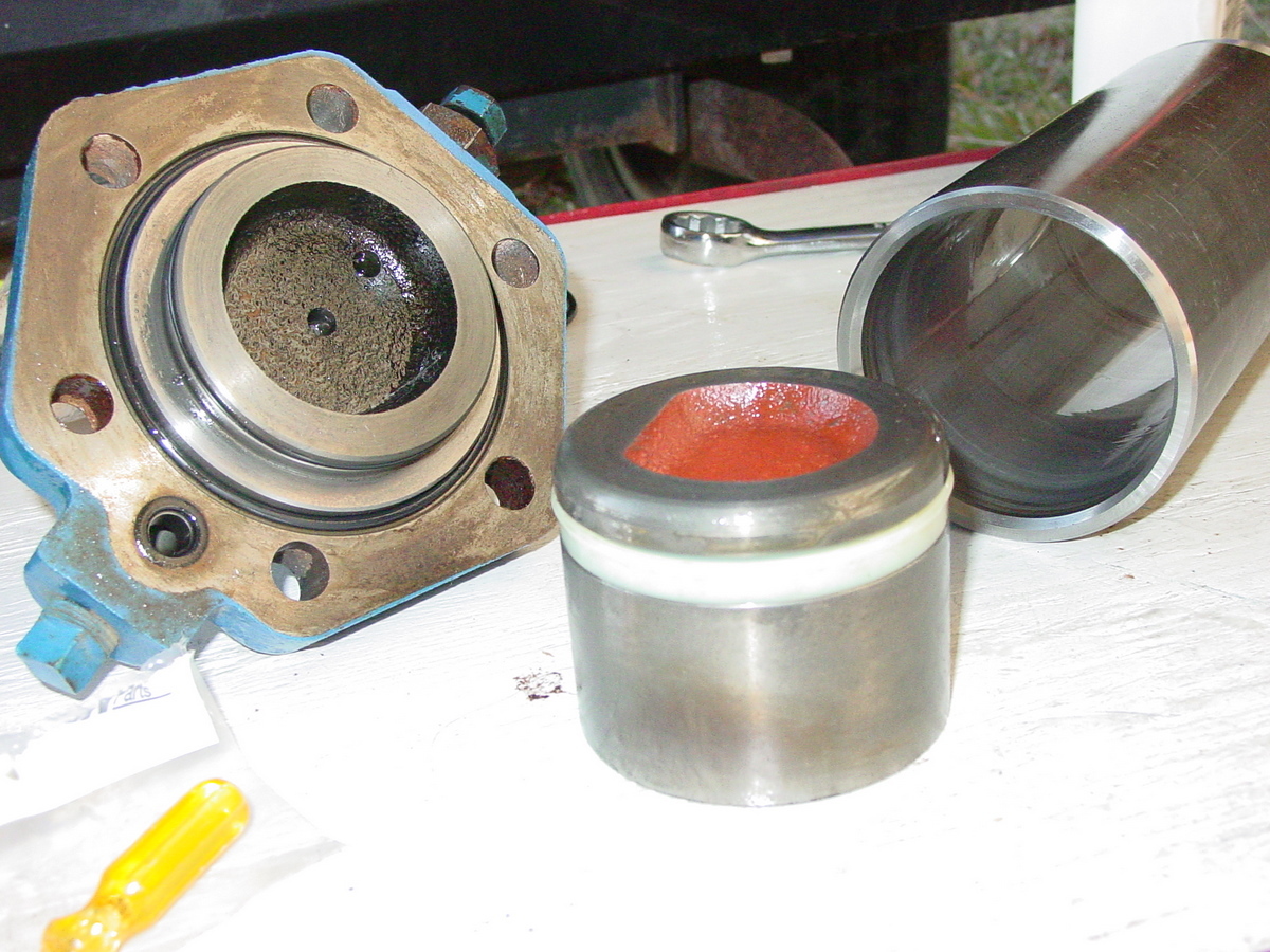

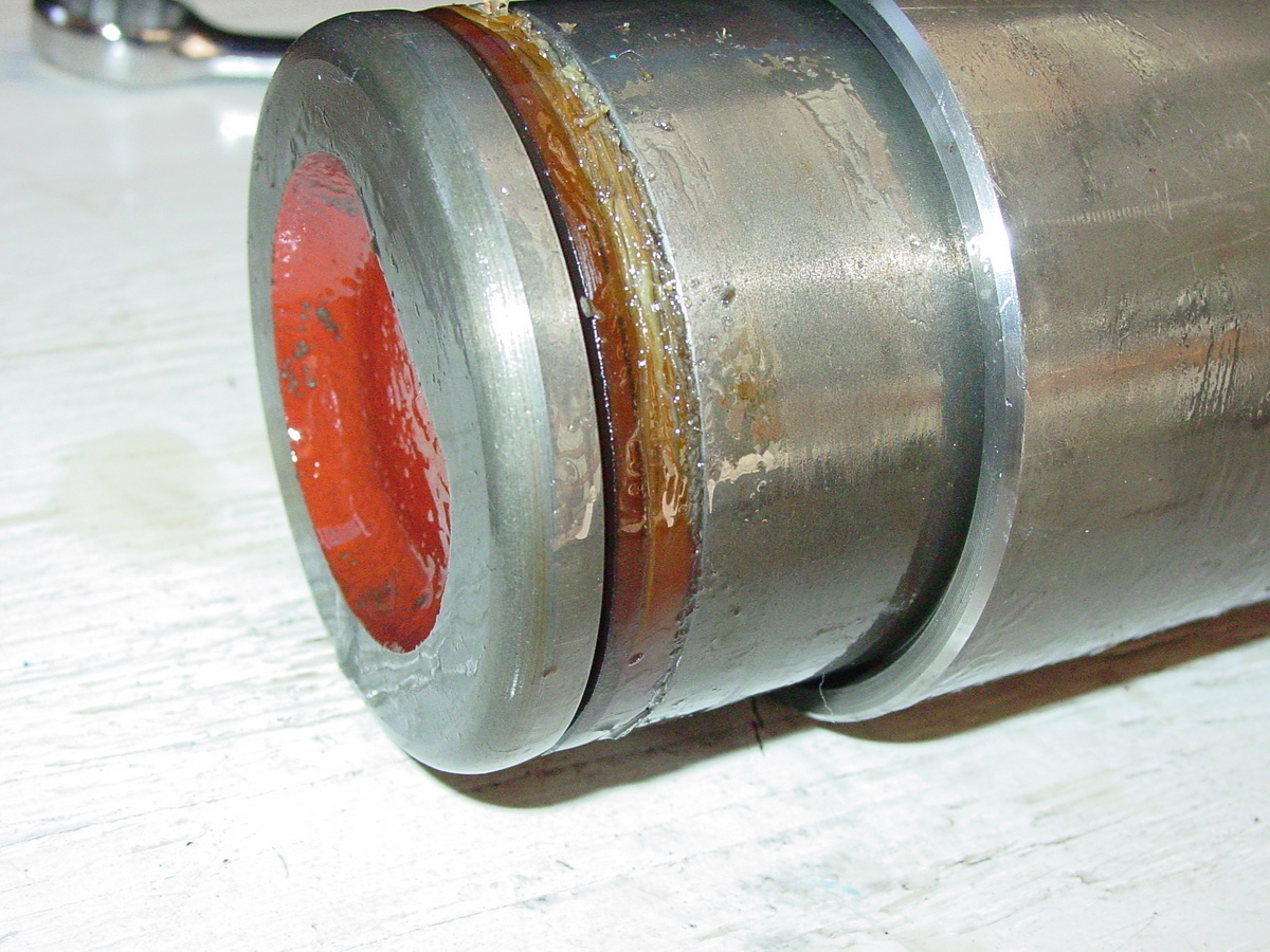

Ford 1300, I need the seal for the piston in lift cylinder. where might I get one from ??? thanks

DSC04343.JPGDSC04341.JPG[DSC04335.JPG?.....seal maybe?,..1200 X 900. was at bottom of these pictures...?.....on messicks (website won't let me post the complete address) at ?sectionId=9393&diagramId=57923_322660...????part no. 19

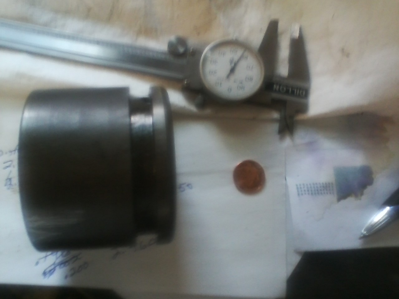

Take the seal off the piston, get a few dimensions of the groove and the bore with calipers or micrometer. I may have that seal, pm me. Looks common.
/ 1300 hyd seal #6
Common ID and OD, there痴 a difference on the seal height though (double check that groove width of .360?. My catalogs show 4 different choices by groove width...... .260? .275? .433? .519?
Best bet is to check through your OEM tractor supplier, if no luck I can fix you up with something that works.

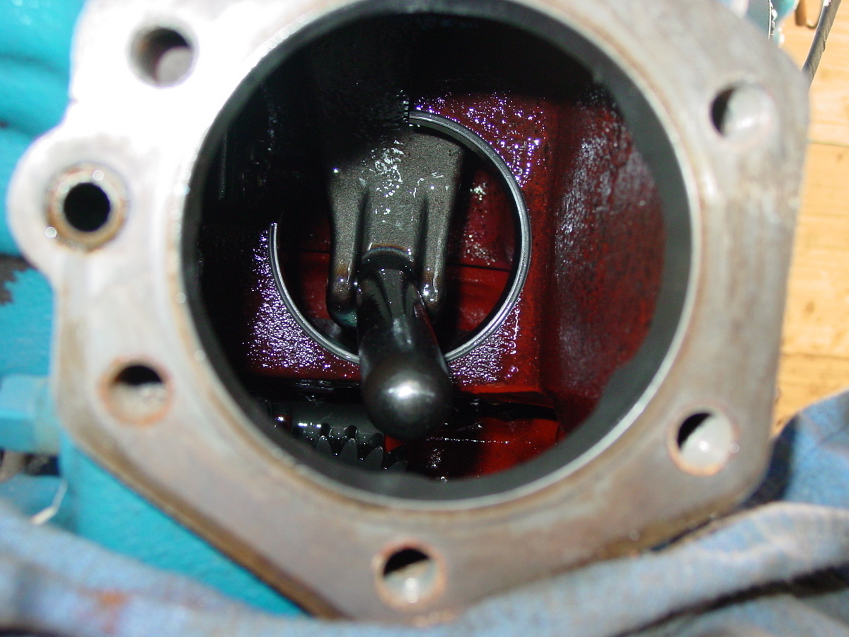

OK, so`, the lip on the seal goes on the pressure side for lifting, how do I hold the pushrod inside up to get the piston to it ?H=CONFIG]662000[/ATTACH]
