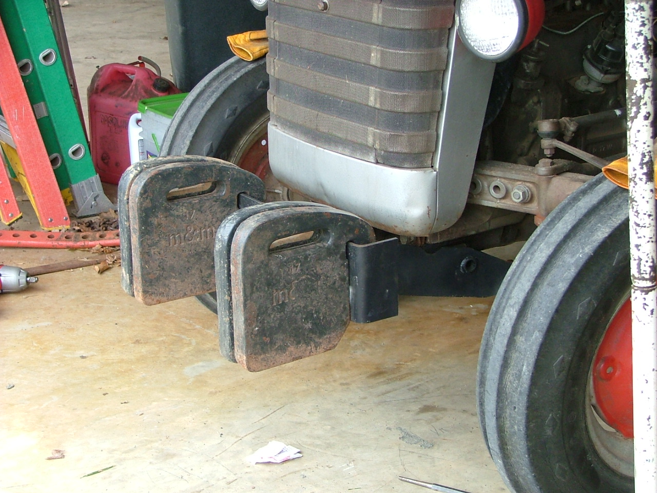

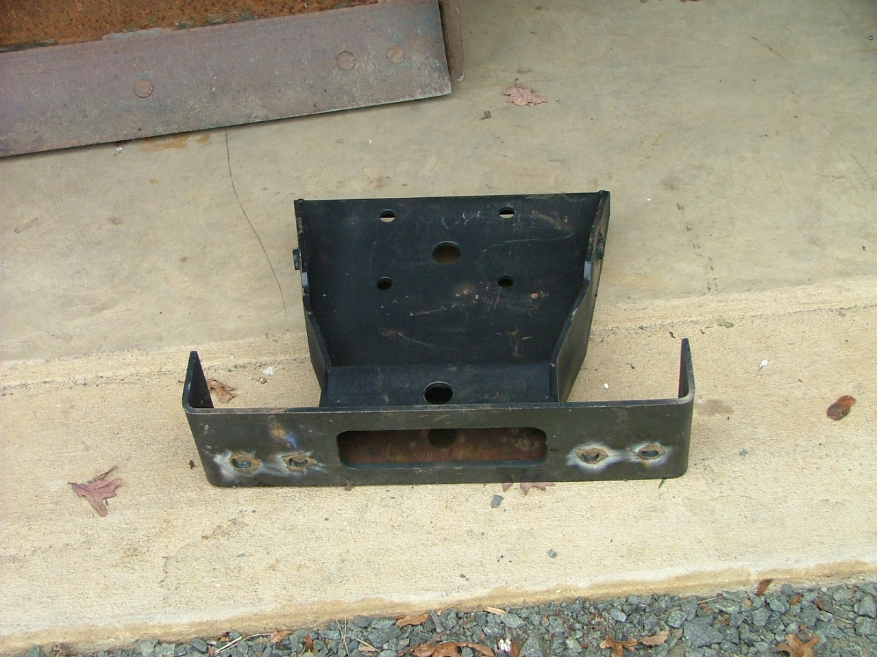

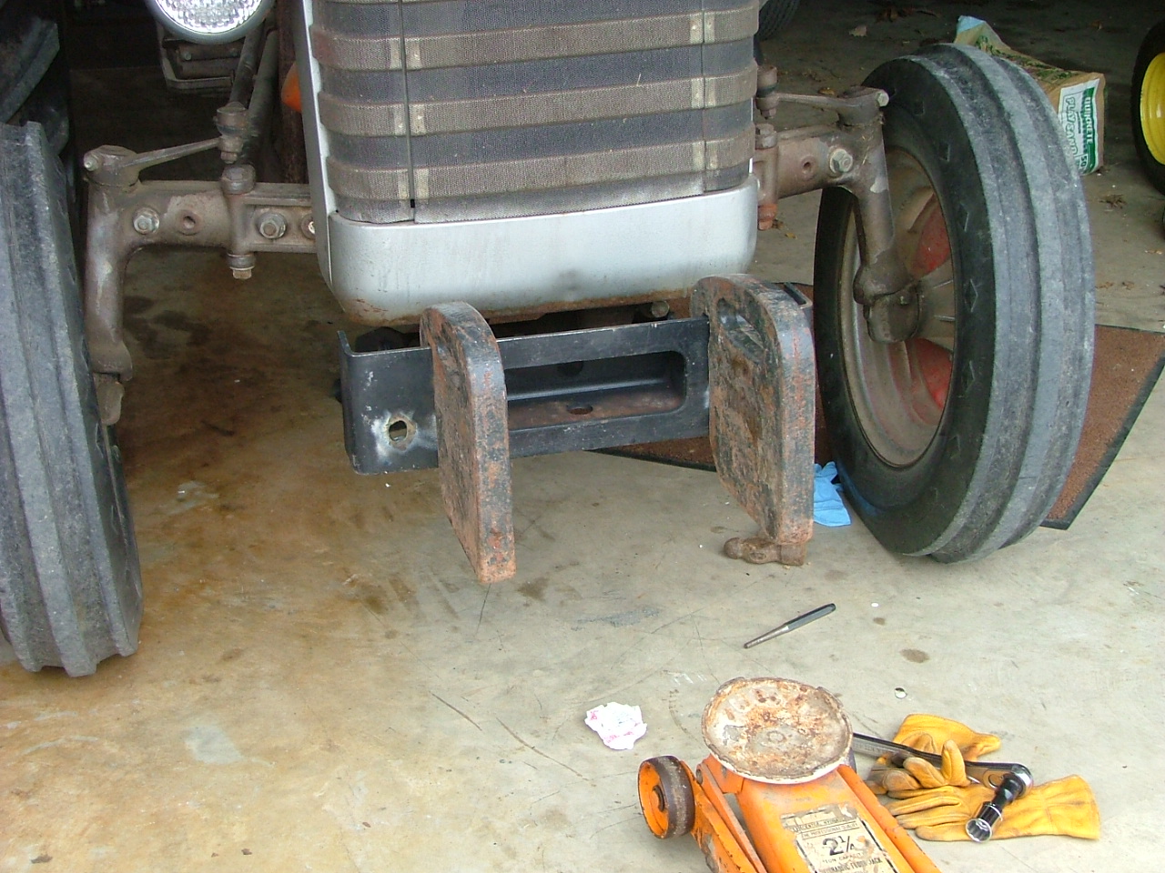

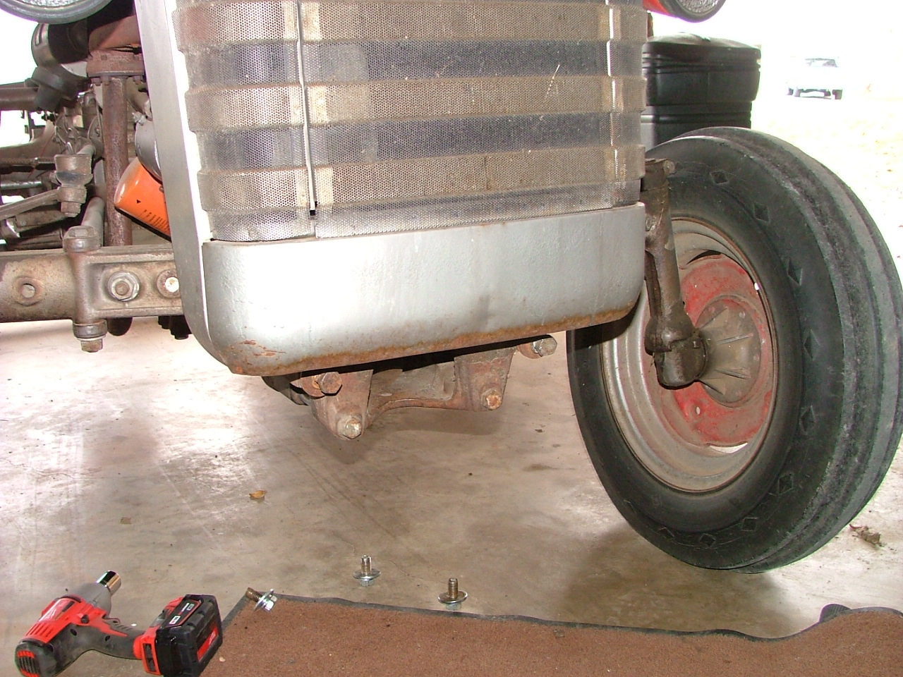

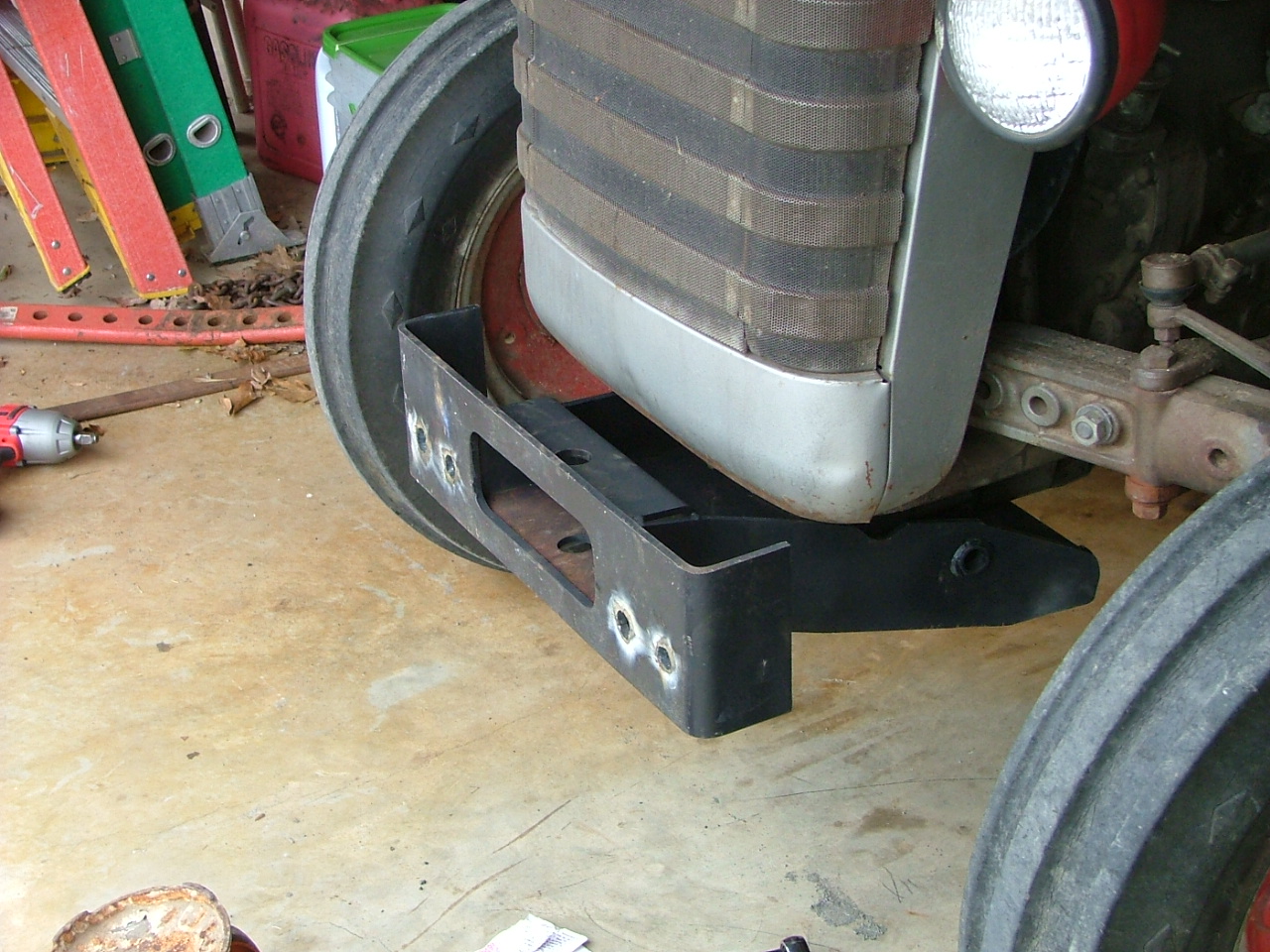

Got the bracket, had to burn some holes in it so the Mahindra weights would bolt on..I have a 7ft extreme duty box blade on the back that weighs around 6-700 lbs...now holds the ground good. Try to upload some pics. BobG in VA

I remember you saying 2"x5/8" bolt but what threading?
   / 135 Weight Bracket and weights...now on...
Scott...not really sure...I just got them as TSC out of the bin...they fit..its not a fine thread...sorry..You can look up under your 135 and see the threading..it may help you.BobG in VA
   / 135 Weight Bracket and weights...now on... #4
It would be 5/8 - 11 which is a standard coarse thread.
   / 135 Weight Bracket and weights...now on... #5
Scott,the manual says 5/8" X 2" NC, Hex
NC is coarse thread or 11 thread per inch. NF is Fine thread = 20 thread per inch. You could use TSC's common bolts sold by the pound. Grab some 5/8 flat washers too.
You will have plenty of "purchase" with the 2" bolt. I used one flat washer (against engine frame) and one lock washer (against the bolt head). Not ever intending to have it come loose. BobG in VA
