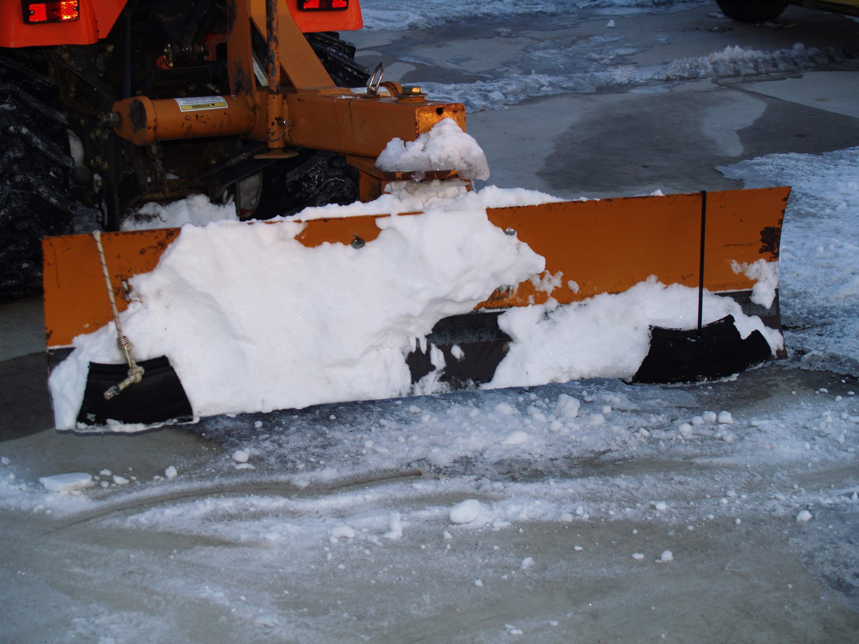

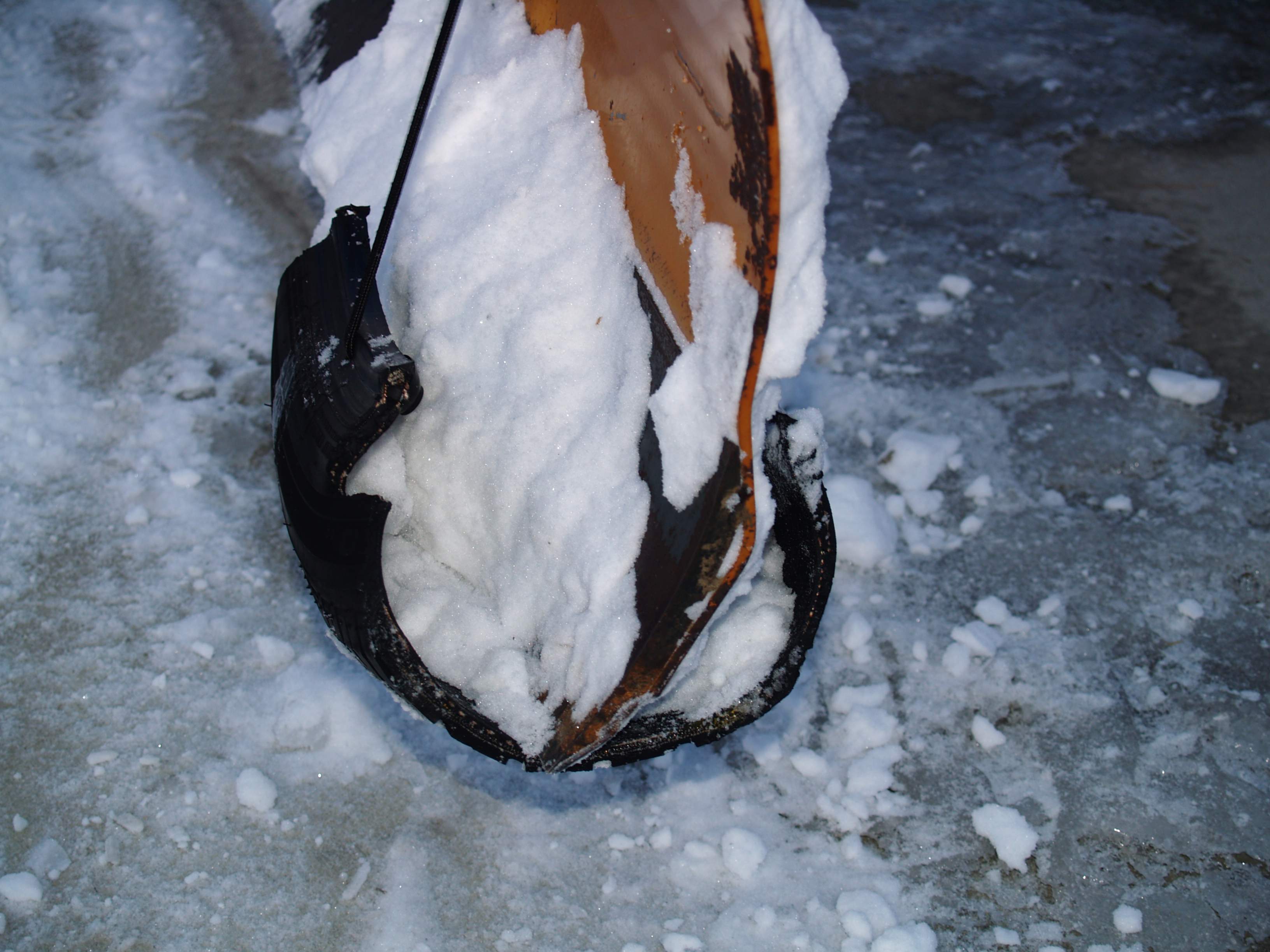

I was always pushing gravel with my blade as well. I cut an old tire into 6" lengths, put one on each end of the blade, secured them with bungies. Worked great. Now the blade skims just above the grave and does not ride up like a reversed blade.
If you get a chance could you post some pics of this?

Nice pictures AJE:)
