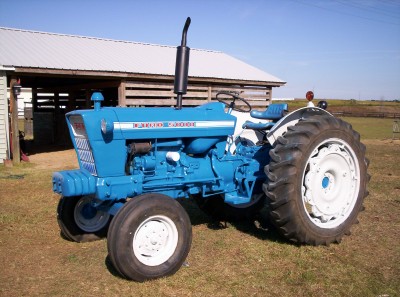

   / 140 acre farm, used tractor, skidsteer? #19
With respect.. that's a very generalized statement.. to the point that it may be simply incorrect.
Age alone is not a good determining factor for wear on a machine. Age alone does not account for corrective measures and maintenance and repairs performed during that time frame.
I will site 2 examples.
I know a fellow that bought a vintage tractor.. it was in a warehouse stored.. new from the 70's still in a shipping crate from the manufacturer... He bought it and assembled it. Tractor would have been about 25+ years old.. and had but a few minutes ont he time clock... Worn out? Yeah right.
I maintain and care for my antiques.. My 1975 ford 500 is in better shape than much of the road construction equipment that my day job uses.. and the bulk of it is only 3-10 ys old.
Use and maintenance makes a huge difference.
A good owner can keep an older tractor working like new.
An abusive owner can absolutely ruin a brand new tractor in about 1 hour.
I've seen it happen.
Refurbshing my ford 5000 took me 2-3 months, of casual night and weekend sweat equity... and less than 600$ worth of parts .( mostly bolt on stuff.. new wireing, chaseing a few leaks.. getting charge system working. a bit of welding and tin work.. some nut/bolt issues.. linkage adjustments.. and servicing... Muffler.. some gromets.. etc.. lots of cleaning.. and paint supplies.. belts.. etc.. )
Here's a before and after.
Soundguy

I'd like to add.. that's not a 'dupont' refurb either.
You won't find painted wires or belts on any of my tractors.
Where possible tinwork is removed for painting. Where practicle.. all old paint is stripped prior to surface prep.
Damaged parts are repalced or repaired.. not painted over. Everything on that tractor works like it should. Tach, old lucas genny... etc.
That fender lamp is the original allied signal lamp that cam on the fender... i had to find an import blinker module to repalce the old coroded one.. otherwise the metal was stripped.. welded up cleane dup, rewired, and attached, and new lenses were added. I was quite happe to resurect that old allied signal flasher... I've not seen a good surviving example of one like it recently... I also have an oem tail lamp that is awaiting the same treatment.. i just need to track down a tarus stle red lense of it and do some brazing on it.
Soundguy
