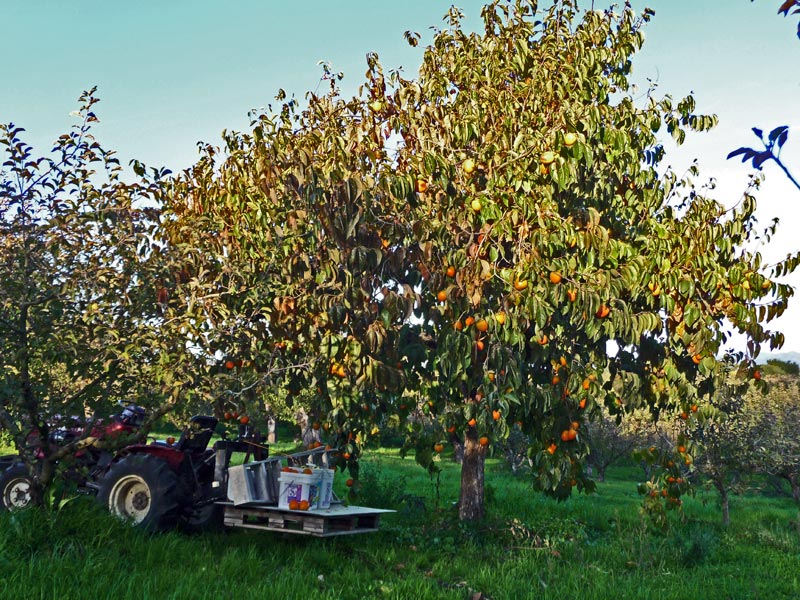

I won't have anything heavy on the 3-point to test maximum capacity, for another couple of months. Off-season use is just carrying stuff around on the rear forks and pallet-platform. Examples:
November, picking a family Persimmon tree down in the back of the orchard.

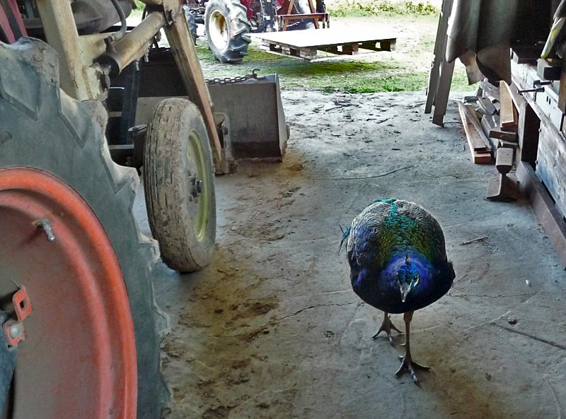

And just for fun. The first picture I found, looking for something showing that rear platform. This little guy showed up August 2009 and never left. He must be an abandoned pet, he has no fear and begs to be let in the guest cabin at bedtime. No way!!!
