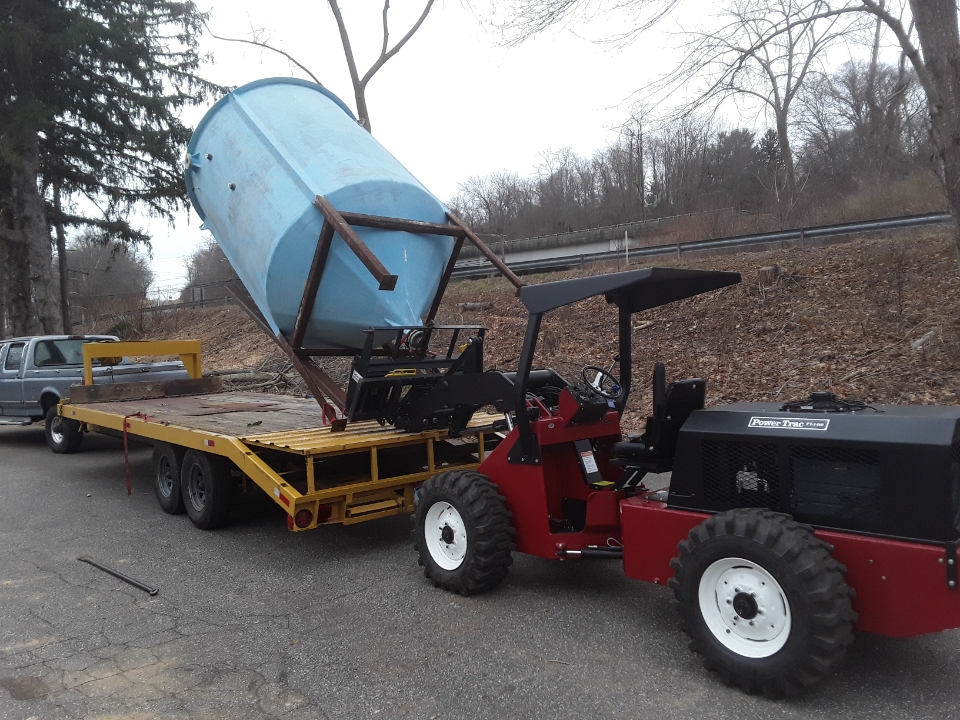

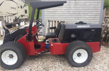

Sometimes I wonder if everyone gets a different story. If you look at the specs the 1460 is 3" wider and the engine, which is the heaviest part, I was told sits lower. Those to facts usually add up to greater side stability.
I always had a hard time telling which tractor I was looking at, until after they said to me the engine sits lower and has a lower hood on the 1460. Look how the hood is below the seat back in the PT group picture of the left 2 tractors, then the 1460 pic and 1445 pic.
I would think both tractors are stable, maybe the 1445 is a little better, but that does not make up for 12"- 600lb lower/less lift.
