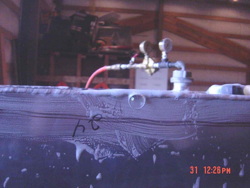

Should also note when using a plasma to cut aluminum that is going to be welded. You should cut the material big, (at least 1/16 inch) and grind to the correct measurements.
Go ahead and ask me how I know. :eek:
That was a bad day wasn't it?
   / $1500 budget what to buy ? #35
That was the first aluminum project with the Dynasty. I was having a little trouble with contamination but just wrote it off as bad aluminum that I got from the scrap yard. I posted a question about it on a welding forum, that is when I learned when using a plasma to cut the material big, and grind / sand to the dimensions you want. $3,000.00 for a plasma cutter when a $150.00 skilsaw would have worked better.:eek:

I have customers occastionally that try to cut and weld aluminum, with very little edge prep. Then they call frustrated. A lot of time, I find out later that it was cut with a plasma...which makes for some challenging conversation trying to figure out the issue. A customer or two have tried to send a unit back because of it.
