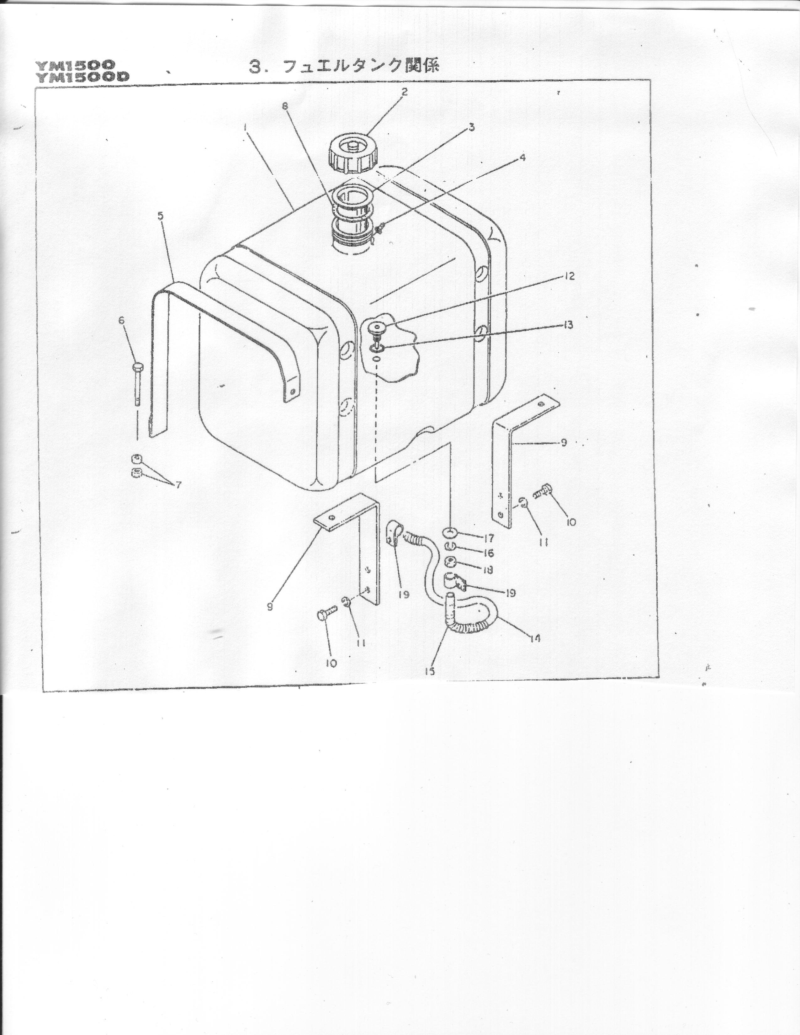

Can You post a pic of it ? also what it attaches to . My little 1300 just has a little tip that sticks out of the tank neck , no hose & fuel runs out when sloshing around if its more then 1/4 full .
I,ve been trying to figure out what its for & what should be connected to it as it looks like its broke off . Thanks Bob
The return line hooks to #4
Danny
   / 1500D fuel line? #12
Danny

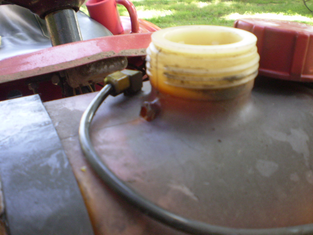

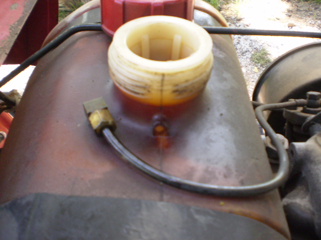

Thanks for the pic Danny . I took a couple of pics. Hopefully it will show what i,m talking about. Its right at the bottom of the fuel neck. Theres no hose running into the tank . I,m assuming the return line is the one next it . Or am I wrong ? :eek:
This just apears to be a vent , but the fuel comes out when sloshing around , thanks Bob .
   / 1500D fuel line? #13
It appears that a previous owner added the brass fittings where your return line is connected. On mine the return line goes to the hole at the bottom of the fuel neck. I would just plug that hole since your return line has been moved. I assume your filter is like mine and has the slots to allow venting when the cap is screwed down.
   / 1500D fuel line? #14
Thanks reb :D . I,ll look & see about the slots , But I beleive it does . I,ll give that a try. Thanks again, Bob
