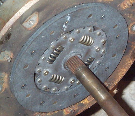

Before I put this thing back together I figured I would check with you guys to make sure I was doing it right. I must admit, I wasn't paying 100% attention when I finally got the clutch off (about 11pm). Anyway, does the raised center part of the clutch goes towards the engine like I have it, or towards the pressure plate. I think it's in there right but I wanted to check first.

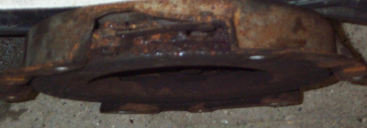

   / 1500D Transmission
#9
This is what the pressure plate looked like when I pulled it off. I think the mechanism was rusted so much it wouldn't work?

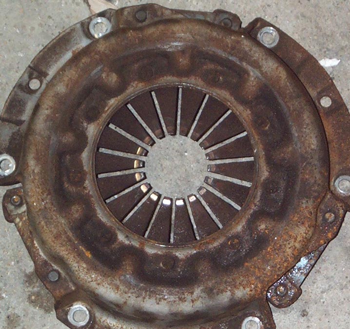

Another one of the pressure plate. Check out the wear on the fingers. Is this indicative of a failed throw out bearing?
