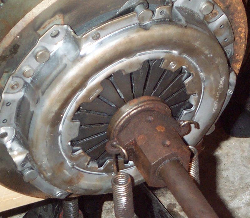

New pressure plate. I am going to have the new bearing pressed off/ on tomorrow. I'm aauming those springs attach to the clutch pedal mechanism, they were already dangling when I got the tractor split.

Sean,you need to flip disc over.The raised side goes toward pressure plate.You can use driveshaft to align disc and then tighten bolts.Those springs can be hooked and then pull bearing up over fork.Then slide driveshaft thru bearing and into coupling on trans.If coupling stayed on shaft,pull it off and put on trans because it won't go thru bearing.Sometimes the bearing will try to slip off forks when you are putting tractor back together,so keep an eye on it until shaft starts into pressure plate.Good Luck and take care.These tractors may be small,but they can still hurt you.

Success! Well putting it together anyway. I had already figured out the disc arrangement yesterday morning, but your advice on the shaft was right on! Thanks for the help. Once I got the bearing and shaft all together and lined up it went together nice and smooth. I figure the next one will take me 1/4 the time, but it was a great learning experience. I should probably have the whole tractor back together tomorrow night.
