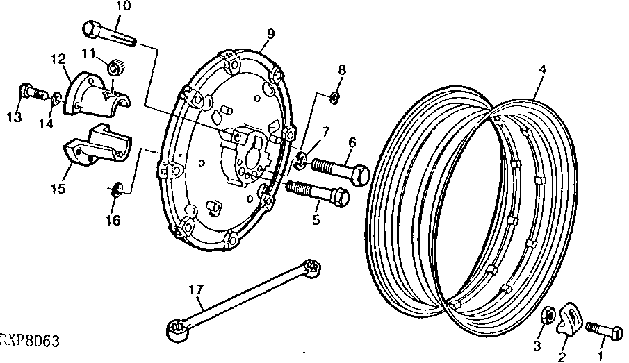

The engine was in fact built in France. Deere has an engine factory in Saran, France. The engines were then shipped to Germany to be installed in the 1530. The engine serial plate 3164DL, stands for 3 cylinder, 164 cubic inch, diesel. There were two axle configurations. The adjustable axle you have and also flanged axles were available. The rear wheels could have been 38 inch, 28, 24, or even 16.1 inch turfs.

thanks a million, Ijust ordered a shop manual,should have done it when I got the tractor.Iwill try to get the kit from the dealer tomorrow.
Im a little confused on the tractor being a 1530, the engine ID plate says made in France,I thought the 1530 was made in Germany I cant seem to reference the numbers anywhere, type-3164DL-13 SERIES- 198005CD, the tractor serial number is covered up by the loader frame.
also it has 38 inch wheels ,thought it was supposed to have 28s and has 2 7/8 adjustable axles, Iguess I need to get a little better educated on these tractors it has 1530 decals on the hood . In any case Ido like the tractor althuogh I have only had it a short time, it is much more than the yanmar that I have and handles the loader just fine starts right up every time.

38" rear wheels with rack & pinion axles was an option on 1530's. This parts schematic is from a 1530 parts catalog
