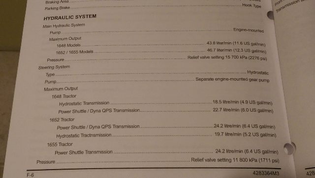

This is from my tractor manual (not loader manual). Actually has total system pressure at 2276. My loader manual states 2500 (but I'm thinking that's just the number they list for the posted specs, and not necessarily where the pressure should be set.
There is no other PSI rating listed in the manual besides steering (1711), so it must be right.
Agreed, but that has nothing to do with the relief setting on your hydrostatic transmission. You need to look in your workshop manual for these settings and port measuring locations. This will not be found in any makers owners manual.. As it is not something for owners to either measure or adjust.

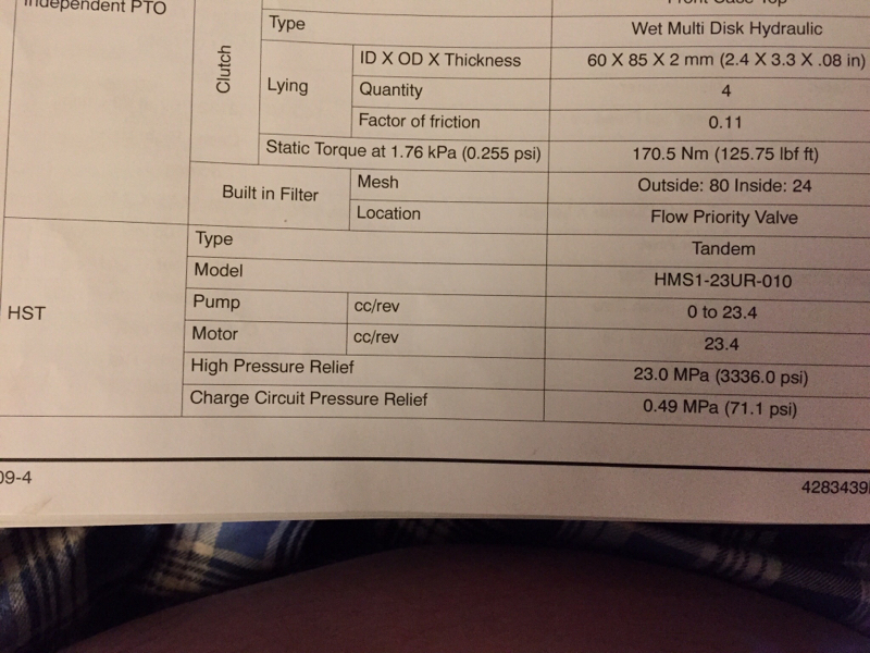

I sure wish I was smart and understood all of this stuff. But looking in my manual for a 1526. I found this. Not for sure where a pressure check port would be. Not. A super lot of detail in my mechanics manual.
There you go George, you hydrostatic transmission pressure relief is set for 3336 PSI. This has nothing to do with the pressure relief setting for the implement pump. that pump is the little pump up on the side of the engine. The hydrostatic transmission pump is one of the two main components of a hydrostatic tramsmission. One being the pump and the other being the motor. The pump is driven by the engine.
