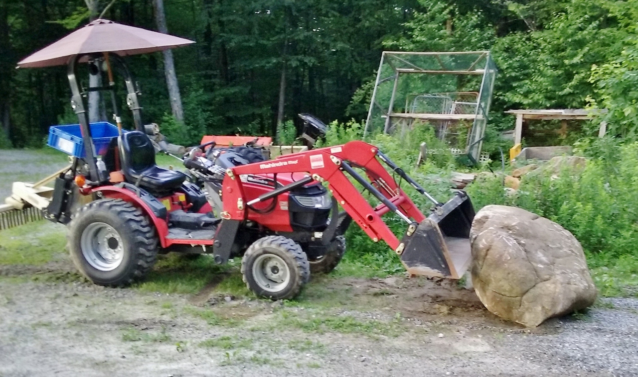

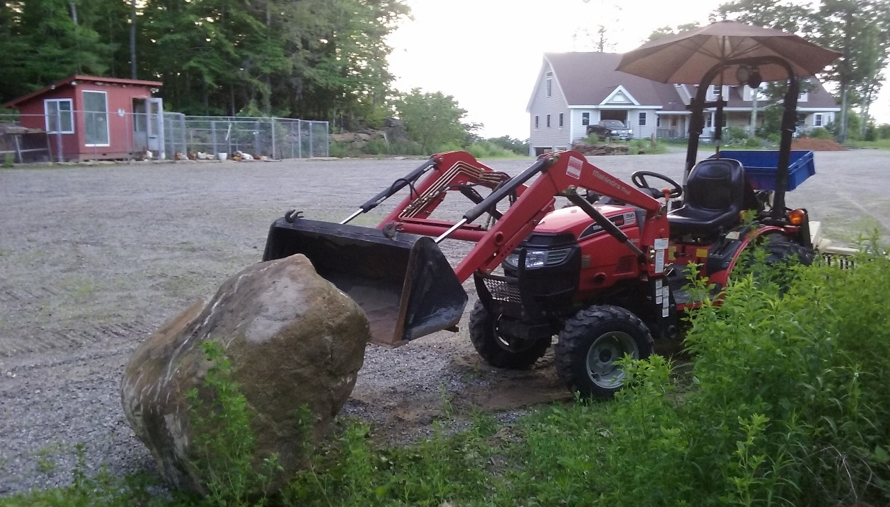

Getting back to tractors, just for fun, I tried to see what the Max could do with the rock I moved with the L39 last night. http://www.tractorbynet.com/forums/projects/374740-my-wife-wants-gazebo-help-7.html#post4802034
Well to my surprise the Max was able to roll over a near 3,000 Lb Rock.

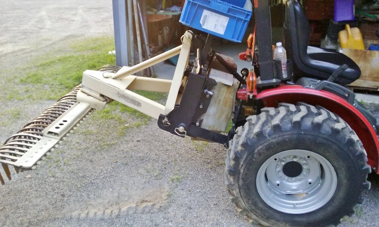

I did not use the 4WD front assist, as not to overload the front bevel gears. The lift cylinder would stall trying to lift and roll it over. The relief valve has a washer set to 2,300 psi, about 5% over maximum spec, so I figure I have around 1,500 lbs lift @ full height at the pins, still not enough to roll the Rock. The curl is stronger, so I was able to lift using the curl and push forward to roll it over. Try that with your B-Series Kubota! Well maybe a B26 could? Having an steel filled 700Lb counterweight helps, but the rear end nearly was off the ground. The Max28 is a Mighty Mouse of a tractor, and way easier to use with implements than the L39.
