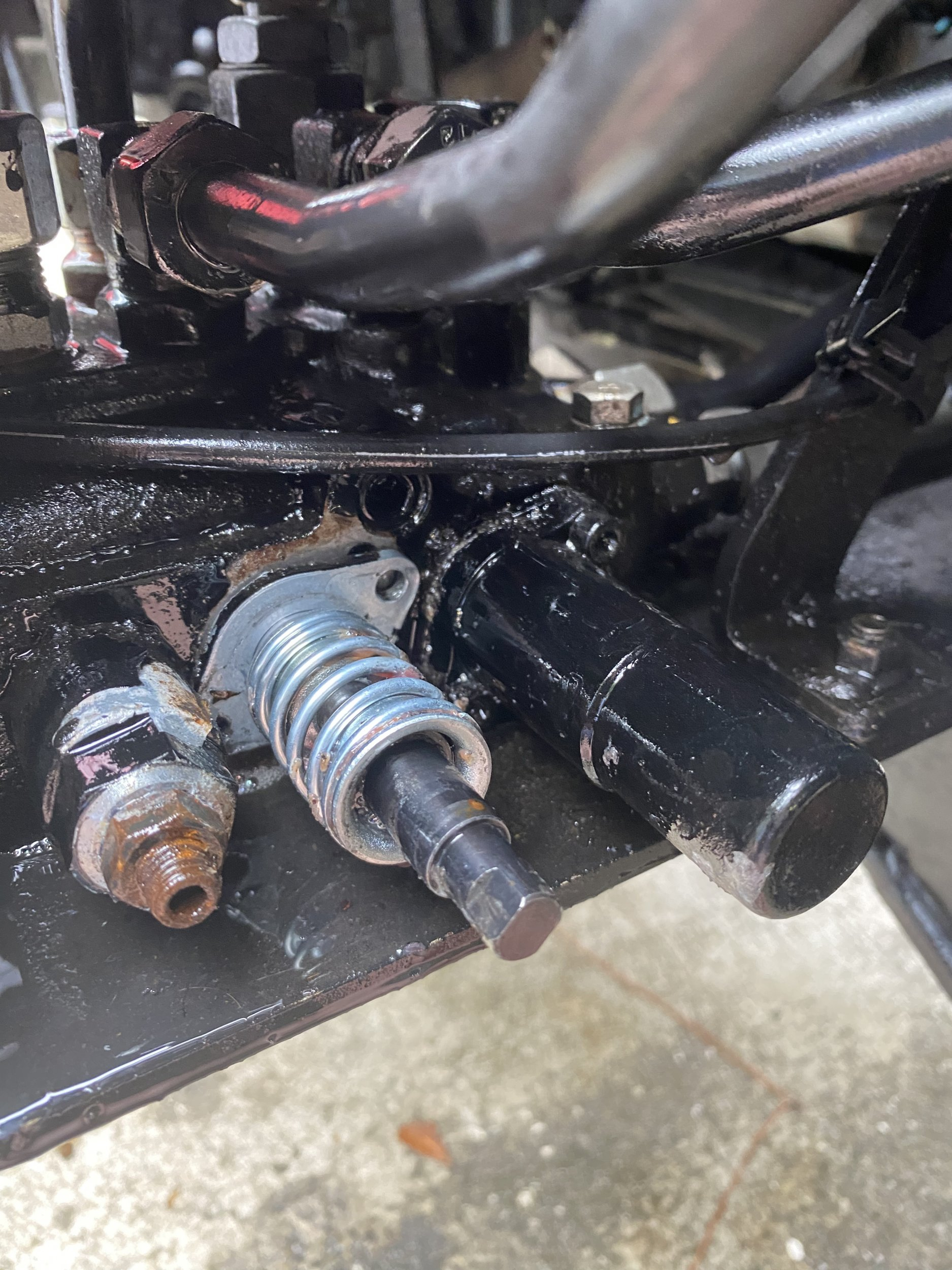

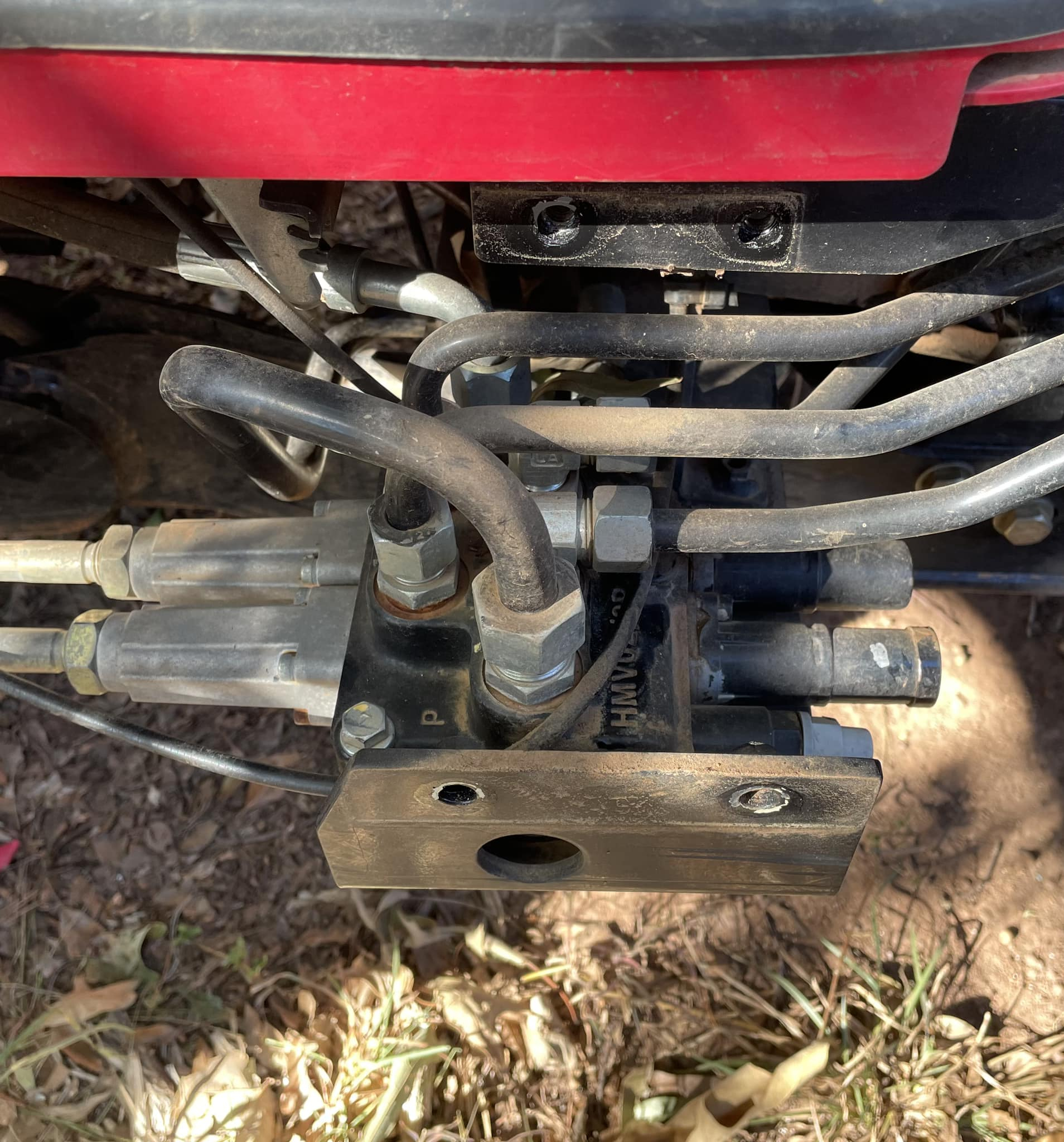

Loader control valve apparently got water in it at some point. Internal valve ceased and I damaged one of the covers trying to get it out. I either need a breakdown of parts for the factory control valve or an entirely new valve. Any suggestions on where to find a replacement? The aftermarket units that I see online have the lever mounted on the valve. But the 1533 has the valve mounted underneath on the frame and cables going to the lever.
I'm not sure what is my best option so I'm looking for some direction.
Thanks for any help!

I presume the aluminum covers on the left are the cable operator connections. Finding a valve with the exact same cable connection style might be a challenge. Do you have the mechanical capabilities of fabricating a different cable mount for a new valve?
/ 1533 Help! Need Loader Control Valve Replacement #3
Ours has had several different valves over the years. I can say, never the same kind twice.
/ 1533 Help! Need Loader Control Valve Replacement #4
Check out this site. I had to replace my valve assembly, and they were very helpful....and affordable compared to the dealer and other sources I looked at.

Are you sure one of the spools is seized and not just one of the cables?

I see new valves online that are affordable that come with the lever, cables and mounting hardware. But I'm not sure what actual valve to buy. I assume there are different types, pressures, etc.

as apparently these are only available as part of the assembly, but the manufacturer couldn’t bother to thread lock them…

I had the same problem from water intrusion and it was confined to the tilt cable. After a couple attempts to half fix it, I took the whole assembly from the stick to the valve body apart and removed the sticking cable. Lightly clamped in a vice, I worked the cable up and down while shooting half a can of Deep Creep down the cable until satisfied the problem was gone. While the cable assembly was off, I checked the valve body and found no problem there. It has been fine for 6 months since.
