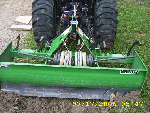

No such thing as a dumb question when it comes to me and tractors! But yes, they're as far down as they will go. They're the slotted/notched type, with two positions. Getting longer ones might be an easier option than getting a different toplink.
First pic shows the max. tilt I can get and the rippers at their max depth.

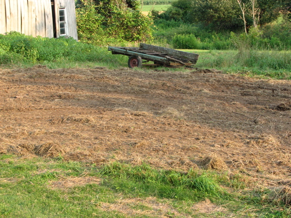

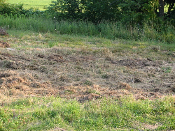

Second pic is a "before" and the third is "after". So it did kinda sorta work, but not very efficiently at all. I probably spent two hours or more on this spot that's about 400 sq ft...

Saw your picture. Your box blade angle is fine. You need to add weight to the box blade.

Have you considered useing a tiller prior to dragging the box? Your tilt looks the same as mine and I don't have any problems. The ground does how ever seem to be very dry and grassy. The other option besides weight is to wet the ground or wait for rain as previously stated. Try a gravel driveway and I think you will find your angle might be to tilted.
