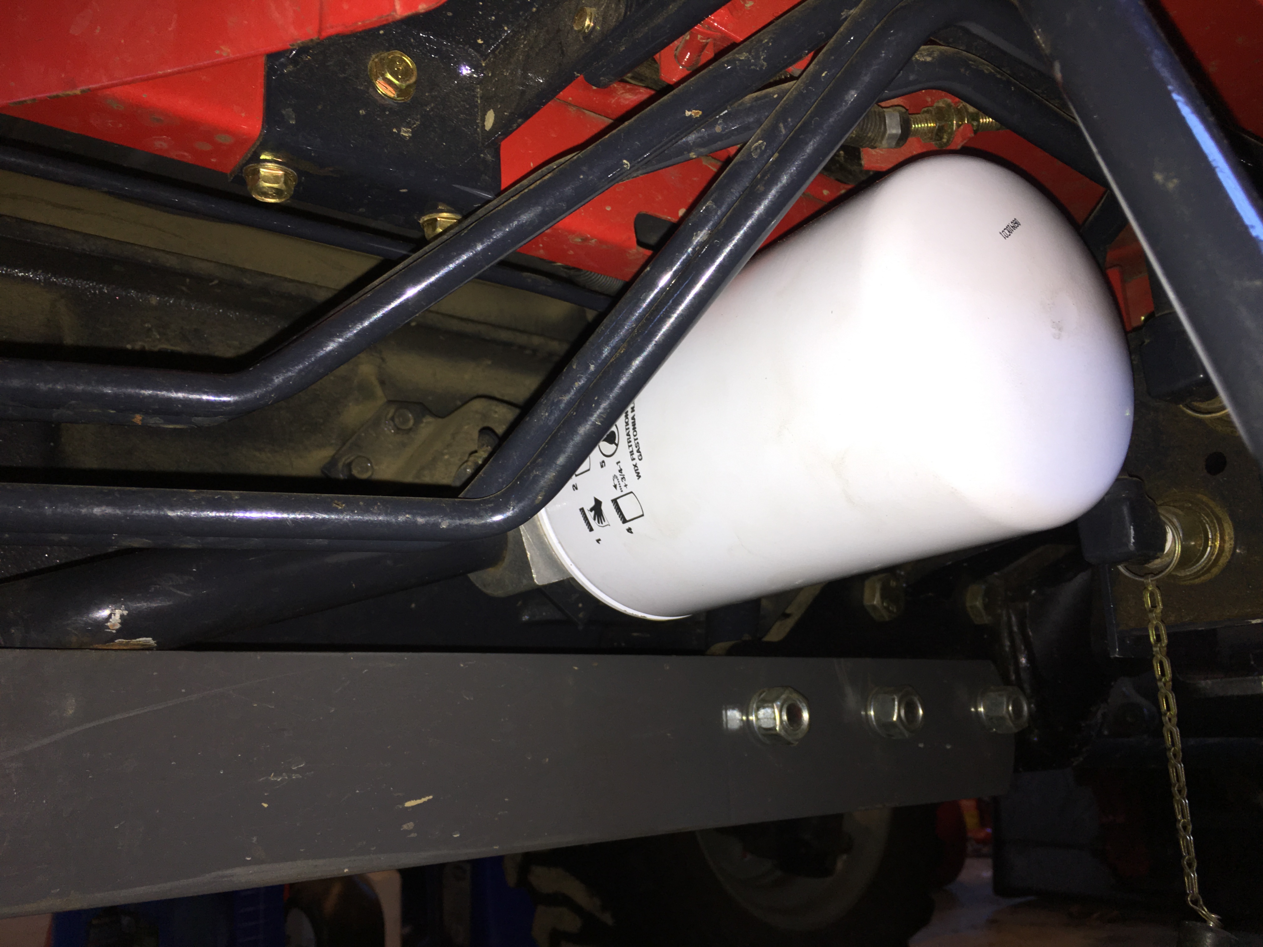

It is a hydraulic , suction side filter, so there is NO releif valve.
I used a WIX filter. Not cheap.
For those of you who know nothing of filters , you probably will sleep better if you simply seek out the grey paint OEM filter manufactured by who knows who.
For those looking for an alternative ...this is it.

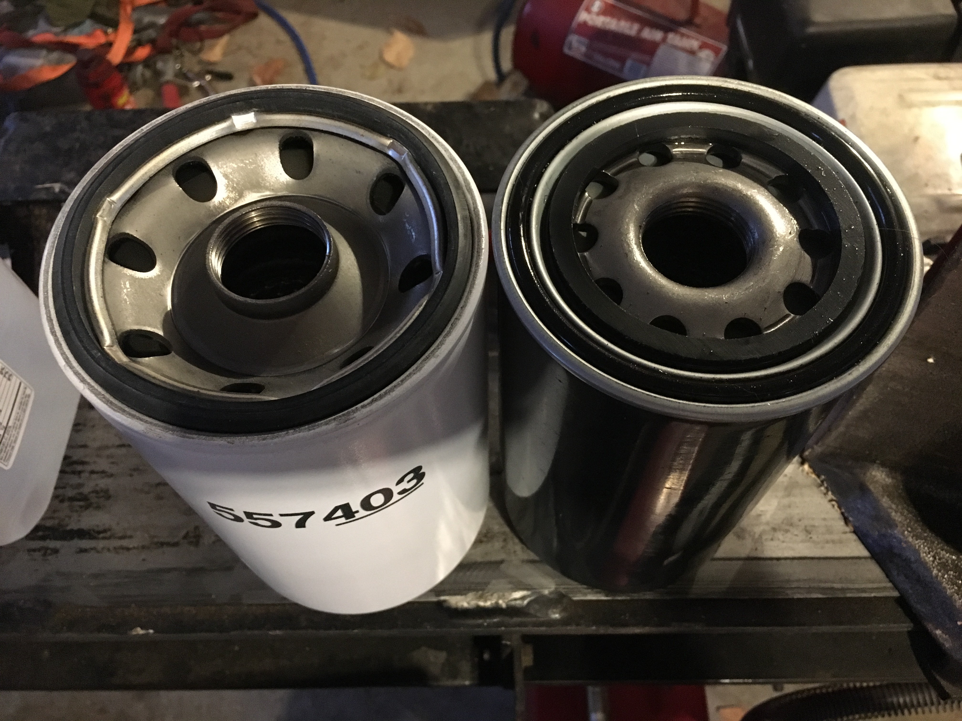

Wix 57403 vs stock.
   / 1540 hydraulic filter #17
The stock filter has a ring magnet. The Wix does not
