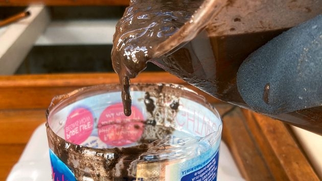

What is sludge anyway?
Diesel sludge looks like this, almost like poo.
Even with fuel filters in bowls or spin on can get the sludge.
