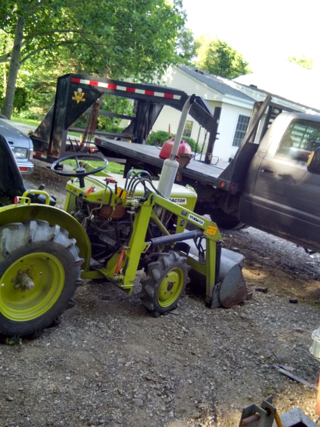

New member here. Just got a sweet deal on a 155d with 280 hours on it and was a 1 owner. Runs good but the throttle response is slow. Any thoughts?
Yes, my YM165 (nearly identical) tractor did the same thing one spring. The fix was to replace the fuel filter element. It didn't look clogged or dirty, but something must have changed because when I changed the element it responded to the throttle like new again.
Pay attention to that coolant. 50% antifreeze is max for a thermosiphon system. It's all in the owner's manual.
As far as I know, there are no NPT fluid fittings on the basic Yanmar engine and dashboard gauge setup. Some people have reported that they found some tapered connections that were using the Metric tapered pipe spec, but that wasn't the case in mine. All my OEM fittings that used a tapered thread were BPT (British Pipe Thread), just as all of the straight thread bolted connections were Metric spec.
However, Yanmar sourced the loader from Canada back when we bought the YM165D new. All of the loader connections were a fine and mysterious blend of metric, US, and NPT.

I think that iF the fuel had growth in it. Like mold or algae, you may not be able to see it, but that microscopic growth may be so fine that it's clogging the filter yet you can't see it like if it were a bunch of black gunk.
