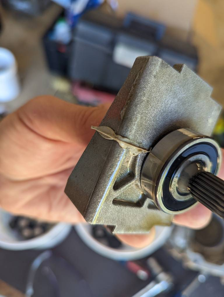

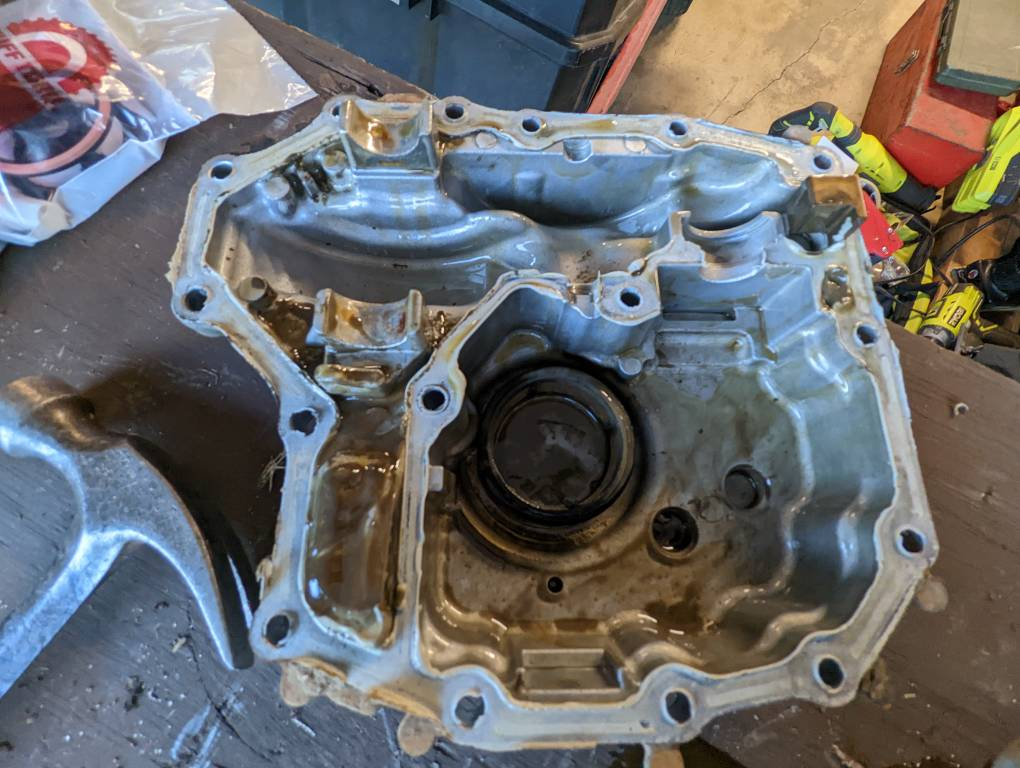

Everything inside looks great other than a very clogged filter and a bit of brown mayonnaise sludge.
I'm curious about the rtv sealing around this swash plate, not sure why it's there at all.

Watch this video from "Taryl Fixes All". Skip to ~3:00 to get past the needless anticks. He goes into a lot of whys and whatnots.

I pulled everything out, cleaned it really well, replaced the axle seals and the oil & vent caps and the filter... put it all back together with oil, reinstalled on the lawn tractor.
It all works now, goes forward & backward (correctly) with no complaint and less noise than before.
Messy job but easy. $75 for seals/filter/oil kit (the oil is a "specially formulated" 5w-50 synthetic); price it separately and the kit comes out ahead.
In the pics you can see the milky "oil"/mayonnaise. Pretty sure water got in via the cracks on the oil cap, though it couldn't've been a lot because that's under the seat & fuel tank, not really easy for water to get there, but if a drop landed there it could definitely seep in.

I'm pretty sure that this transmission wasn't working because of a terribly clogged filter; it was covered in a thick goo, probably from water incursion from the cracked cap. All of the gears looked really good (it pretty much looked brand new inside, I'm impressed); the magnets had a modicum of fines on them but not a ton.
The fact that after the servicing it moves forwards and backwards readily without complaint, when previously it barely moved at all, gives me confidence that the servicing was successful.
