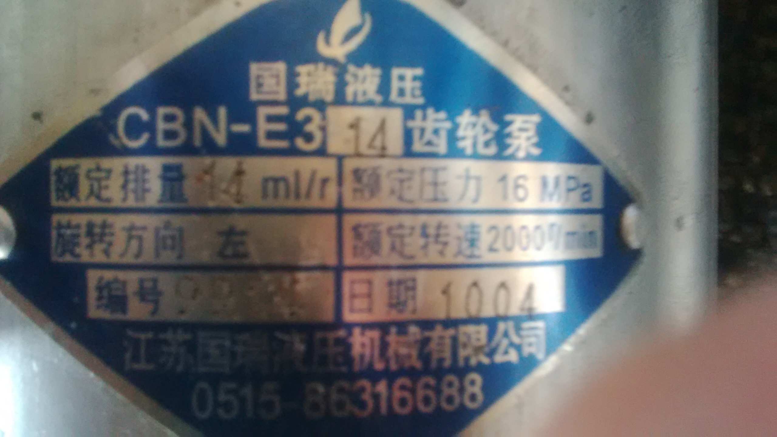

Thank you all very much for the help... current pump I have is a CBN-E17 pump spec.jpg see label picture attached, I ordered a new pump but it would be nice to find close match from this local site Search results for 'hydraulic gera pump' | Princess Auto because I have family that own a machine shop in New Brunswick that would be able to make a matching flange and shaft.
/ 16 MPA = how many GPM ? #10
Thank you all very much for the help... current pump I have is a CBN-E17View attachment 424230 see label picture attached, I ordered a new pump but it would be nice to find close match from this local site Search results for 'hydraulic gera pump' | Princess Auto because I have family that own a machine shop in New Brunswick that would be able to make a matching flange and shaft.
Good morning Acadian, the pump flow is 14ml/rev (14ml = .0036984 US gallon or .003079 IMP gallon)) and is rated for 2000 RPM so your pump is 7.39 usg or 6.15 IMP gallon at a max of 2000 RPM at a max PSI of 2320.. what shop is that in NB... Jim
