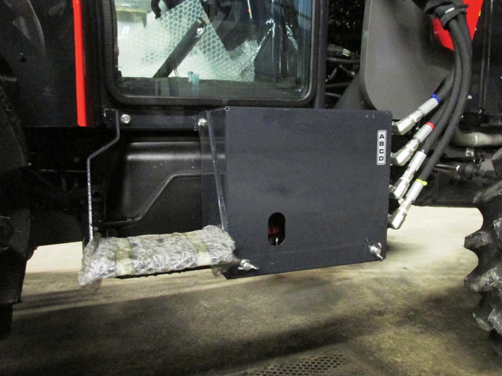

New Ground Level Fueling with Skid Plate Protection Under the tank.

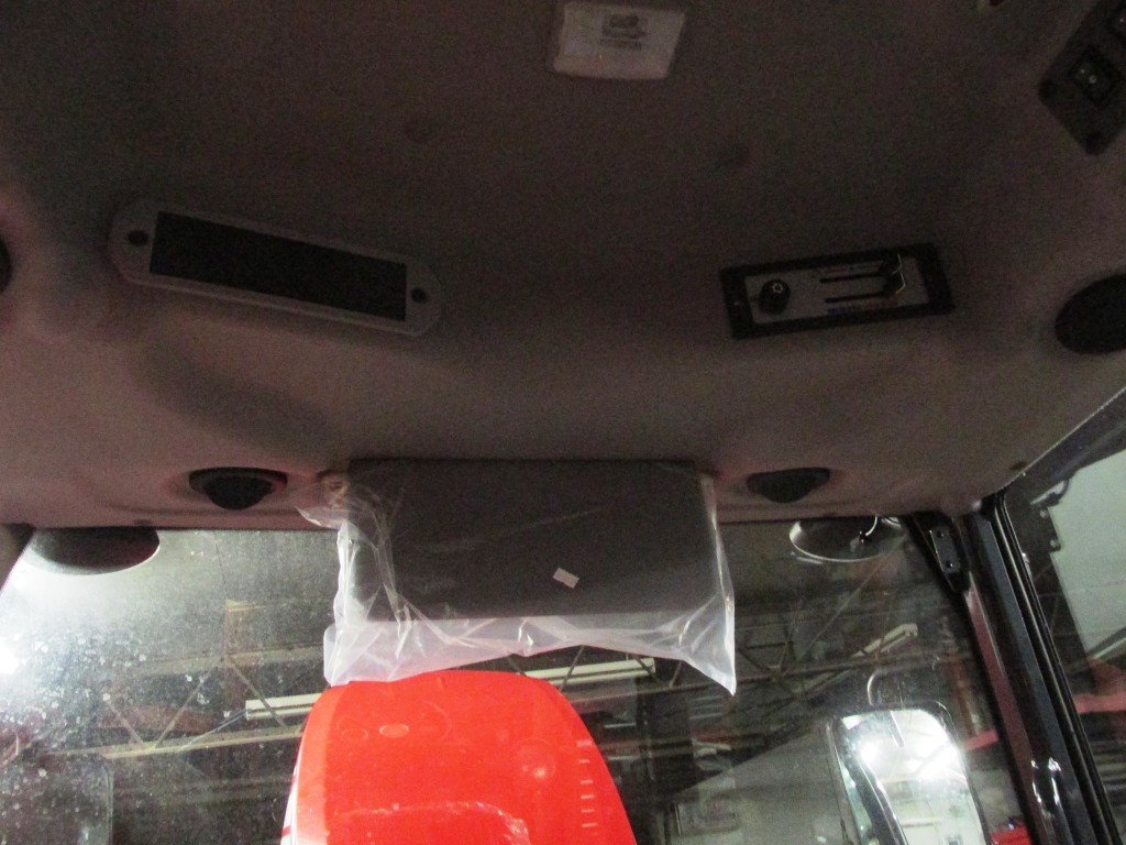

New Headliner. More head room. Sun Visor, New HVAC Vents that are spaced more around the cab and easier to direct air where operator wants air.

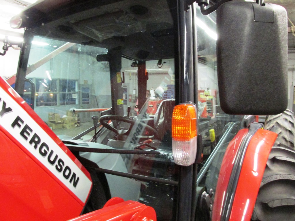

New Hazard Lights on Front of Cab.

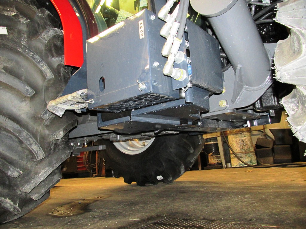

Remote Fuel Filter and Water Separator and New Location for Mid Mount Hydraulic connections
Right Side of the Engine

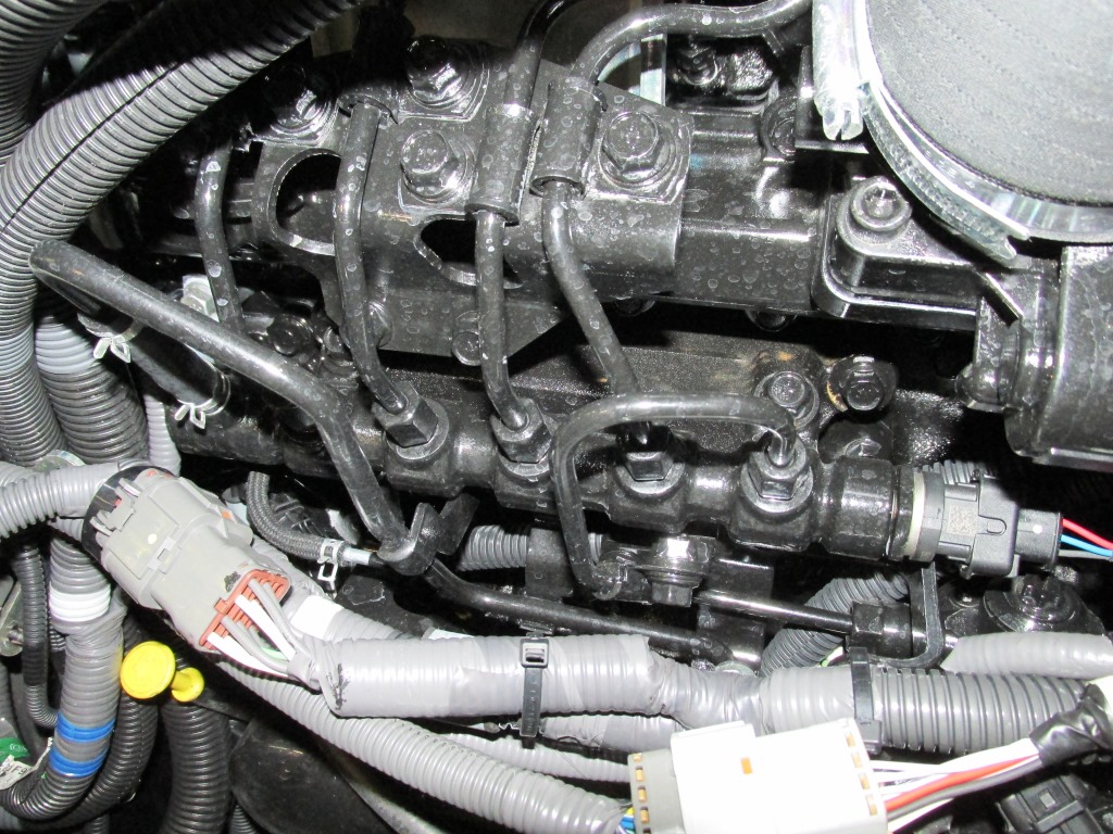

High Pressure Common Rail Fuel Delivery System
New Exhaust System exits Right Side and Very Quiet

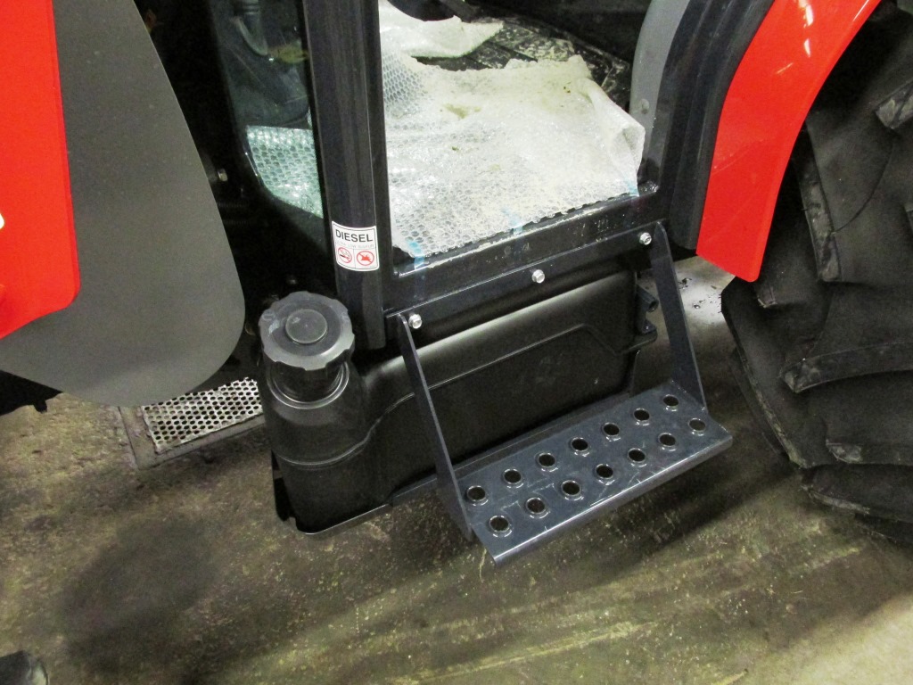

Right side step and fuel tank
Right Side view of Skid Plate under Fuel Tank
Right Side Cab Entry and Controls.
New HVAC System mounted on rear of Cab to increase head room and ease of service.
Here is some images from new 1759 we just got today. I'm going to try to shoot a video tomorrow showcasing the features. I can tell you this the 1759 is the quietest running engine of ant compact I've heard. Very impressed.
   / 1600 series tractors #30
Nice pics, thanks for posting.
Interior looks identical with a few exceptions, air ride seat, what looks to be a sunvisor up front etc. Position of controls remains unchanged which is nice, I like how my cab is laid out. Will be interested to hear whether the seat is transferrable to the 1660, should bolt right up by the look of it.
Position and types of lighting outside is nice. Mine comes standard with signal lights, 4 way flashers, front and rear lighting, headlights with high beam and low beam but no running lights on the rear fenders (rear lenses look like they could be wired for some) or brake lights, I do think it should be standard equipment on a tractor this size. I like the flashers up high, although a different shape they remain high on the rear posts which is good.
