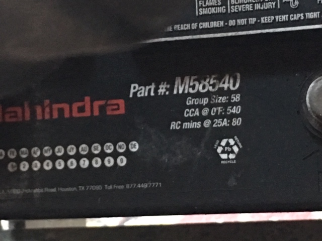

I have a 1626 with a leaking battery. Its still functioning but I'd like to replace it before it A: makes a mess and B. inevitably dies when I need to use the tractor.
I'm assuming I don't need to purchase a Mahindra battery, so my question is: Is there a better aftermarket alternative? If so, any recommendations?

Thanks again for the responses. Great discussion. For those who went the sealed/optima route, any suggestions on the right model? There doesn’t appear to be a like-for-like replacement for the model I have.
/ 1626 Battery Leaking #13
From the photo of mine it looks like a group 34. The part number is 34/78-980.

/ 1626 Battery Leaking #20
I am in the process of converting over my 1526 from a BCI Group 58 over to a Group 34 AGM battery. The only thing that does not fit is the battery holder angle bracket. Other than that there are no problems at all. My positive clamp was corroded hard and took the galvanized plating right off. Looked like big mushroom of some sort. I cleaned that all off with baking soda and warm water and repainted the tray. The original leaking battery was made by EXIDE something like a 60 month, El Cheapo thingy.
