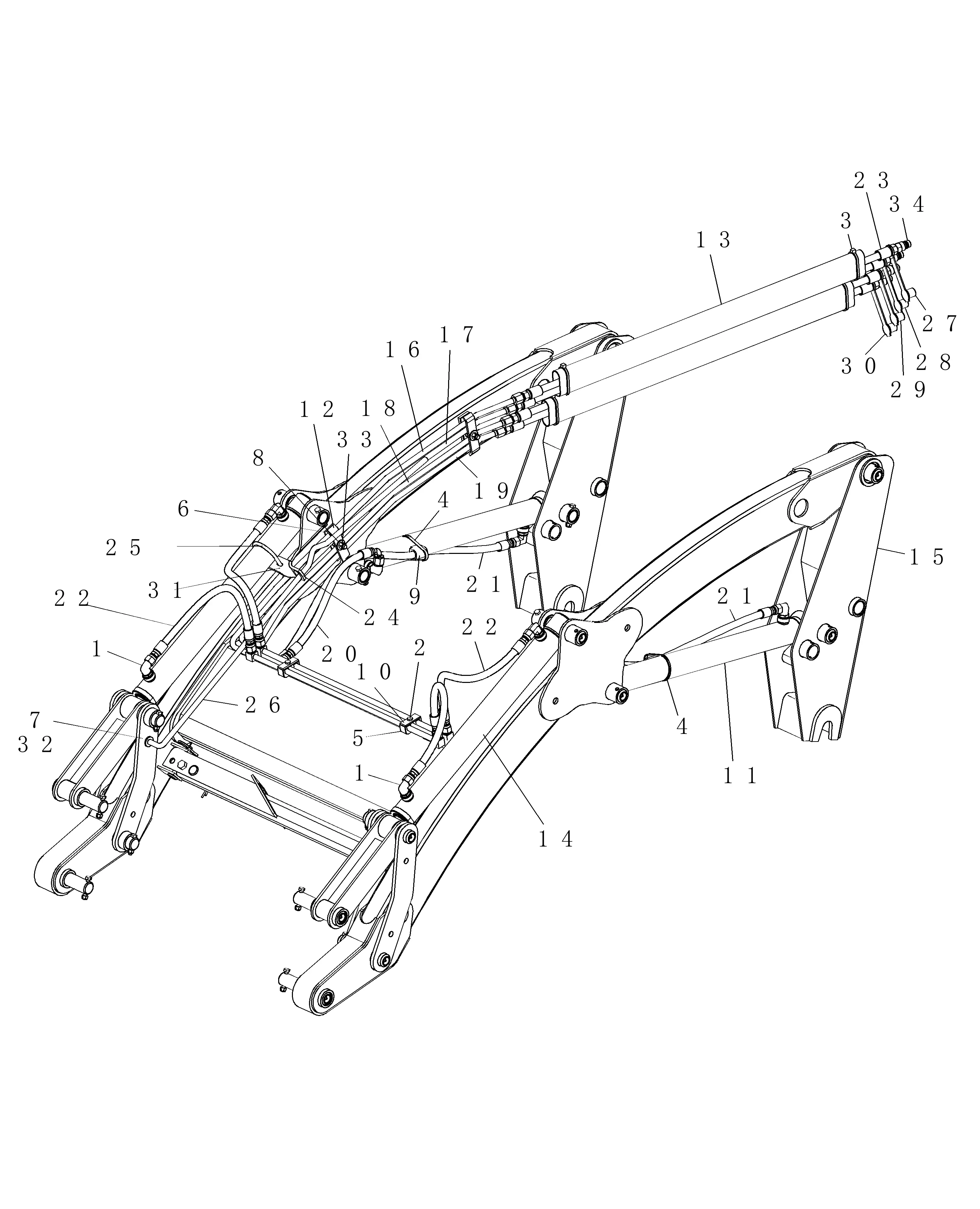

back again here with a new issue today with my deluxe control handle for the loader. it seemed to be sticking at some point today and after moving it around a little in different directions i felt something pop. Now the loader will rotate the bucket but the arms themselves with not go down or up. i looked and it seems there at least 3 little ball joints at the base of the handle that controls the hydraulic actuators and it looks like a pin that connects through one those ball joints has sheered off and there is no pin though the hole of that ball joint anymore. at first glance i could see anything that looked like a "bolt" that went through the other 2 ball joints that still are good. it looked more just like a pin of sorts.
anyone had anything like this before? i don't see anything listed on the NH parts diagram New Holland 16LA - NH FARM LOADER(12/99 - 06/06) Parts DiagramsNew Holland 16LA - NH FARM LOADER(12/99 - 06/06) Parts Diagrams

Welcome back to your 24 year old post :). You were almost there in the parts book, one page off. Look at #29, 30 and 34. All but perhaps #34 can be had through McMaster Carr or Grainger. Or just Google Heim Joints.

ok looking at the parts diagram my issue was that part 34 came out of ball joint 29. there's 2 of these on mine that don't have a nut on the end of the shaft that goes through the ball joint. The ball joint 29 and the screw #27 was very tight with thread locker on it so it took a good bit of torque to free it up. once i got it off i had to free up the ball joint with lots of grease and moving around. the shaft on 34 was a little corroded so i took an emery cloth and got most of the rust off. so just by taking off that one part i was able to work the ball joint back onto the shaft and thread #27 back in and tighten everything up and i was back in business.

i got that ball joint slid back on the shaft but after looking at the parts #30 is what looks like slid off and by looking at the picture of the part it looks like they are machined to not let that ball slide over the end of the shaft, and it would appear that my part#30 has worn to the place where the ball joint slides all the way off the shaft way to easily.
i see that part #34 has a much longer shaft than 30 has on both #30 parts.
My next question is how to get the plastic cover off that part of the tractor to be able to work on these pieces. there are 3 13mm bolts i've take off and i can move the plastic up a little but it gets stuck on the rod part #39 sticking through the plastic. looks like there's a little clip holding that rod and spring in but i can't get to them.
