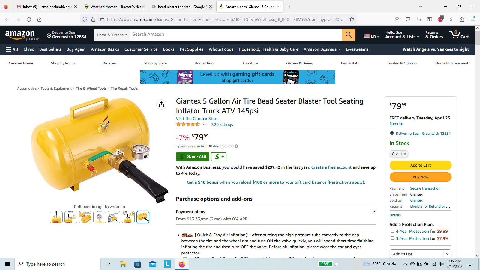

I fought with tires for years, little ones on lawn mowers to large tractor tires. Then I broke down and bought one of these 5-6 years ago kicked myself in the butt for not buying it many years ago. Some years it may only get used once but it gets borrowed a couple of times a year.
It's only a 5 gallon unit but it works on little tires and UTV tires and it helps a bunch even on 20.8-42's which are the largest I've had to work on.

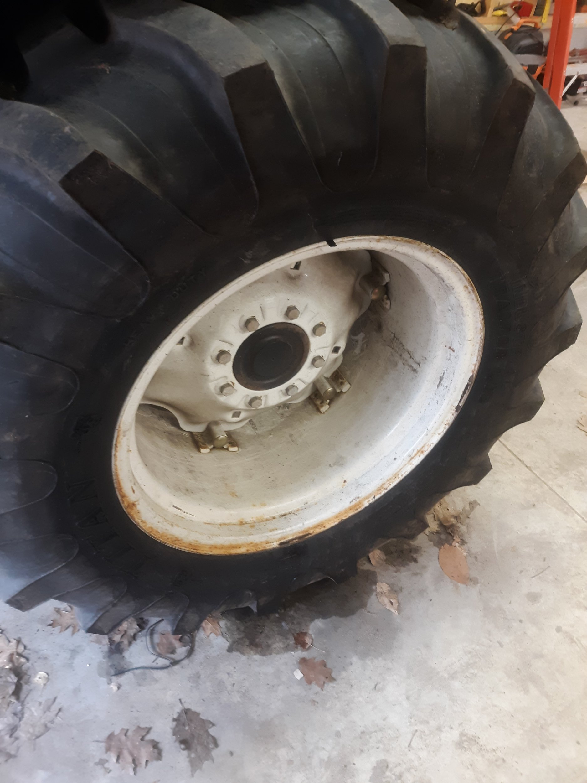

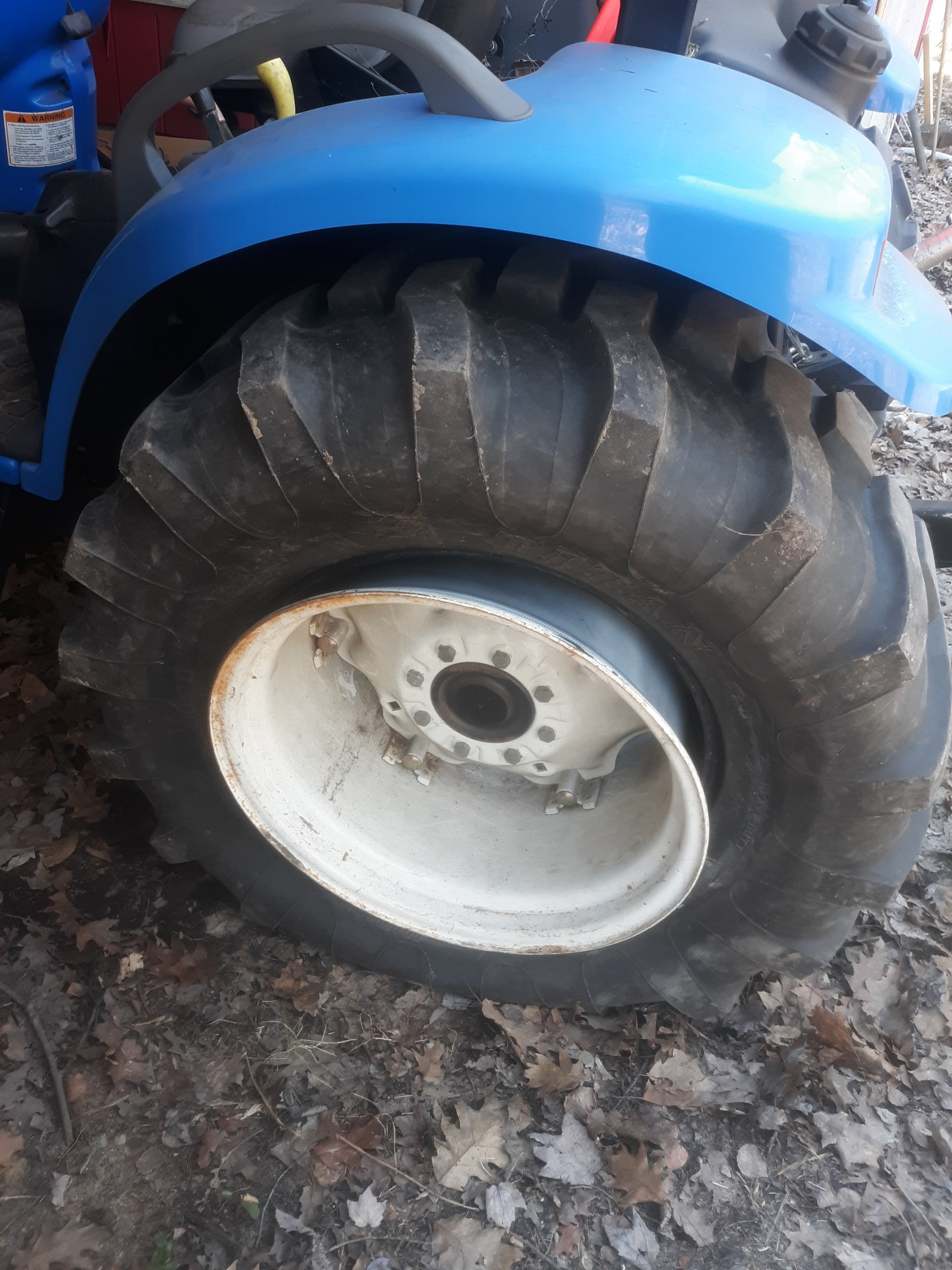

Thanks for all the replies and suggestions guys! After wrestling with transport straps, transport chain and ratchets, I said that's enough.
Wound up shooting it with ether, twice. Both beads were broken, first shot seated the inside, second the outside. As I mentioned, ether was my last resort, and it worked.
Wound up shooting it with ether, twice. Both beads were broken, first shot seated the inside, second the outside. As I mentioned, ether was my last resort, and it worked.View attachment 796544View attachment 796545
