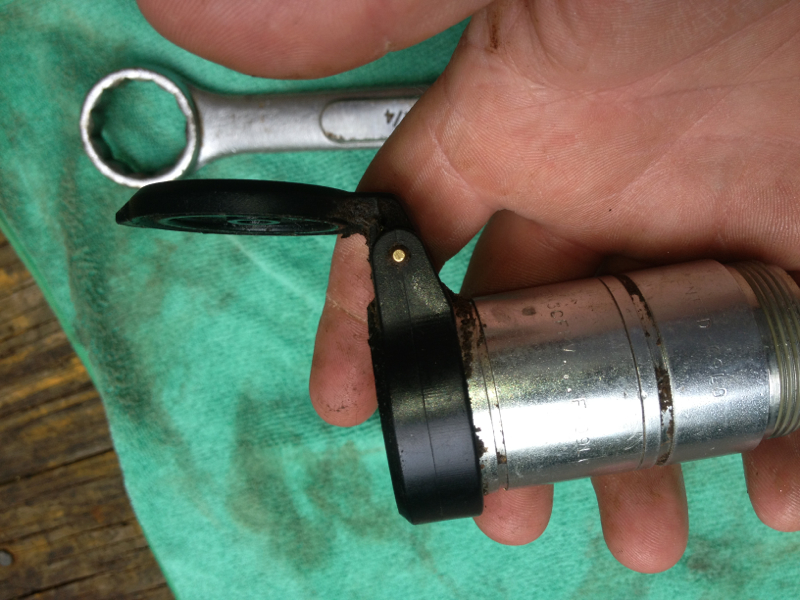

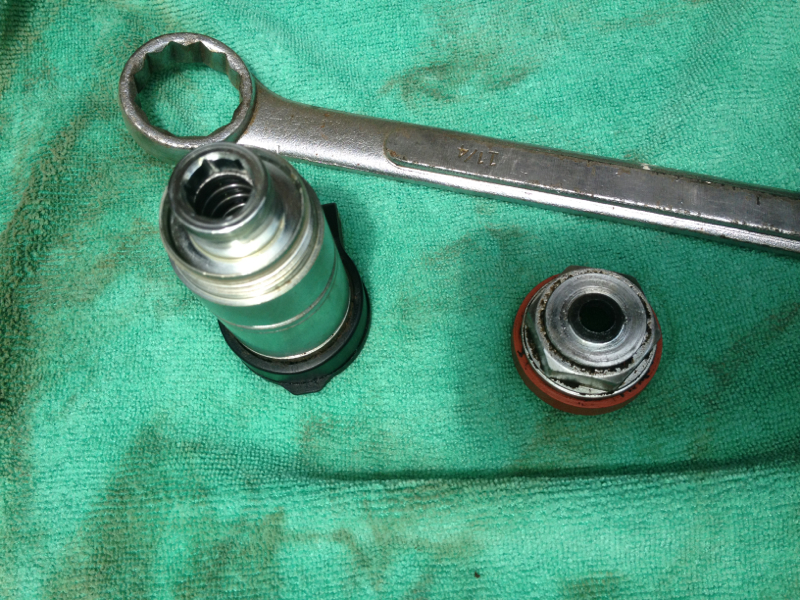

Do I understand correctly that the Kubota quick couplers are supposed to hold until a certain amount of pull is placed on them and then let go, to protect the hoses?
If pulled straight out the couplers on my M6800 release without having to move anything. Just grab the hose and pull. If they get caught and are pulled sideways or down the fitting breaks.
   / $170 mistake.
#27

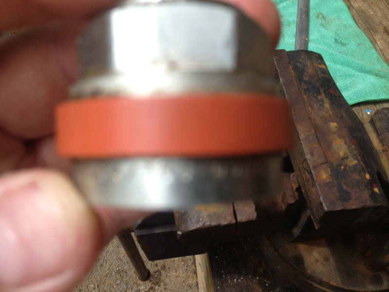

I broke one on my M6800. The coupler on it has a fitting between it & the valve. The coupler doesn't screw directly into the valve...
I just now walked by the broken fitting laying on my bench and remembered your post. I got a wrench and clamped the coupler in the vice. By God you're right, it will come apart! Now I'm thinking of having my buddy just weld it back together.
BTW... The coupler is made by FASTER, I can not find an exact match to the model numbers, listed below, anywhere online.
The larger of the two pieces has "3CFPV...F-09L0" stamped into it.
The smaller part that is actually broken has "...74/380 09N0" stamped into it.
