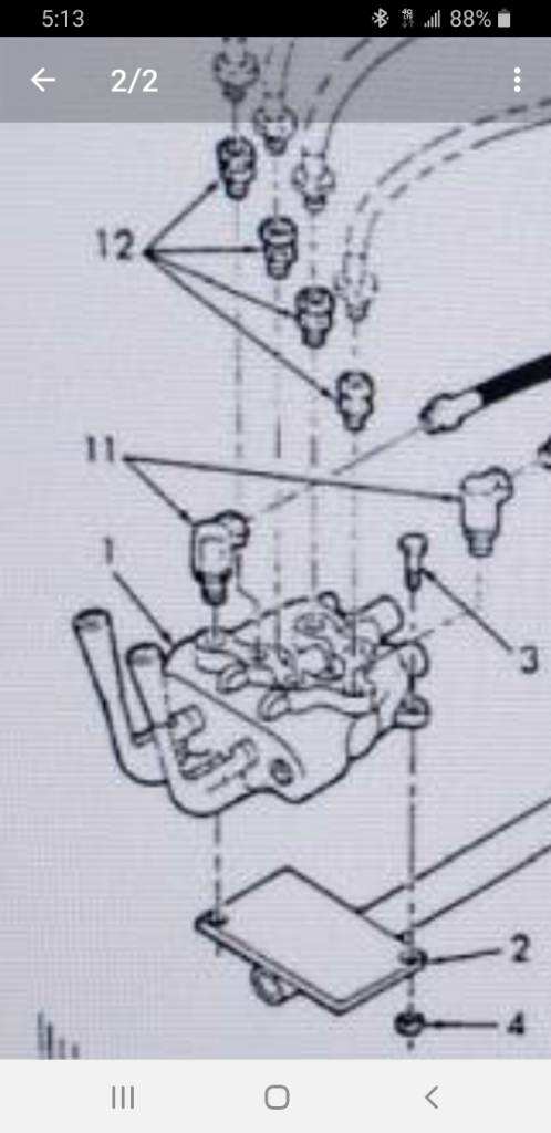

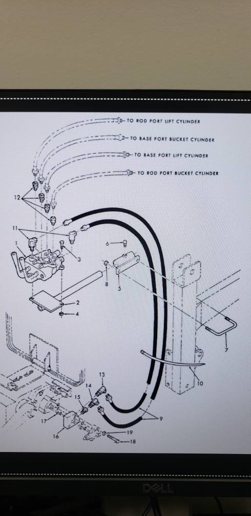

Can you post a pic of the side where you disconnected the loader?

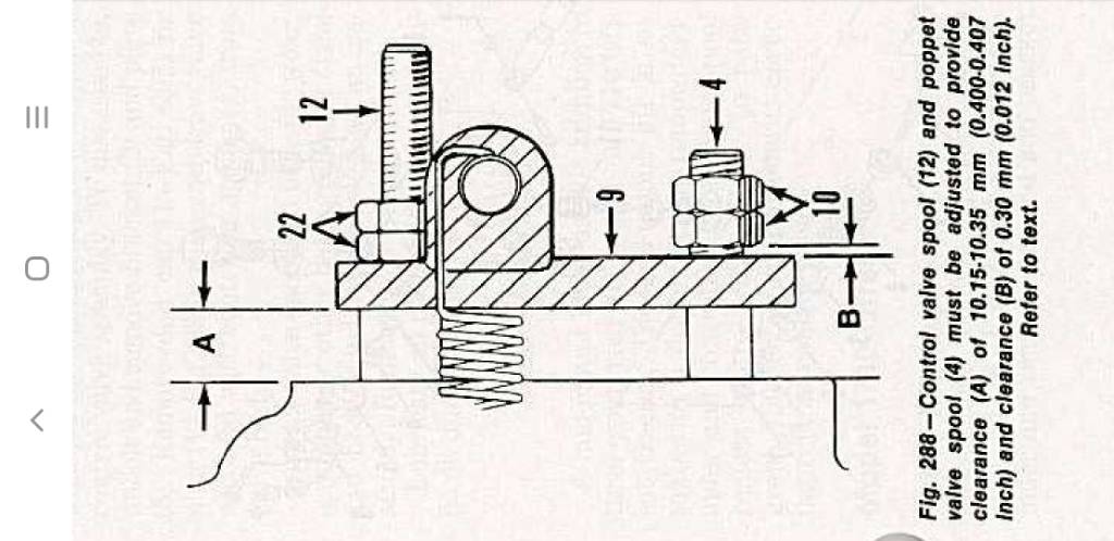

ok. I have worked on the 3 point lift valves a little bit but not in a long time. I think at this point, you probably want to pull the control valve on the side and inspect and adjust like the manual says. Not sure if that is it, but seems easy enough to do. It is possible something is bad in there, but if you say the 3 point raises and lowers, probably not.
If I had to guess, look at the oil flow on page 6. It seems in the neutral position the unload valve is what is the last restrictor the oil sees before returning to tank. On page 46 they show it. If that is stuck, it will cause it to build pressure all the time. I think this all comes out with the side control valve.

I followed the tech tips and troubleshooting information that you provided me and it was the relief valve, spring and poppet, after adjusting the control valve to specs and removing the guts from psi relief valve and running the engine the noise to go away, I found a tractor company in Colorado called FarmLand that sales used tractor parts, I purchased a used control valve 140, when i received I took it apart and found the spring 3/16 longer and the poppet in better condition. I installed and was able to adjust it immediately and alot easier than before with out the fluctuations when the fluid got hot, the loud noise is gone, there is a small noise like a purging sound it could be air, I ran it with a box blade and a rotary tiller and it ran great. Now the only issue I have is when I lift and tilt the loader to the max , I guess the stopping point I get a loud squealing sound coming from the loader side valve , do you have any trouble shooting information on that possibly? Thank you all the help that you have provided you are the Tractor Wisperer for sure, thanks again. Screenshot_20200304-202030_Drive.jpeg20200212_055119.jpeg
