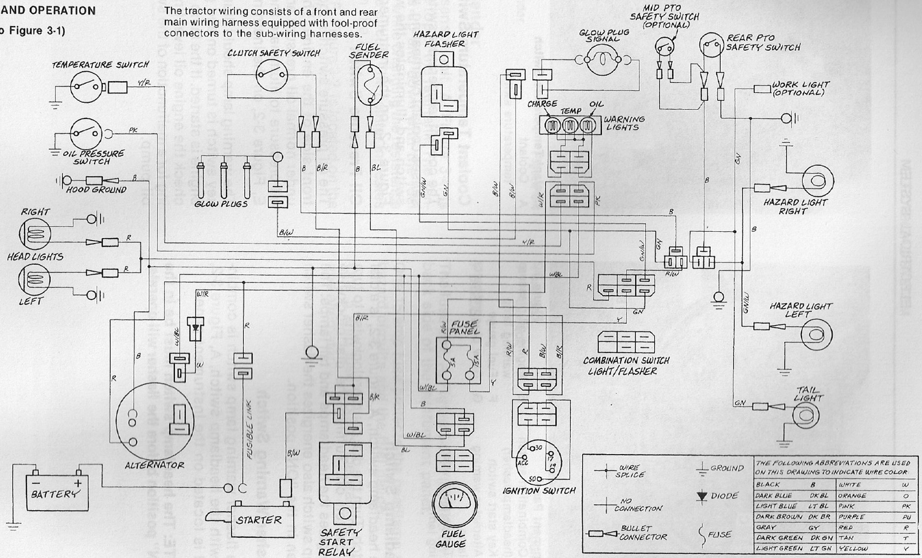

Anybody have a wing diagram of a 1715? My service manual seems to have disappeared.

Thanks, that helps. Looks like they are pretty close except for the dash. Are there any color codes for the wires in your manual?

Can anyone tell me what fuses go where on a 1715 new Holland? There is no fuse for fuel gauge or headlights and the owners manual is useless, I found there is a 15 amp and a 5 amp but which one goes where?

Here is the 1715 diagram I have ... however ... if I recall correctly my 1715 has a 15 amp and two 5 amps. Looks like the slot with the yellow wire is the 15 amp for the headlights?
Thanks
15 amp for the headlights, and 5 amp for the gauges. there's an easy way to tell which fuse does what. temporarily put the 15 amp in one of the holders, and see what works.. then put the correct fuse in when you find out what comes on..
