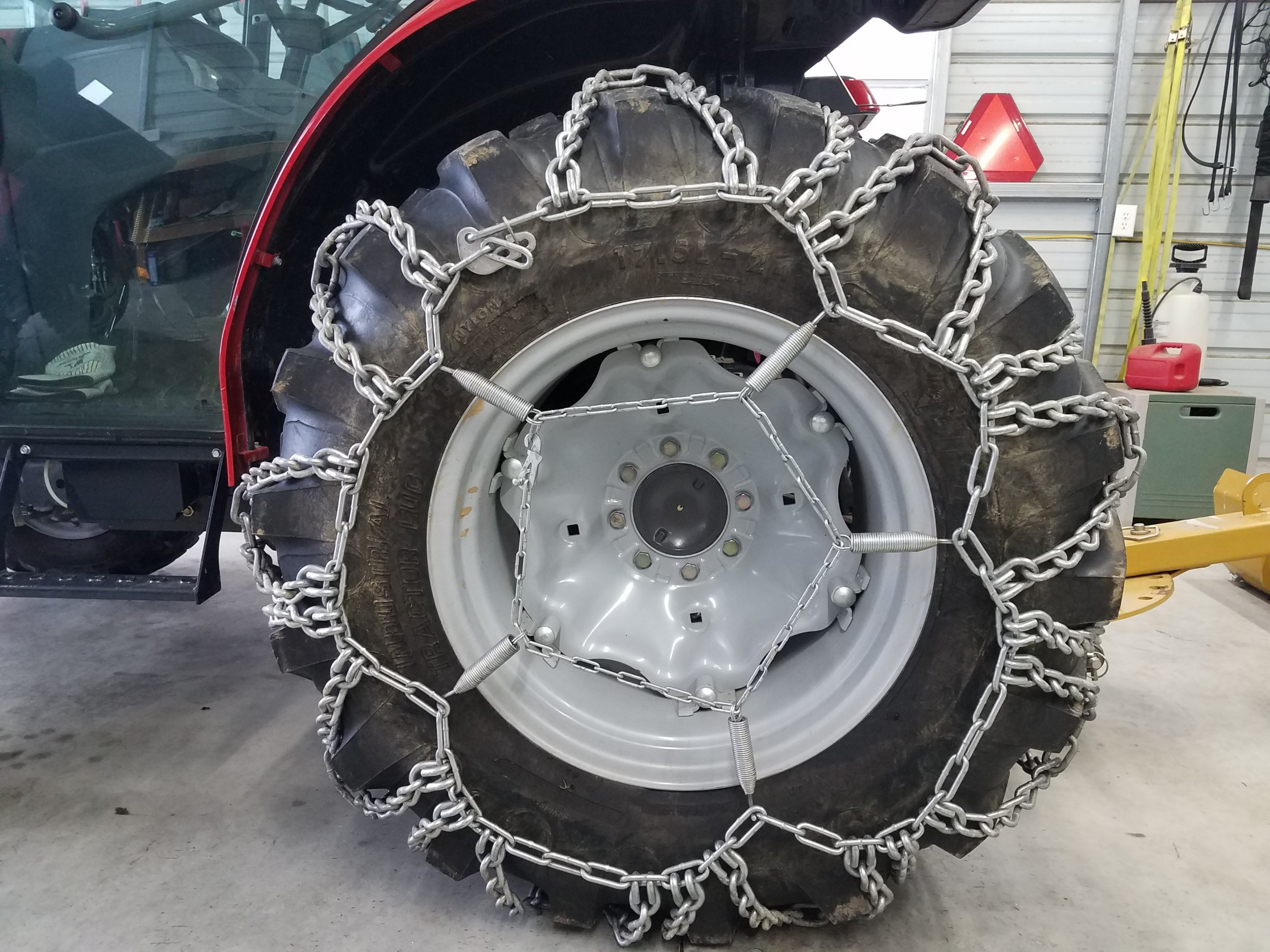

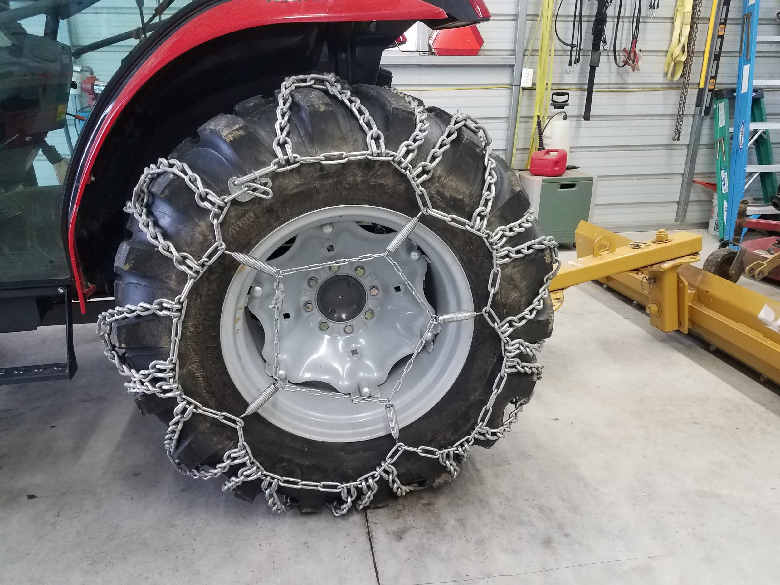

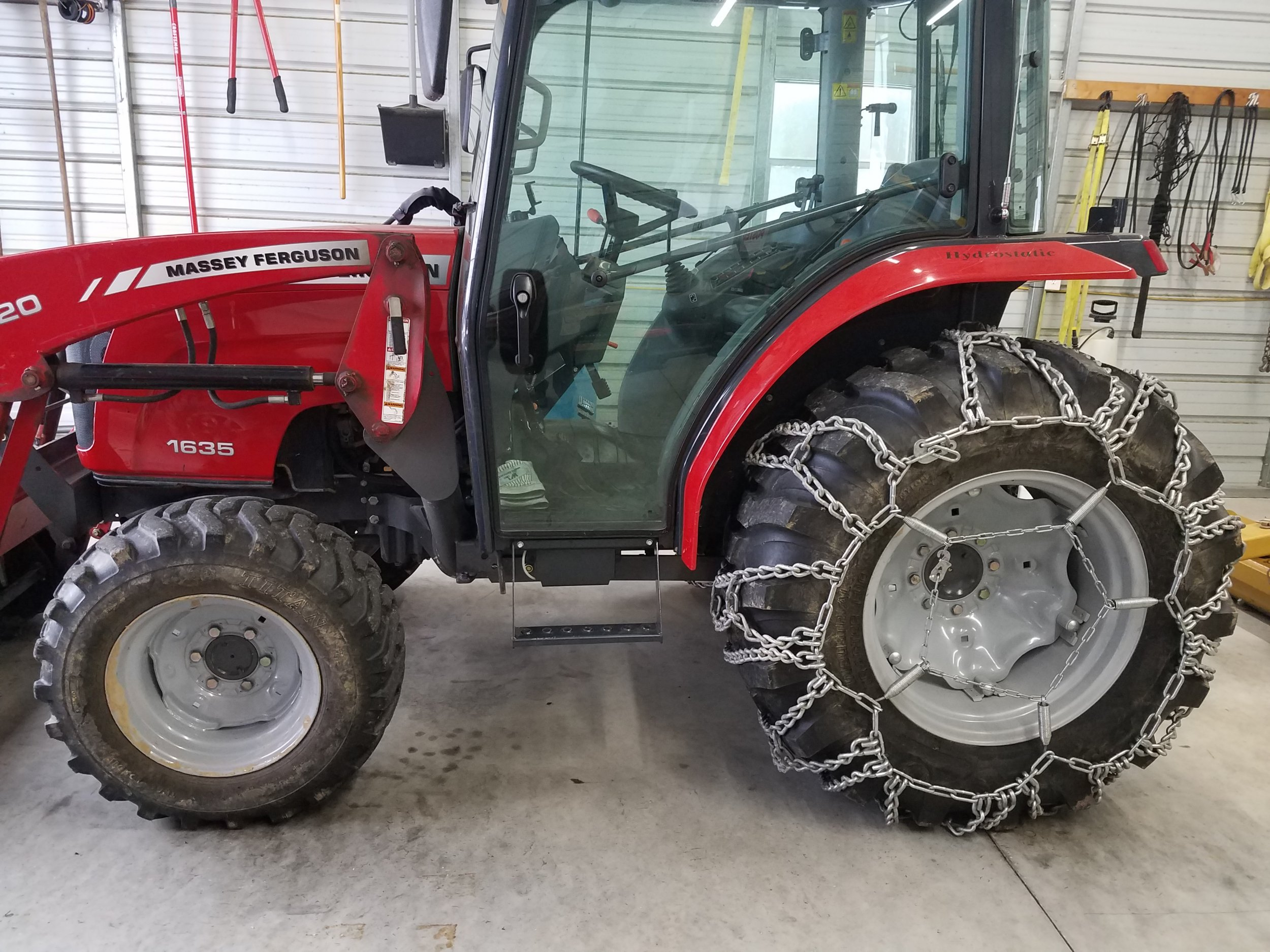

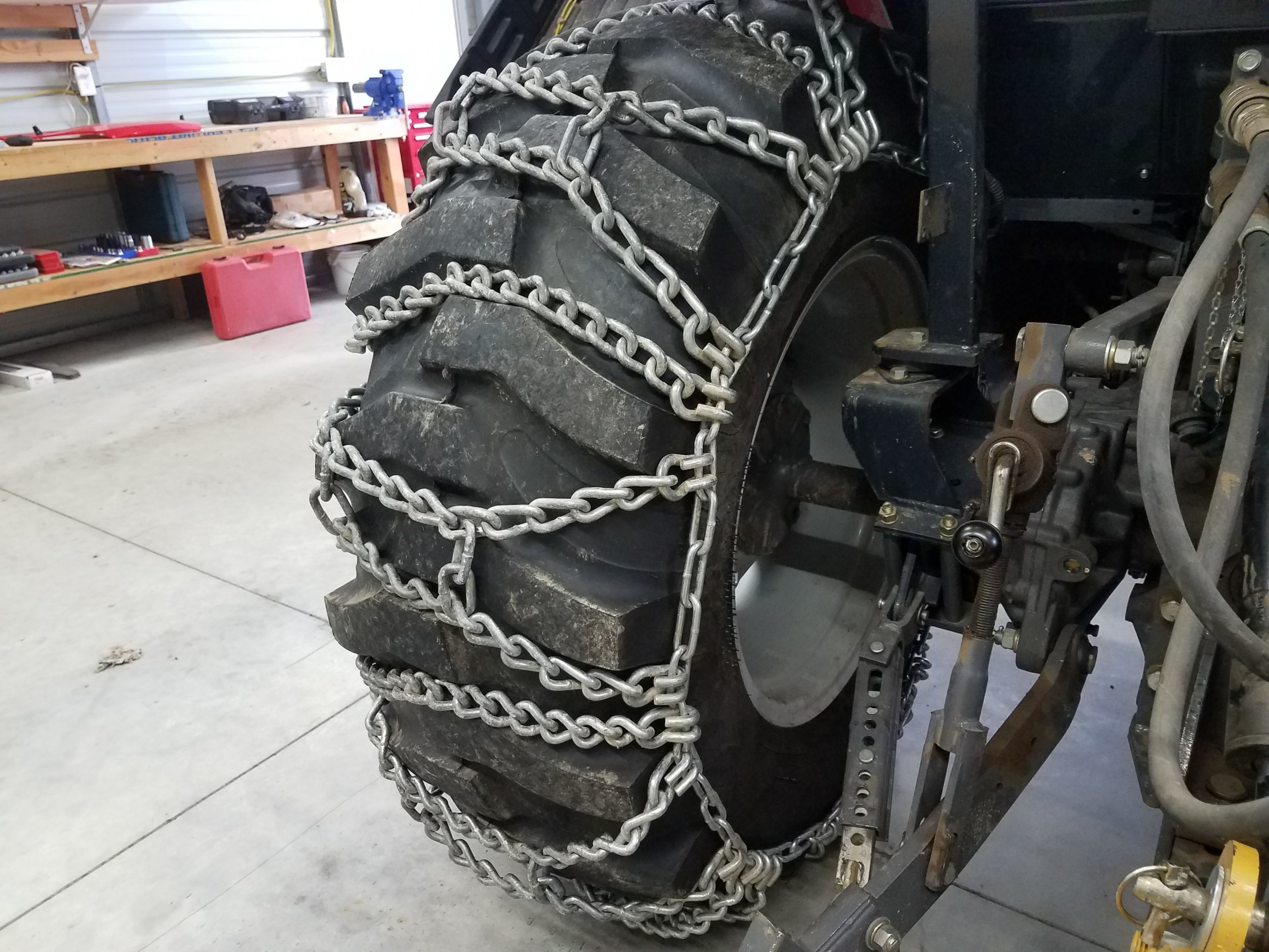

I have an older version of your tractor, a 1635, pretty much the same though. 17.5-24 tires on rear. Don't know if this will help but here's my setup.
