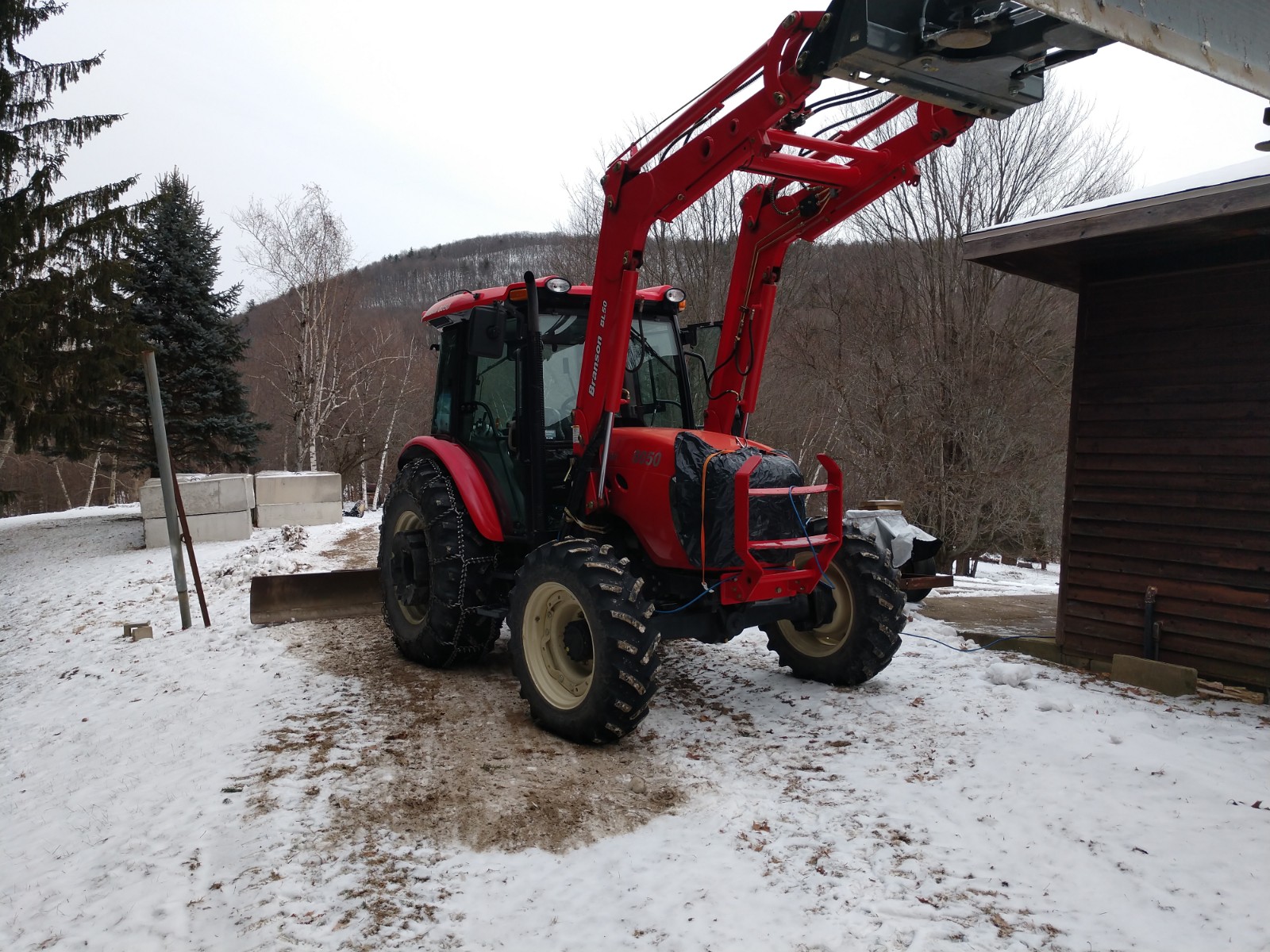

There has been some valid information presented here,
quite possibly some wet stacking and soot build up in the muffler and exhaust piping,
and a good possibility of snow or icing in the air filter.
One thing I do in the winter is cover up the air intakes on my grill, the tractor will warm up faster.
Including the hydraulics, also with a warmer ambient temperature under the hood it will lessen the
icing in the air intake and help to raise the exhaust temperature.
This picture shows my high dollar grill cover, couple of bungee cords and a large trash bag.

Thanks for all this information.
Just to give you an update I did my snow run this morning, outside temperature was much more comfortable, about -15C. This time
back to normal, no smoke at all except the usual one at startup. After doing some research about wet staking as I wasnt really sure
what it was (French speaking here) pretty sure that what it was. Especially that its seems to happen more often on new engines am I right about that ?
I will also keep note in mind about icing in the air filter element and maybe find something to put on the front grill to keep it warmer at really low temps. About your trash bag Lou it aint need to be pretty as long as it work, I'm a fan of cheap simple solution like that.
Thanks for every replies !
